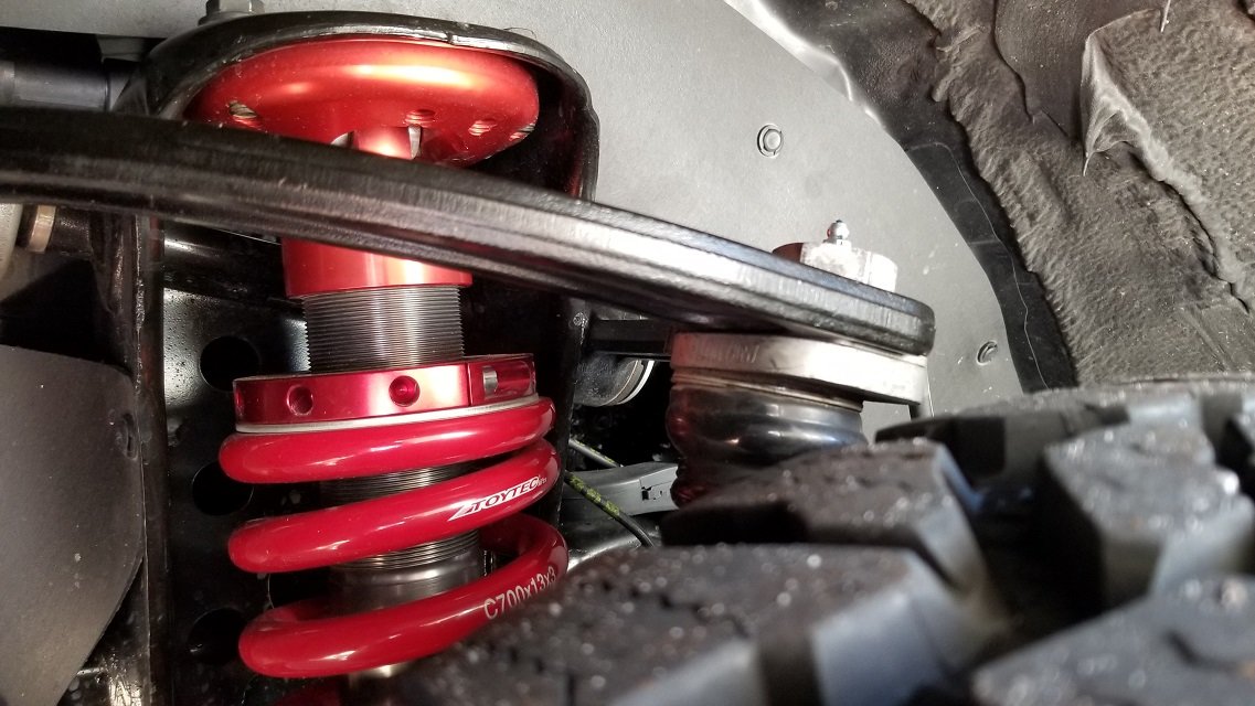

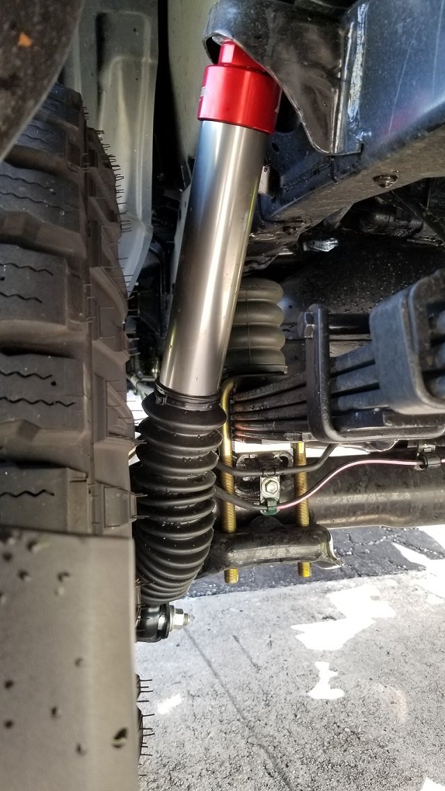

    I don't see why you couldn't mix and match. My neighbor has a 4runner with Aluma 2.0 front and 5100's in the rear b/c he was tearing up boots on the rear Toytecs. Any weight (or future plans) in the front (bumper/winch?) You may want to reverse that and go with Aluma up front and Bilstein in the rear. The Aluma spring is rated at 700# vs. 6112 600#. The biggest difference to me is the price point. I have the Aluma 2.0 front and rear and while it is a very good suspension, I think the Bilstein is just as good and for far less $$.
