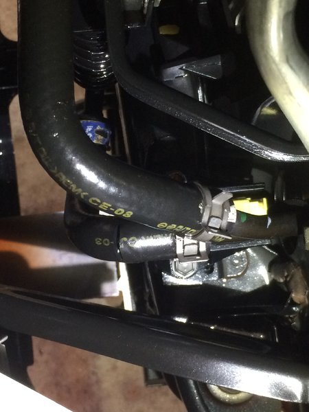

    My GF borrows my 2007 Tacoma with 99,xxx miles. Calls me on her way to work, says the truck was shifting funny and now it won't move. She's stuck in the middle of an intersection and called the police for help. I grab her car and see a huge puddle in the driveway where my Taco was parked overnight. FUCK! I show up before the cop, and try to drive it out of the intersection. Barely barely moves when i give it gas. Limp mode? Check engine light on. Fluid ALL OVER the ground below it and all over the undercarriage. Red in color. Tow truck shows up and takes it to my Toyota dealership I've used many time and trust. Service advisor calls today to say "Your transmission cooler line is cut." "Did you run over something perhaps?" I said "No!" $550 for parts and labor. We'll call you when it's fixed.
    How the FUCK does just that line get cut? Did she damage it further by driving it from the house leaking about 4 miles? Could this have to do with my frame swap a few months ago? Perhaps something got pinched or cut then and the extreme 100 degree heat this week did the rest?? BTW I'm NOT mechanical at all and I don't have any tools, so yea I"m paying someone to fix it.

    Go look at the line. It should be easy to tell if it was "cut" by a person or if it got pinched and ripped apart. Also, yea your trans prob got screwed up.

    I guess it's possible that its fine...but there is really no way to be sure without tearing it apart and looking...I'd definitely look at that hose, its very possible they could have caused the issue when they did the frame swap.

    its likely one of the softlines on the tranmission fluid cooler lines that go up to the radiator.... about 3 bucks in a double barbed fitting and 2 hose clamps to fix the hose... then refill the trans. Its likely not damaged to the point of failure. Seriously do it yourself it could save you hundreds to thousands of dollars.

    That says you dumped enough trans fluid that the trans quit functioning.
    No 'limp mode' for the trans, just dumped enough trans fluid to stop working. It's not coolant, it's trans fluid.
    Make up your mind.
    If the trans cooler line was cut as your service advisor said, that means trans fluid was what was lost. There is no coolant that goes to the transmission. There is transmission fluid that goes to a heat ex-changer in the bottom of the radiator to cool the transmission fluid. With that line cut or broken, the pump in the transmission literately pumped fluid out until the transmission was low enough it no longer had enough pressure to run.
    Now. If she stopped as soon as the weird shifting started, you *may* be ok. It's possible it's not cooked, and buttoning up what is broken and refilling will take care of it. You won't know till you try. OTOH, I have no clue what the $550 is for. Seems about double for what is described, including a 100% part markup, assuming some proprietary hard line is involved. But I'll bet it's not.
    The bad news is the clutch packs *may* be cooked, depending on exactly what transpired and how long it took to happen and how hot it got. Again, you won't know until it's buttoned up, refilled and driven.
    Get a look at the line. 'Cut' should have somewhat smooth edges, like cut with a side cutter. Vandalism style. Easy way to cost you a bundle if someone has it in for you. Like if they think the girl is theirs.
    It's not easy to tear or break such a line, but of course it can be done. If it looks more broken than cut, the positioning of where the break is in relation to the underside of the truck will give hints if it could be related to the frame replacement.
    Best of luck.
