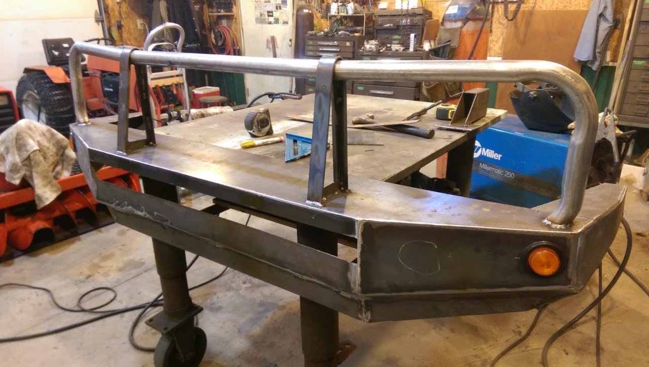

    Thought I'd start with this pic so the next ones will be more understandable.MjMkH_P8IGcf0i3EmKJ-ETn6D7o4P9t9tdaTrBO__5483df49f9eb0fa3d432997aabbf82ef02fc299e.jpg

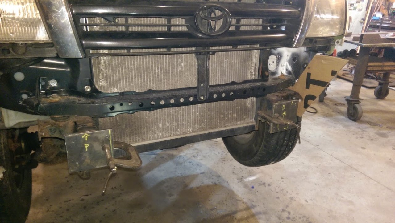

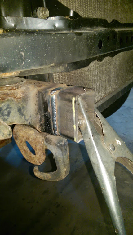

    z1lGWdv8BTnfexYCI2ORKO5ItTLWr81sYFS8mjeQ_f246591df1ab4c085798d3c6ff83178e019ef39b.jpg
    After cutting off the horn ends, I needed to extend the frame. Welded on some 2 x 3 box tube.

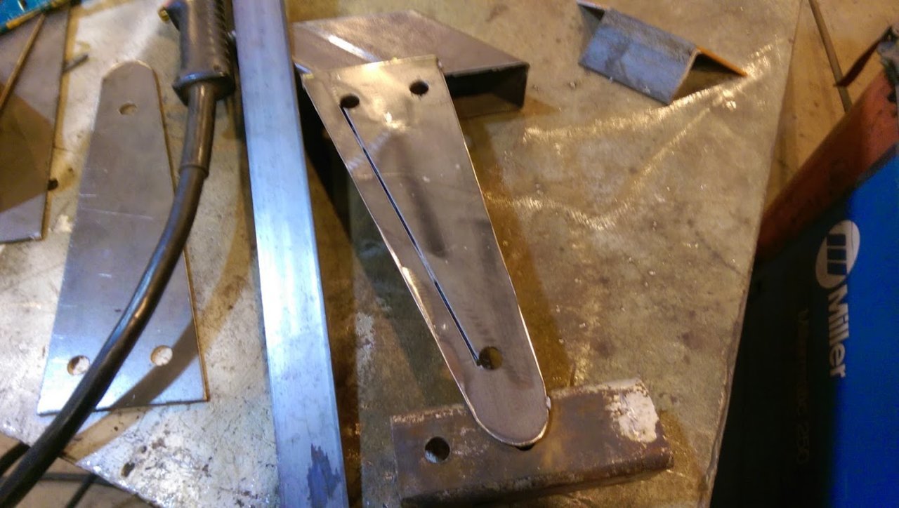

    MjMkH_P8IGcf0i3EmKJ-ETn6D7o4P9t9tdaTrBO__5483df49f9eb0fa3d432997aabbf82ef02fc299e.jpg Welded some 1/4" plate to the box tube. There will be a sister plate that the bumper itself is welded to. The 4 bolt holes allow me to insert washers between the plates to ensure the bumper is orientated the way I like.

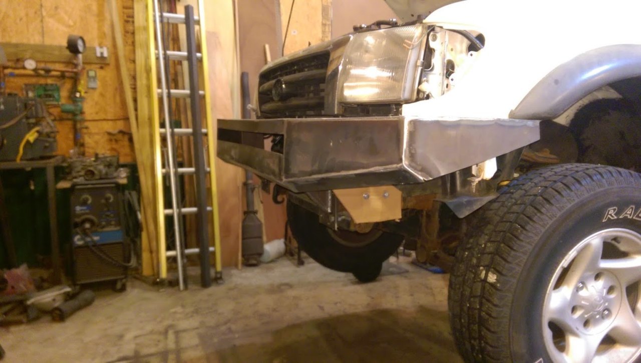

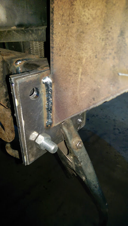

    H1Z8rlvZ1LqtdUl2HmcyBQ_PHkuNu8OPN_p6qNyI_7c83d3cf157f05e399c2159ac85cb3ed08fb92da.jpg
    Box tube welded to the outside plate. Bottom is cut off at an angle. Didn't really need to do that, but was trying to save weight where I could. I had no idea how heavy this thing would end up.

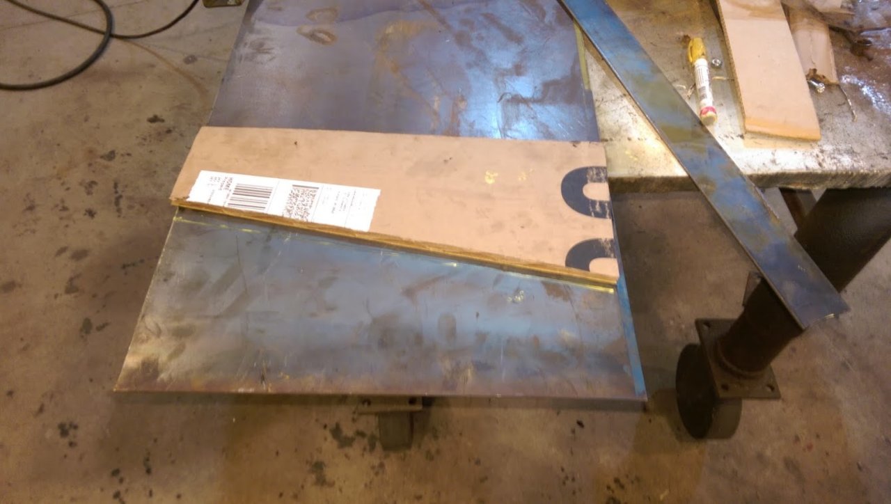

    I was an idiot at this time. I did not have any pics of the cardboard mock up. I did save time by only mocking up half the bumper. It made no sense to me to make an entire bumper out of cardboard.
    vC3cgkk3DJyGIl9-x1V0SX1ydZWJjdatmJWD9Ba5_b3c7b4d4480905cceedd8de3fb71b454af951b17.jpg All the pieces on the right side of the truck would be the same as the left. All you have to do is flip them over.

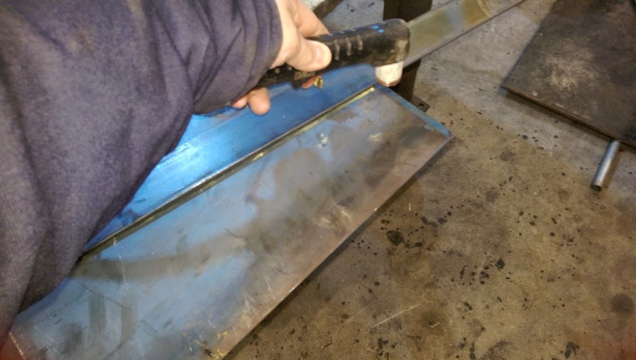

    WpzyVRehN6YoOKZCv2-Ub0XNrdFg9mkad5btPOTk_398ee503e5579cae1824c1e8f035cd4714fcfd14.jpg
    Plasma cutter and a straight edge saves huge amount of time and grinding. With a new tip, the cut is almost as clean as a shear.

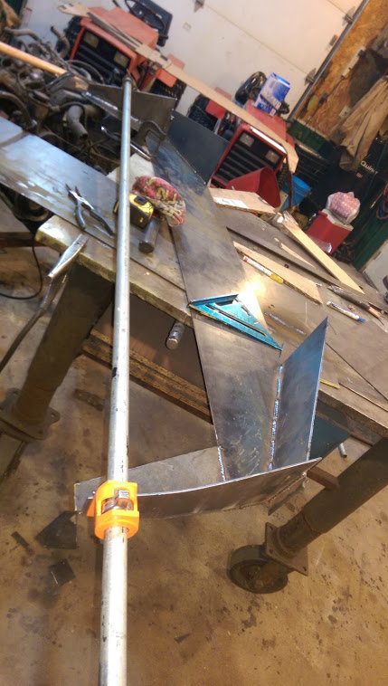

    OubvJz3-heSq6r74ev4324EeKn5w1y1bmgAe1UI8_c0c7e9e50ae1c9e9de8234b6fa73e166b5aa3d3b.jpg Bending the "wing" pieces to fit the top of the bumper with plain, old bar clamps.

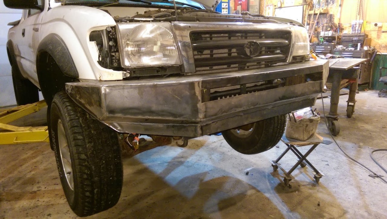

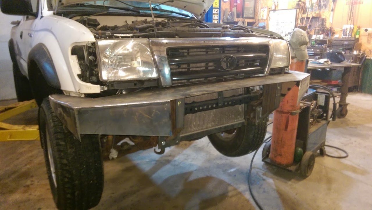

    Main parts welded in. Pretty happy so far.rBN2EZJJeu4W3f_VoTTwIZxgmrh1N1pW1pAXcMqp_0181bf2ea74a4d20e8f519b5d530808b598ff462.jpg

    Got the bottom angle back piece welded in. Honestly, at this point it goes very fast because I had all the pieces cut out ahead of time.cOFHamp4xMjUBguTKcIYpOB1tXfaCHtrCsqXDKe-_d1069cfca4bc856db43f54c08de8076dc5f579c1.jpg

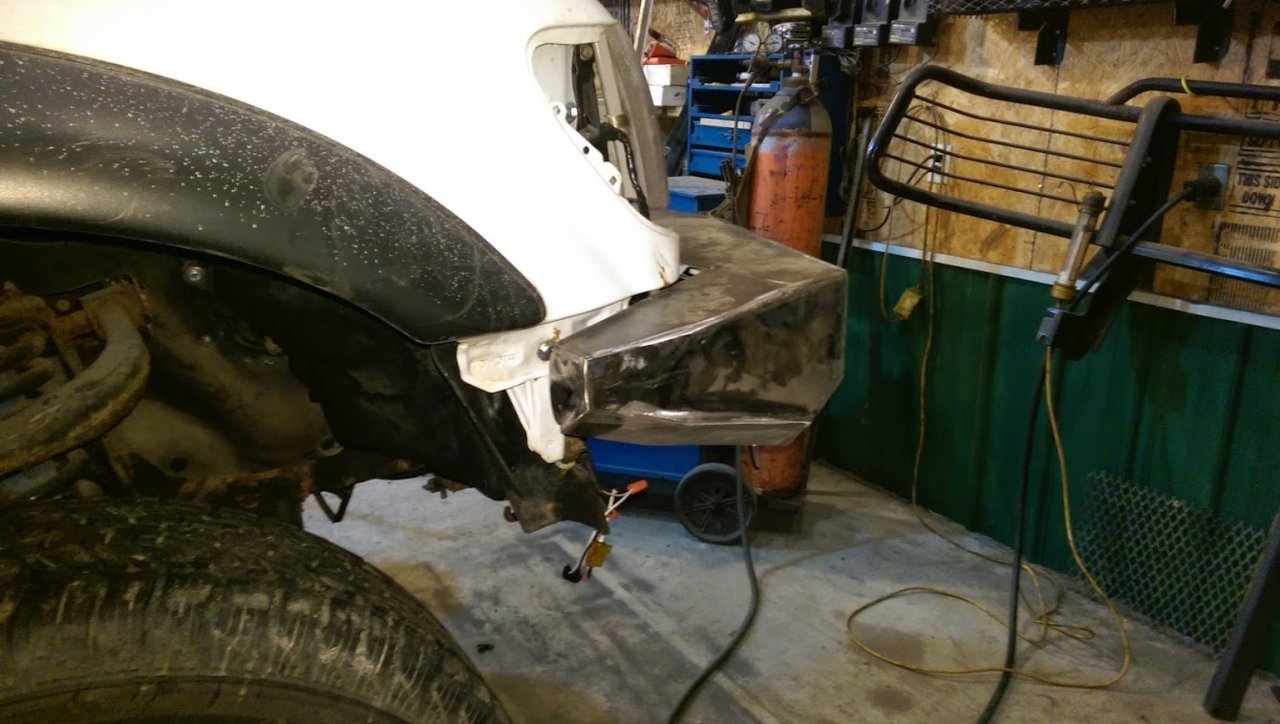

    Central Michigan

    I forgot to mention. The cardboard piece bolted to the truck it a gauge to ensure that the top of the bumper stays level. I can see at an instant if the bumper is tilting forward or backwards.

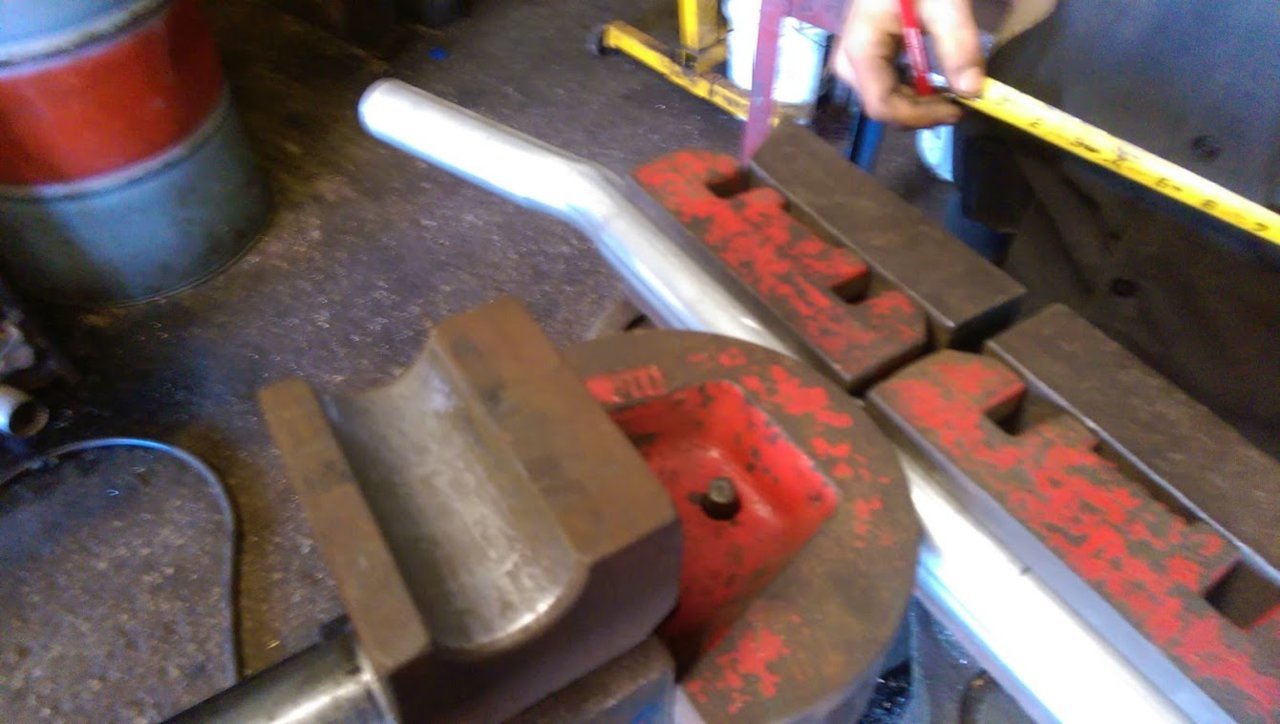

    pRyweN8s_71-SuDFGAFE54g5wXpm14lrw4TA7BAk_b98075c2050ad5ca71a9d7264a6e18eecefcec39.jpg
    Backing up a bit. I don't have a pipe bender. I cheated and had my local muffler shop bend my hoops to the dimensions I wanted. I took some coat hanger wire and bent them to the exact shape I wanted.
    The tech was happy that I had no issue with 3 different pieces. They are seamed at the hoop support junctions.
    It cost me $20 and a 12 pack of Coors Lite for the pipe and bending. By the way, the tube is just plain old exhaust pipe.
    The shit withstood a glancing blow to a deer collision a couple weeks back. Zero damage or deformation to the bumper or the hoops.

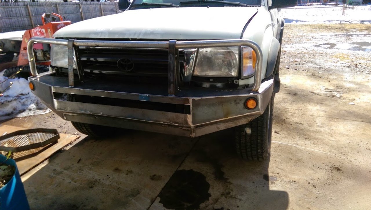

    ngd7kpxlfTrk7GVGq1Ghav_J6k3MTbWzrC-VhS_S_a9fa8f8fa68d01f4144d07126e7f4e3acd7e7f98.jpg Tubes welded in and the hoop support band iron welded in. No one can see that the hoop is actually 3 different pieces.

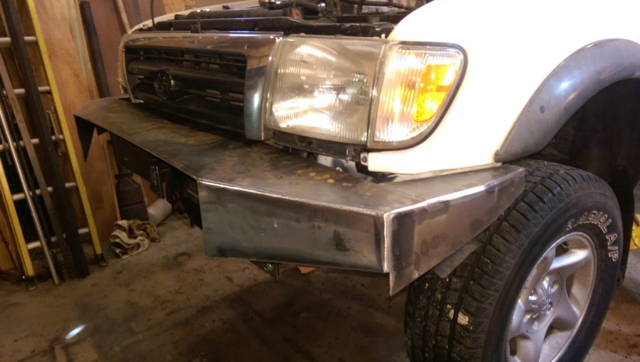

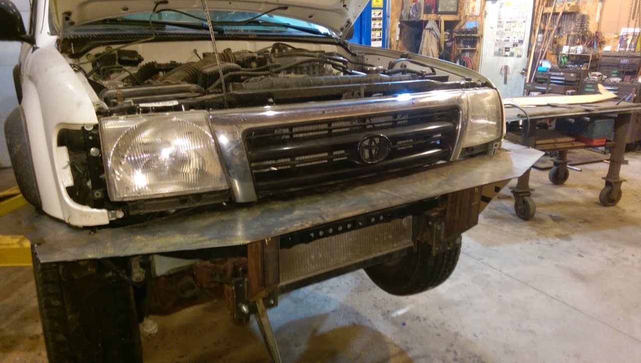

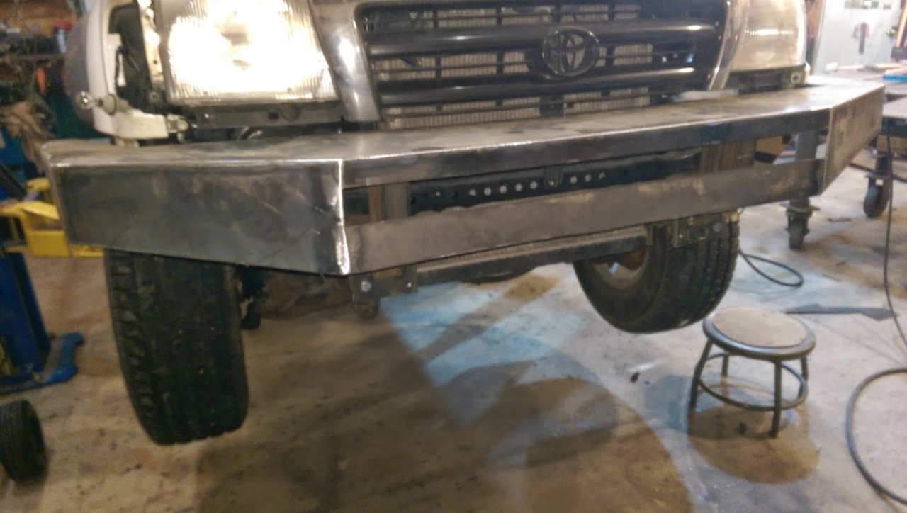

    rfjBURyNtz-I30CPHhO3EPD29ebr6w54ews57j_B_63328e74c4bc1a8632f80b314ab50e19eb45a4e1.jpg 1st test fit on the truck. At this point I'm very pleased with the results.
