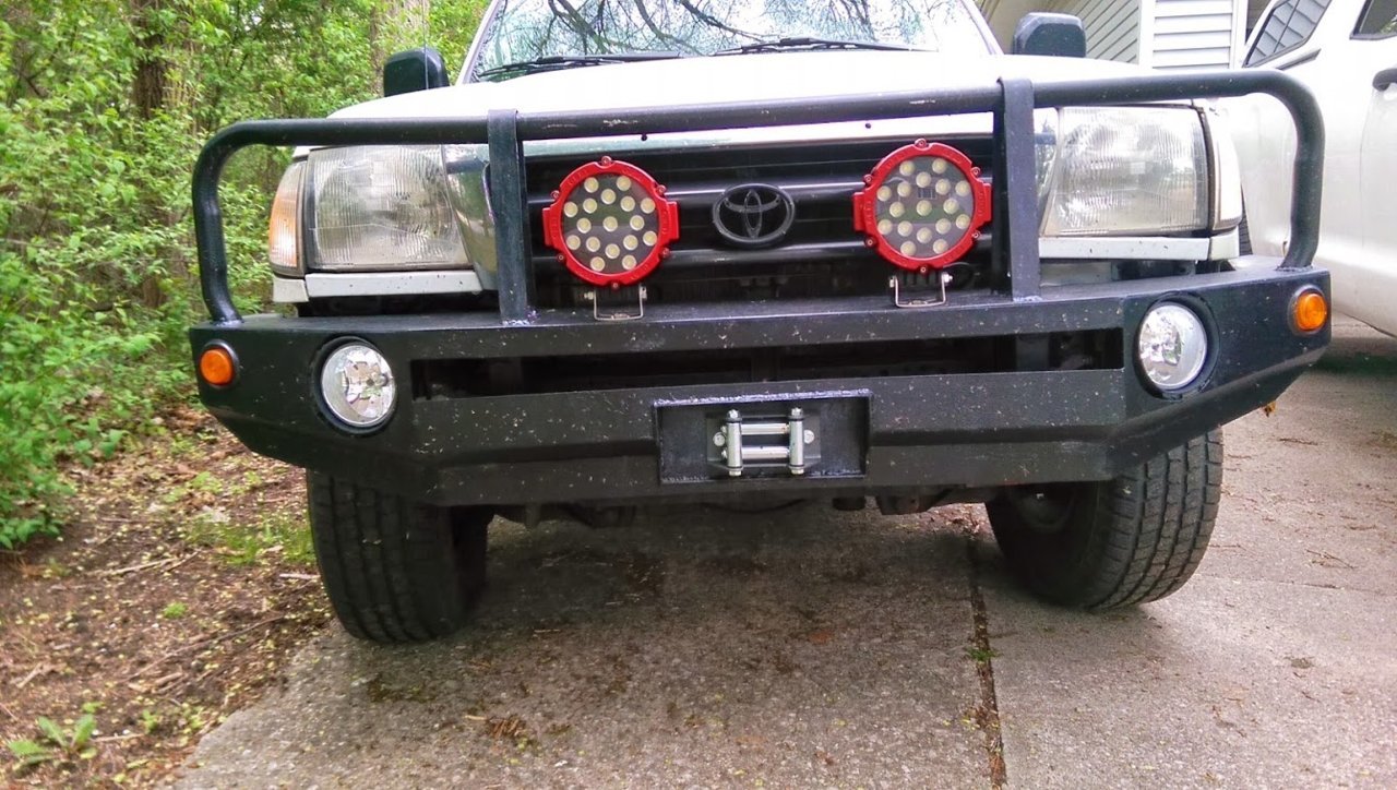

    [​IMG] Three days later I have the running light cutouts done and the winch fairlead base welded in. Still need to cut the hole for the winch line to feed thru.

    Black paint shows up terrible in pics.
    I used Harbor Freight bed liner paint. It has a texture that I like and is very durable. Plus its easy to touch up. I give the bumper a quick roll of bedliner paint every year. I love the deep, black color that new paint has. Fuck plastic coating. Water gets under the plastic coat and then bubbles the plastic coat. This is a work truck, not a show truck.

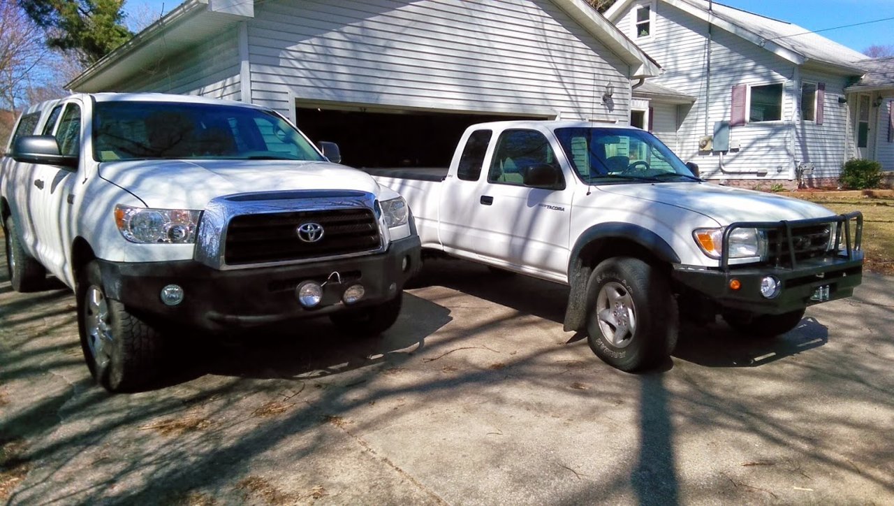

    WWCvyTM_jHpEIo7hYWOpD52wYySfCQ2db-VyYTwl_955bb4cc9d3753e3f1ee9b30c04b80f625209a24.jpg Having trouble finding a good, final pic of the bumper. Here it is on the truck.
    Yes, I did the bumper for the Tundra too. I'm a member of that site as well, but those guys are boring AF.

    Found a front on pic. The bumper is not as wide as it looks in the pic. Being close gave it that perspective.hIsd-_NEePVkzjOWvCL-0-rQHR6z_6TGHrcHt94q_809b17d0ebdfc3891c8fe33823ec65af0279d774.jpg

    Nice job I rather like these style bumpers over the tube bumpers
    Is the majority of the bumper made from 10 gauge ?

    Yep, Craig, all 10 g. Plenty strong with a decent weight. I lost a half inch of clearance. I'm due for shocks soon, so I'll grab some 881 to level it.

    why the gap in the front panel?

    The gap is for a light bar that I decided wasn't what I really needed. I guess I just got to thinking how little sense it made to me put one on.
    In addition, I could never find the rubber push pads be to install either.
    Can't have it look exactly like an ARB can we now, can we?

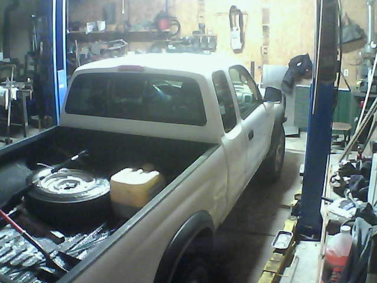

    Bummer. The truck was facing the wrong way.
