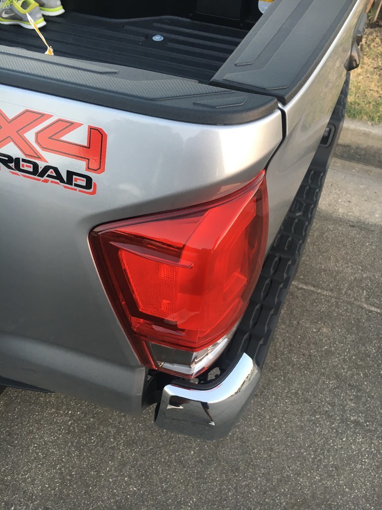

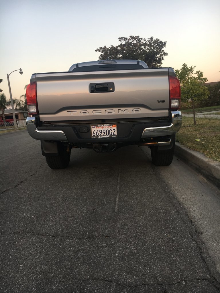

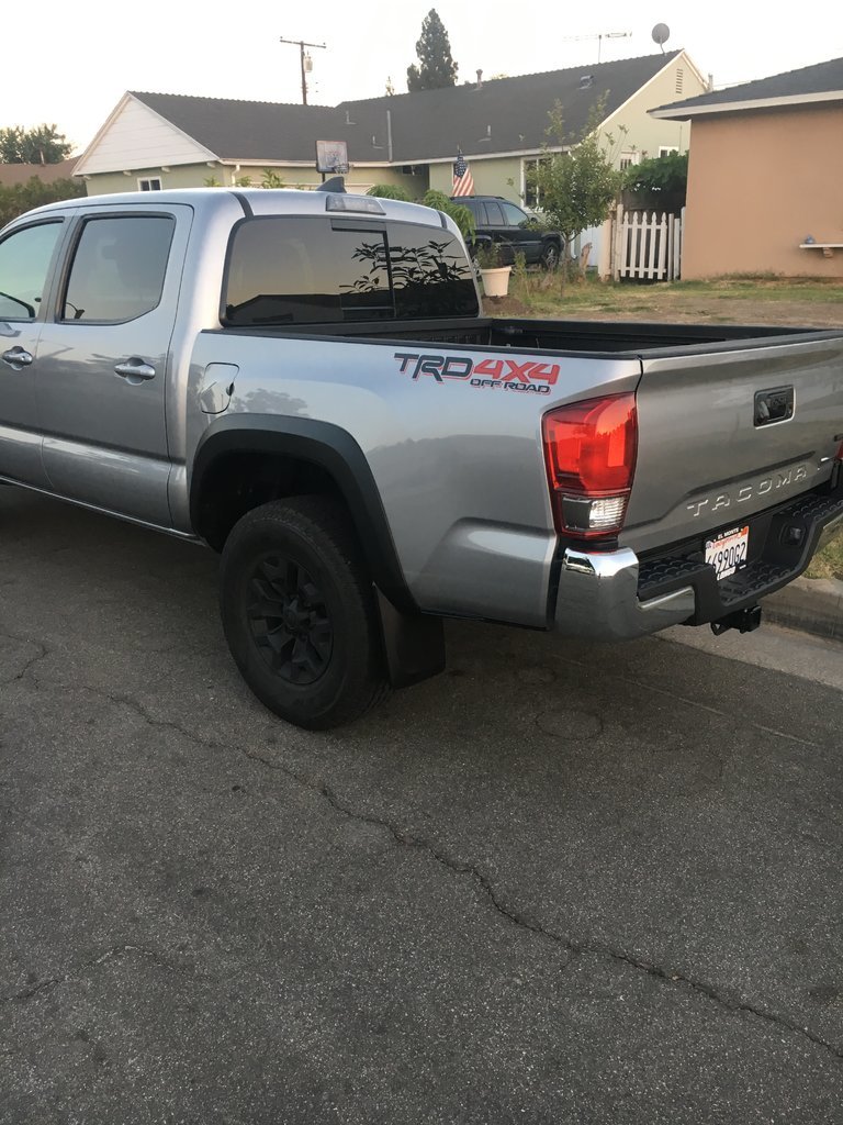

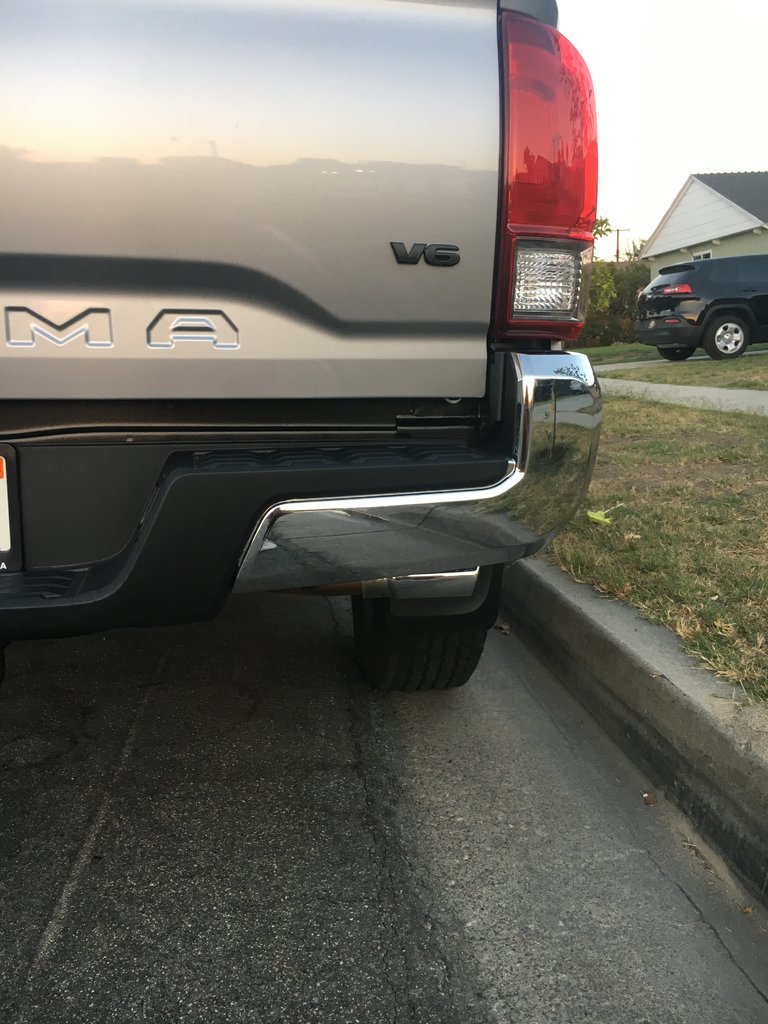

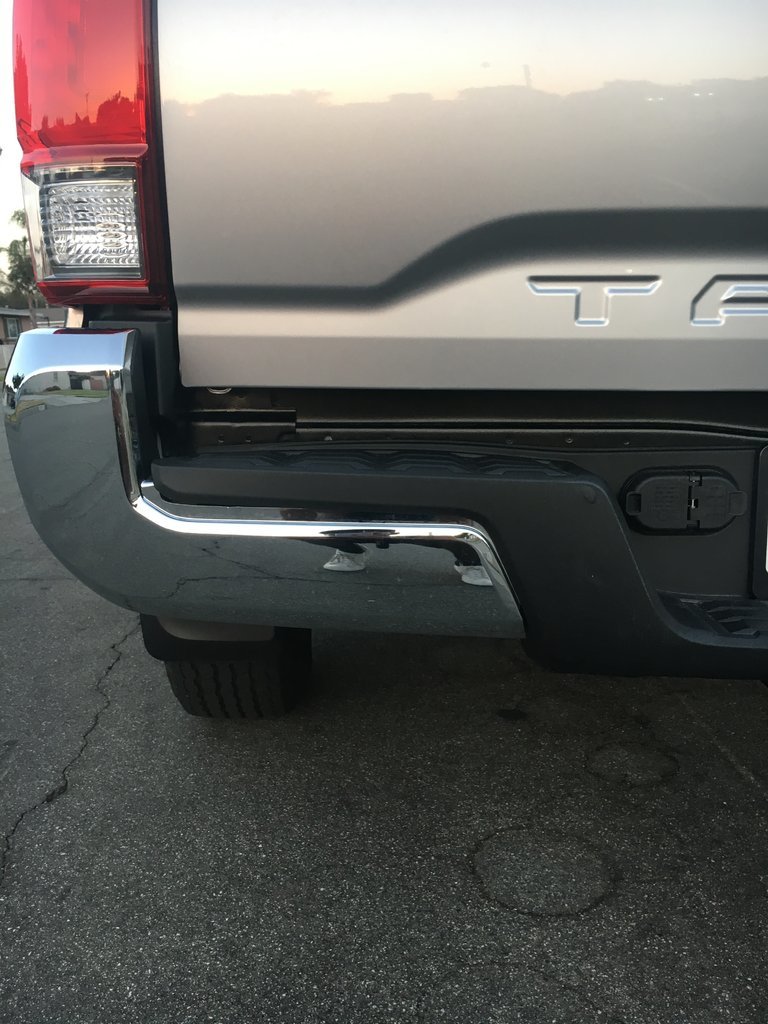

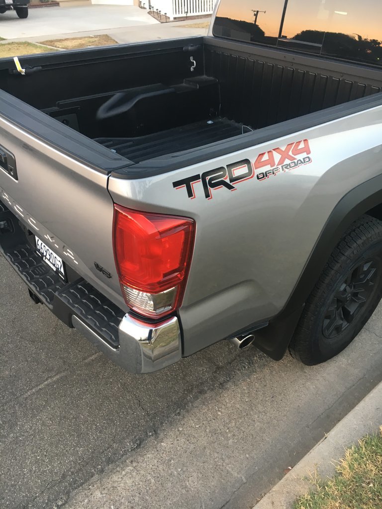

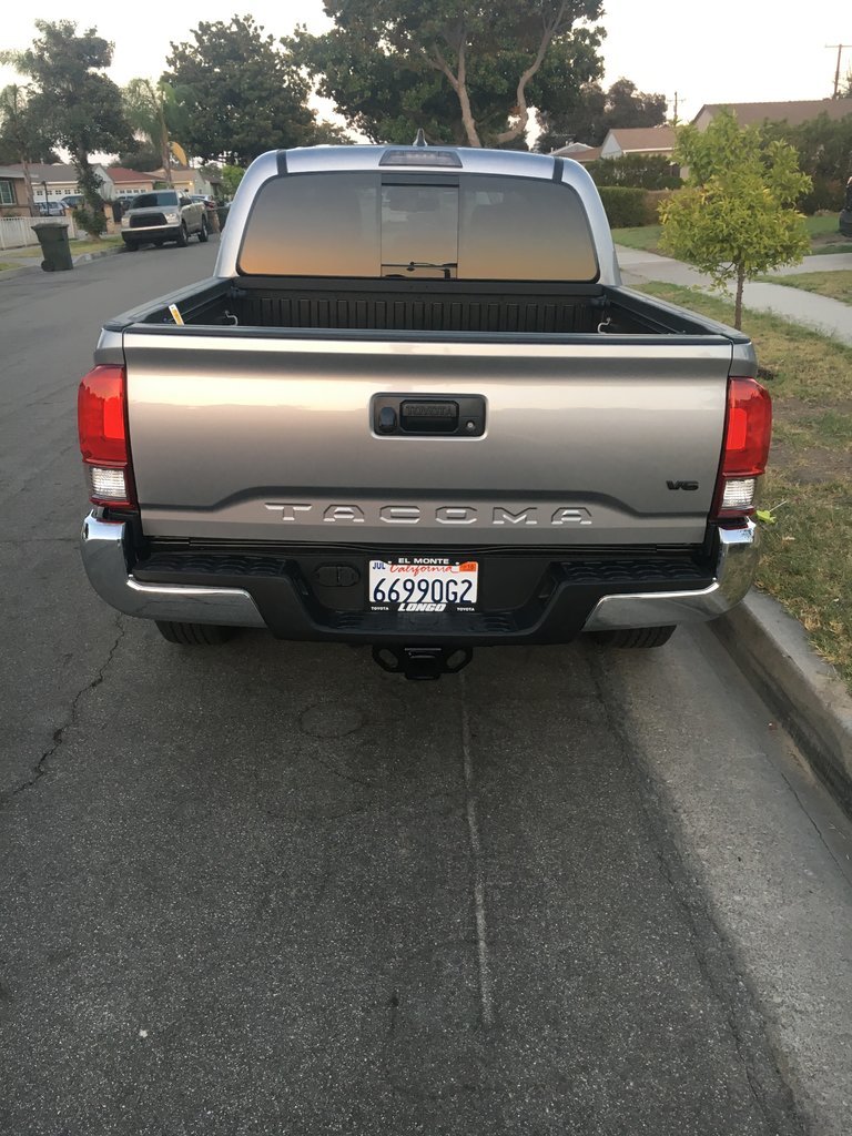

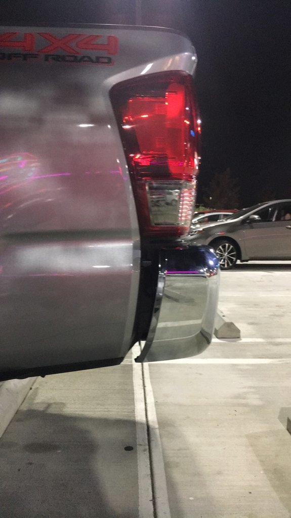

    IMG_3836.jpg IMG_3834.jpg So my luck with my cars being hit or something happening to them is not great. Prior to this our 4runner was totaled when somebody reared in when it was parked on the street. I was washing our tacoma when i noticed the rear bumper on this one was popped off. The dealer is saying that it would be 10,000 to fix and replace the whole thing. It seems as if it can just be popped back into place. In addition if the dealer is asking for this insane amount then why not just spend $800 on a bumper and fit it in. Aside from the bumper being off the car drives perfectly fine and there is nothing wrong with it. 10,000 seems like a stupid amount.
    Does this seem as it can be popped back in? Or a quick fix? What should I do?
    Also I have plastidipped rims and decals which they were blaming that I could have "pulled" the bumper while working on it. I laughed, since it's a coat on top and all visual.
    I appreciate the advice and help!
    Edit: Sorry I thought I uploaded photos. And also I came out to it and found that it was popped off. I think someone or something may have clipped it.
    *first two photos show off side*
    *third shows the fine side*
    WHAT HAPPENED:
    Alright guys so initially we got to the dealer at 10am and they gave us the price point of 10k. I however had to leave because of a school club event. But my dad ran me down on what happened. Their reasoning for the 10,000 estimate was that damage was also done to the frame of the car as well as the bumper, HOWEVER upon further inspection they said it was only the bumper (this was after 2 hours of talking to them my dad said) And so what happened is they said they would fix it for $3000 (LOL) and we can include our insurance deductible that would bring the cost down to $2000 to fix at their collision center (still a ridiculous amount). And so long story short after hours of deliberating and them finally coming up with a solid price my dad got home from the dealer at 6pm..... so it looks like we're going to have to go aftermarket
    More photos taken today

    Now that I see your pictures that spacing is "normal" on Tacos, I bet the other side is closer?? There are a bunch of threads about how the bed and bumper alignment is out of wack from the factory. The bed alignment is easy as all you have to do is get a Torx bit, loosen six bolts, adjust the bed, then retighten. The bumper gap alignment is a little more involved as you have to remove the plastic plate and the license plate lights to get to the bolts to make that adjustment. For the dealer to tell you $10,00 is beyond stupid and you should run away as fast as you can before some of that stupidity leaks out!
