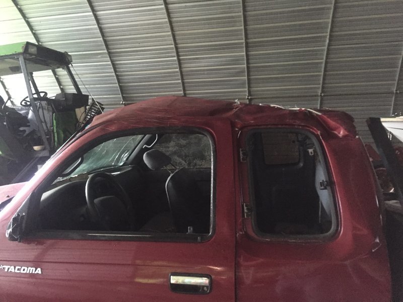

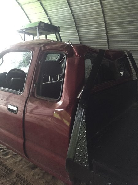

    Ok so I own a 1996 Toyota Tacoma 4x4 automatic extended cab I just unfortunately hit a deer and riled the truck so my ? Is I have found a 2 wheel drive standard Trans will this cab off of this donor truck work as fare as are the cabs the same and will the wiring just be plug and play I need some help figuring this out thanks

    Also was think about cutting my existing cab at where the rails are going up to the roof and then rite across where the bottom of the seats are bolted down there is a factory seem there and basically just remove the hole back half of the cab and roof and then take the donor cab and cutting it the same way and then welding the 2 back together which do u think would be the least amount of work ????

    Swap the cab. It's not that difficult. You can strip a cab in 1/2 a day. The shifter hole will need to be cut. Block off the clutch master cyl hole. Transfer wire harness, and the interior you want to use. Also swap the pedals. Cutting the cab would be a lot of work. Body work and paint too.

    Cab swaps are easy just take your time. Label everything and start swaping. Moving the cab will take 3 people to do it quickly Cutting and welding is a bad idea. Nothing wI'll line up trust me and @Skorfab

    Unless your a very experienced fabricator and gifted auto body repair person I wouldn't attempt a chop job and trying to swap roofs. @Irongrave and I cabs sapped an 84' truck with an 88' body. The 84' had been rolled and the roof was chopped with a donor roof ready to go but the more we got into it the more of a pain in the ass it looked. Everything should work though, it really wasn't as difficult as I though it would be, possibly easier for you as I did a whole dash swap as well. The wiring harness in the engine bay has a plug near the front that will make your life a little easier. You have toworry about EFI wiring with yours I'm assuming which I did not which probably helped as well as not worrying about saving the heat or AC system but it's all made to come apart. It's a 94' Toyota, get some thick rubber matting and glue/secure it to be floorboard put your shifter boot in for the auto and put your carpet down. LABEL EVERYTHING when you disconnect it.
