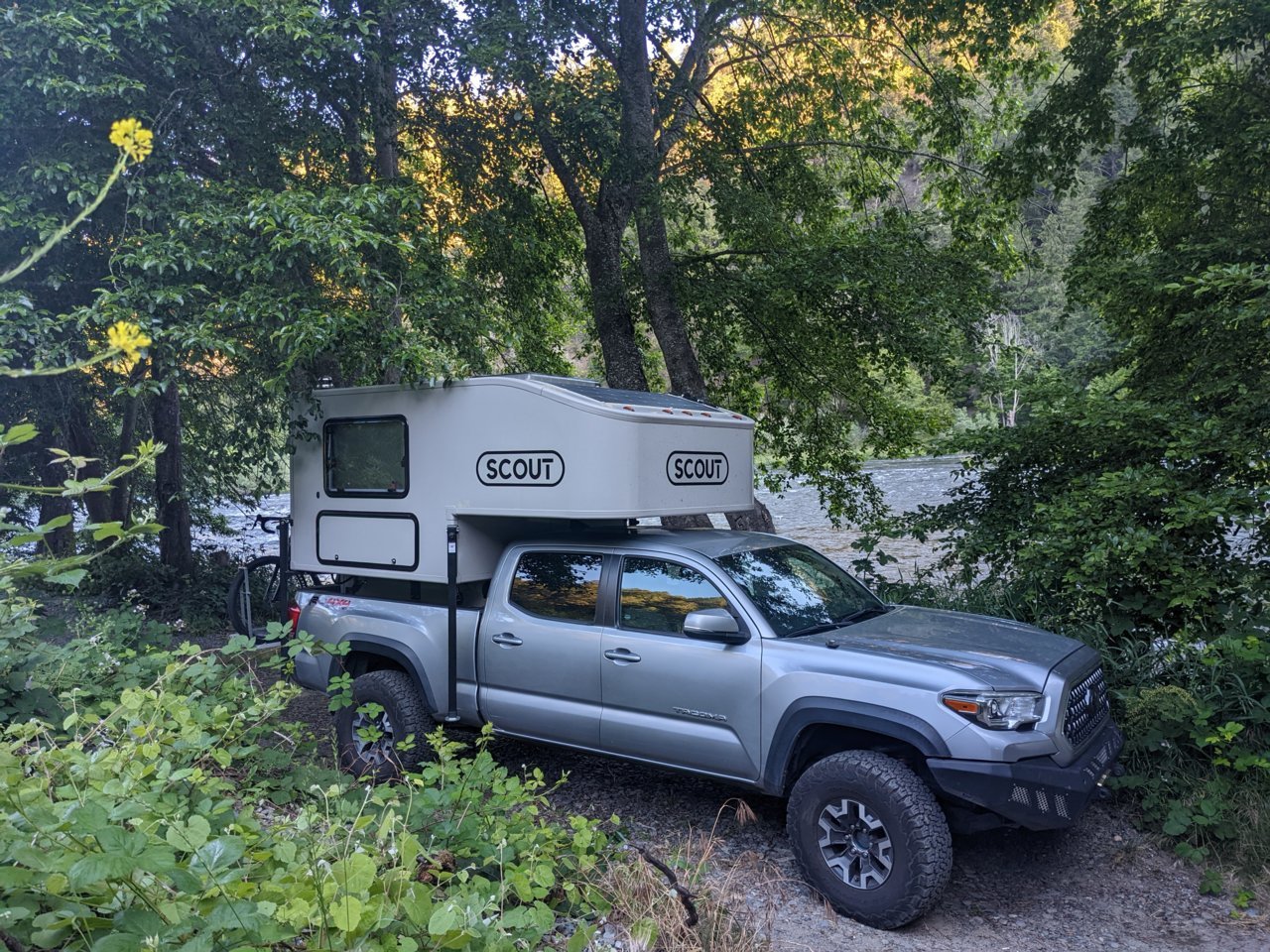

    My Scout Yoho has been a thrill. It felt like there's plenty of improvement possible in thermal insulation, maybe due to the open cabinets and imperfect weather stripping at the door. Just don't expect a thermal box. The water system, fridge, furnace, solar + battery, windows, lighting and interior design are spectacular. I'm especially fond of switching out the swivel table for a larger bench. And the camper jacks are flawless. The stove is janky and bulky, so I might substitute a Cook Partner single burner.

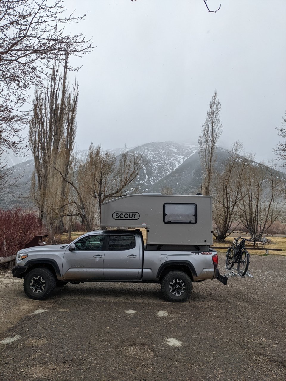

    Timbren bump stops were woefully inadequate, so I took the plunge by upgrading to Deaver Stage 3 leaf pack with 4 Toytec Boss 2.5 Aluma shocks with Camburg control arm, and re-installed the anti sway bar that prior owner took out.
    On a short bed, even the small Yoho would be inferior to using the 6-foot long bed. The reason is center of gravity relative to the wheelbase. Plus, it's real nice locking the thing behind the tailgate.

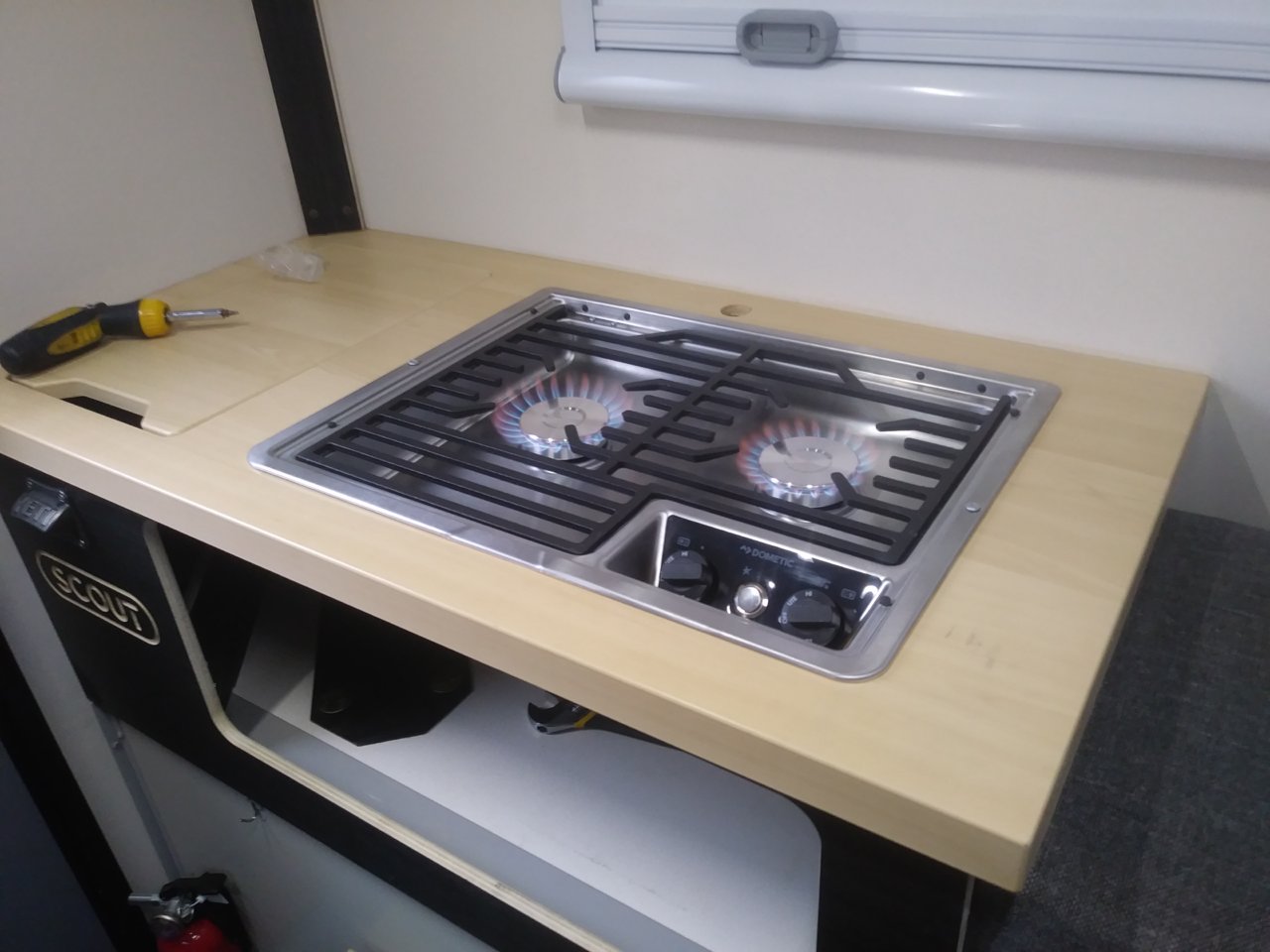

    Drop the stove in the camper if you need more space. Makes a massive difference.
    Also, if you go to the Cook Partner, it is a high pressure stove so it's not compatible with the current low pressure Propane system in the Scout. You'd need to hook it to a separate propane source, or re-pipe the stove's propane line to between the Tank and the campers regulator.

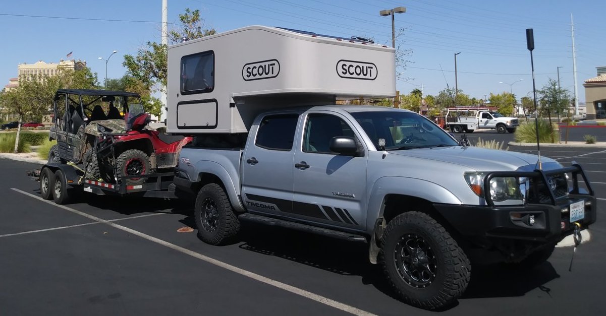

    With the Deaver U402 Stage 3 leaf pack I haven't had any issue with the Yoho and the Short Bed Tacoma. My first trip with it was from the Seattle area through Utah, down to Vegas, and back home with the load below. My truck has been re-geared though, from 3.73 to 4.56.
