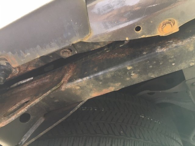

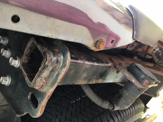

    New to the forum. My 2011 Taco Double Cab PreRunner with 46k miles Tow assembly is rusting away. It's been garaged 5 out of 9 years in Fl and AZ and have never been driven into salt water as the Service Mgr suggested might have happened. It towed a small u-Haul trailer once in 2014. Will this cancer become stage 4 and spread to the frame structure. Service Mgr advised warranty on accessories is only 3 yrs/36k miles. I also have 2014 LS 460 Sport, 2015 Tundra Crew Cab, and 2019 Camry in my stable. Is cancer in my Lexus/Toyota future. Tks

    Tacomabaja12
    Tacomabaja12 Well-Known Member
    May 29, 2019
    #294701
    331
    Oscar
    2012 Barcelona Red TX BAJA TRD
    Pics might help

  3. Feb 3, 2020 at 8:58 AM
    jbaker1976
    jbaker1976 It's always Taco Tuesday
    Oct 18, 2019
    #308323
    272
    Jason
    East TN
    2015 DCSB OR
    Camper shell with side windoors and bed slider, JL Audio Component Door Speakers, JL Audio Stealth box, Grill Craft Grill, Husky floor liners, Hondo Radio knobs, Predator steps, Remote Start, Pop N Lock, etc...
    Is it surface rust on the finish or is the rust actually penetrating the metal or the welds?
    We need some pictures.

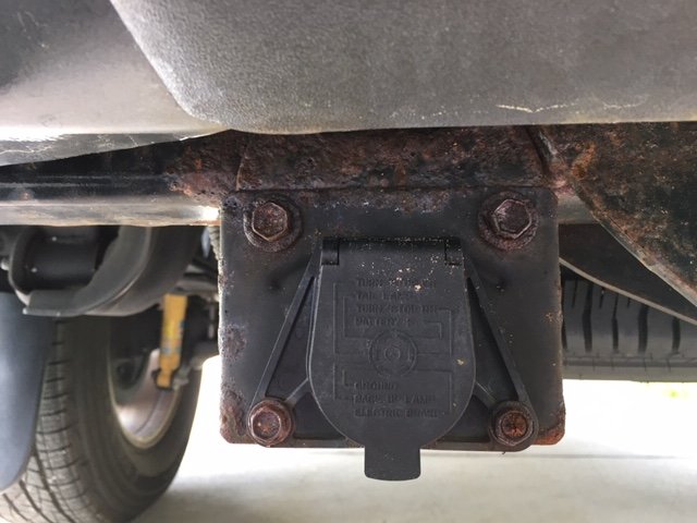

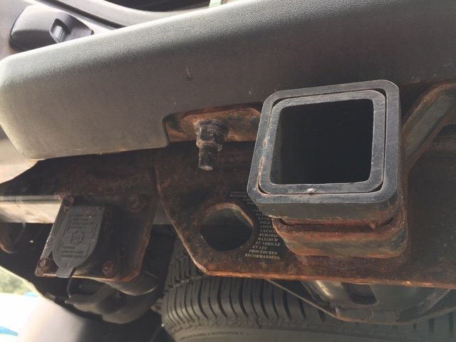

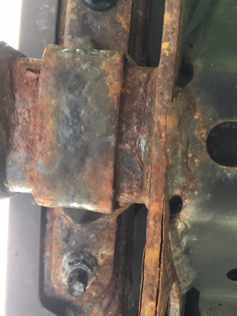

  4. Feb 3, 2020 at 9:13 AM
    CamTaco813
    CamTaco813 [OP] Member
    Feb 3, 2020
    #318099
    6
    Southwest Fl
    2011 Gray Taco PreRunner w/TRD Package
    Front Push Bumper; BakFlip Hard Shell Cargo cover;Powered Tailgate lock/open
    Pics attached.

  5. Feb 3, 2020 at 9:20 AM
    andrew61987
    andrew61987 Well-Known Member
    Jun 2, 2015
    #156610
    1,283
    2008 Access Cab 4WD, 2.7L 5 speed
    I would not tow anything with that. Luckily a new hitch is cheap, just replace it. Hopefully other areas of the truck are fine, if they are I wouldn't worry.

  6. Feb 3, 2020 at 9:30 AM
    TacomaMike37
    TacomaMike37 Well-Known Member
    Aug 12, 2013
    #110316
    5,085
    13' DCLB MGM
    Why can't he tow with that? Structurally it's fine.
    OP this guy is off his rocker if he thinks that its dangerous to tow with a hitch that has some rust.
  7. Feb 3, 2020 at 9:43 AM
    Musubi3
    Musubi3 Well-Known Member
    May 16, 2016
    #187108
    1,672
    Big Island
    2014 Tacoma DC 4x4 TRD Off Road, Supercharged
    Something I'd do is remove the hitch assembly and bumper, clean the rust off, treat it, then repaint the rusted areas. If you just take the hitch assembly off I think you need different brackets to support your bumper.
    I recently addressed some rust areas at the hitch and repainted it black. I power washed the rust areas where I could.
    CamTaco813[OP] likes this.
  8. Feb 3, 2020 at 9:51 AM
    Greeny
    Greeny Well-Known Member
    Nov 9, 2017
    #235499
    261
    Martin
    Rexburg, ID
    bone stock 2001 Taco 4x4 TRD
    ^^^ Remove it, clean out rust, sand it, rattle-can some primer/paint, slap it back on.
    CamTaco813[OP] and whatstcp like this.

    I bet someone owned a boat with that truck in Florida and that rust came from loading and unloading a boat in salt water.

  10. Feb 3, 2020 at 9:58 AM
    Reddy
    Reddy Well-Known Member
    Jun 24, 2014
    #132613
    350
    Scott
    Ohio
    '11 TRD OR AC
    OME 885's/Dakars/265's/belly skid
    That's really not that bad, mine's worse. Well, was worse. I wire brushed the crap out of it, soaked it in 3M rust dissolver, then put on two coats of chassis paint. You could do the same.

    Hitches rust. Its not just a Toyota thing. That's really not that bad.

  12. Feb 3, 2020 at 11:22 AM
    Rick's 2012
    Rick's 2012 Well-Known Member
    Dec 11, 2017
    #238253
    2,478
    Rick
    Costa Rica
    2012 Double Cab 4x4 Grey with leather
    Stock
    Garages can trap high humidity. Rather than having the air circulation like outdoors. The air in a garage is stagnant.
  13. Feb 3, 2020 at 11:25 AM
    Empty_Lord
    Empty_Lord Toyotaholic
    Mar 13, 2016
    #181186
    28,297
    Dan
    Northwest Indiana/Chicagoland
    Was that hitch originally on the truck? The mounting bolts look awfully new and the hitch looks like hell.
    Remove the hitch, clean it up and paint it. Nothing wrong with that one
  14. Feb 3, 2020 at 12:00 PM
    SJBlack
    SJBlack Well-Known Member
    Feb 26, 2019
    #284557
    239
    2010
    I bought a 2010 about a year ago and my hitch pretty much looked like that. I just wire brushed, rust prevented and black spray paint. It looks good now.

    More importantly what does the frame look like?

  16. Feb 4, 2020 at 7:31 AM
    #16
    Sharpish
    Sharpish Well-Known Member
    Jan 4, 2016
    #173981
    3,830
    Brian
    Victoria, British Columbia, Canada
    2012 Tacoma TRD OR 4x4
    The hitch assembly is painted with a thin black paint that lifts off in big pieces and rusts underneath. Mine looked way worse. Buy a 3M paint remover wheel and put it in your cordless drill and blast it for 20 minutes. You’ll have bright fresh steel underneath. Then a shot of black rustoleum spray paint and some fluid film on top.

    Original/sole owner since Feb 2011. Never hauled a boat or backed into salt water. Some responders say Florida humid garages or salted air could have caused rust. I've been taking notice and I don't see too many 2nd Gen. Taco assembly that look as bad as mine.

    The same shit everyone else has.
    Mine looks about the same
  19. Feb 12, 2020 at 1:55 PM
    #19
    BUZZCUT
    BUZZCUT Well-Known Member
    Mar 6, 2011
    #52417
    781
    Georgia
    2021 TRD OFFROAD 4x4
    Sandblast and powder coat it. That isn't rusty that bad at all.

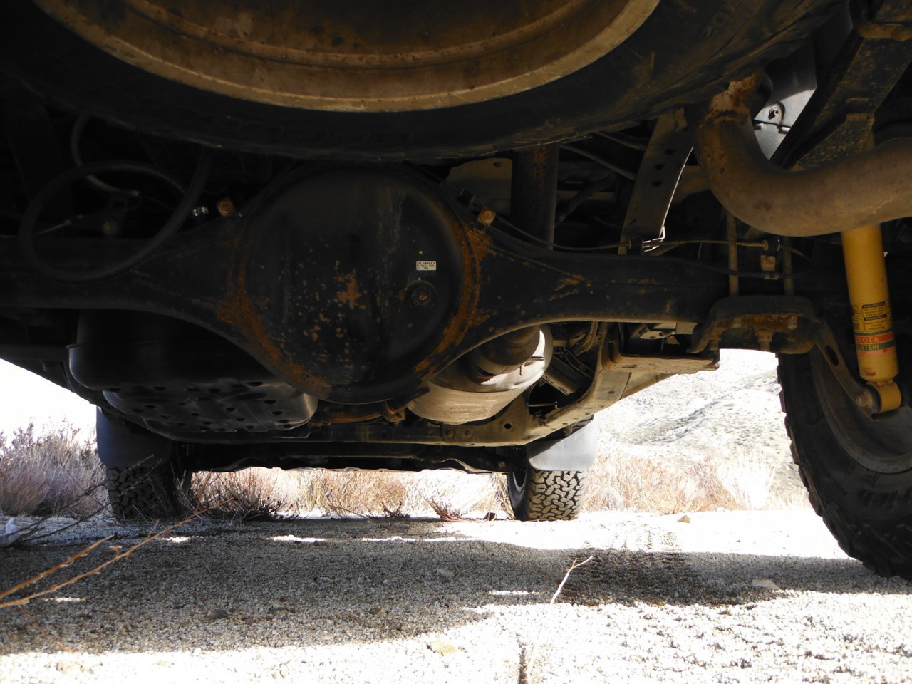

  20. Feb 12, 2020 at 1:58 PM
    #20
    computeruser6
    computeruser6 Nuclear Janitor
    Apr 1, 2015
    #152306
    1,965
    Dirk
    Escondido
    2008 Regular Cab Tundra
    King 2.5 coilovers Nitto Exo Grapplers
    Break out some wire wheels and paint; that doesn't look that bad.
