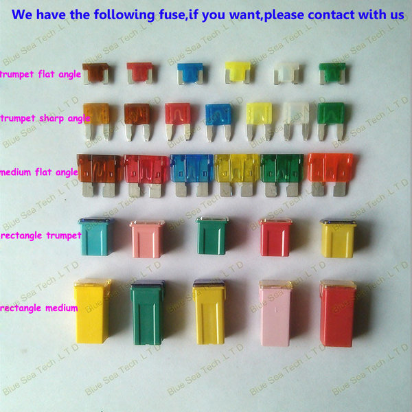

    I had a issue with my truck not starting and it was one of the square fuses under the hood.

    North Carolina
    You said square fuse, are you talking about the relay? Which one? What color is it?

    If it's square it's a relay. They do fail sometimes. One of mine failed on a fairly new Tacoma.

    It was pink. And no, it's not a relay. It's a fuse.
    Like The bottom. Check carefully, it's hard to tell.
    Sterdog likes this.

    My bad. I thought square=cubed like a relay. I own a couple of Fords. Those box fuses are extremely common on their trucks.

    Thanks for posting a pix. I'll check mine. I know mine are completely difference from yours but at least I have the idea which one.
