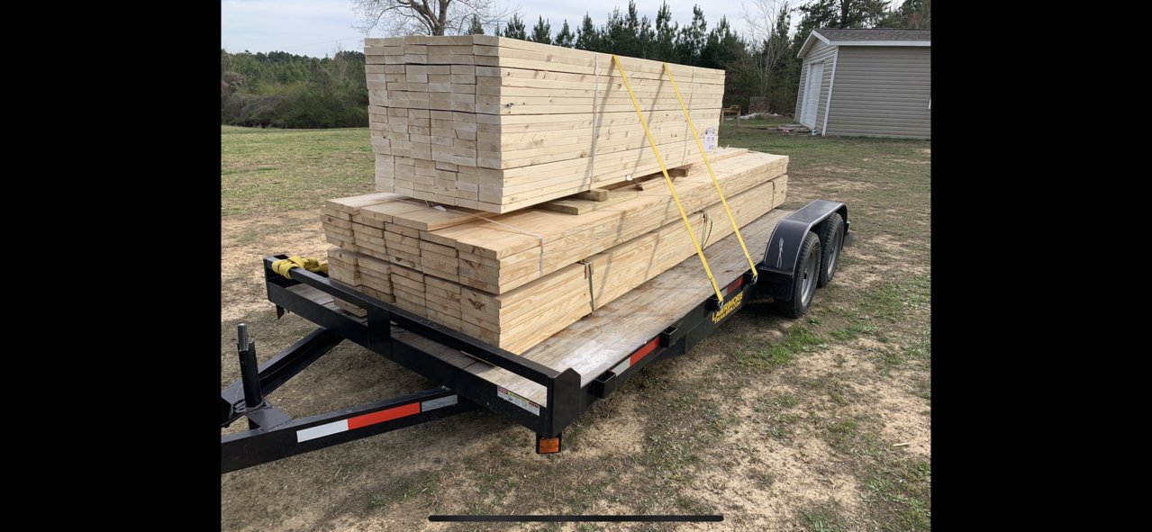

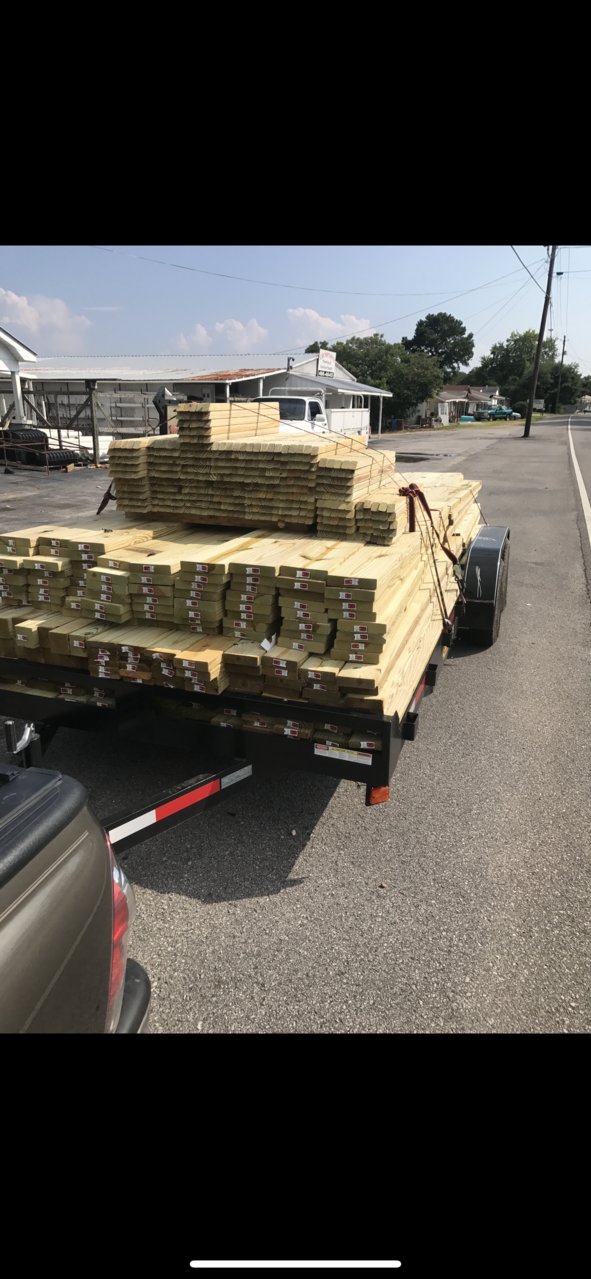

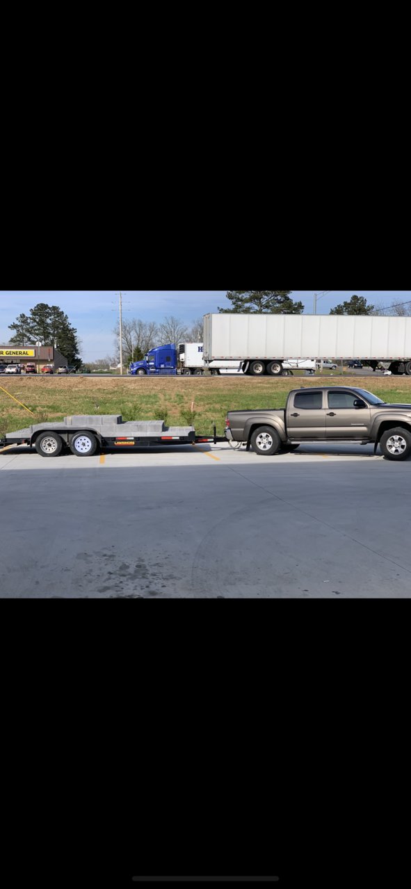

    However, if the new truck I have compares anything slightly alike to the second gen towing ability, what you listed in the original post will be zero problems at all unless the transmission can’t handle what the second gen transmission could. I’ve towed WAYYYYY over its limits too many times and the truck held just as strong when I traded it in as it did the very first time I towed with it.
    I’ll share some pics of what I’ve towed with my 2015 Tacoma. I even towed a full size bobcat 70 mph on expressway from trussville to my house which is close to a 2 hour drive. Also wish I had a pic to share of the load I drove 867 miles one way to a town just 90 minutes north of Miami Florida. Had a full size industrial dumpster made of solid steel, air compressor, guns, lumber, 7 squares of shingles, tar paper, vinyl siding, soffit, various guns and tools, and many other things required for the job. Granted mpg sucked big time but truck handled it no problem.

    Don’t judge me on the cinder blocks and having a major squat to the truck :) that was third load of block I picked up in cullman about an hour and 10 min from my house and I hand loaded every load of block by myself two at a time. After second load of loading, driving home, unloading near job site.... I was a bit tired to reposition the block to be more centered on the trailer than have as much tongue wait as I did. Either way truck handled it just drove like a tank on the way home :)
