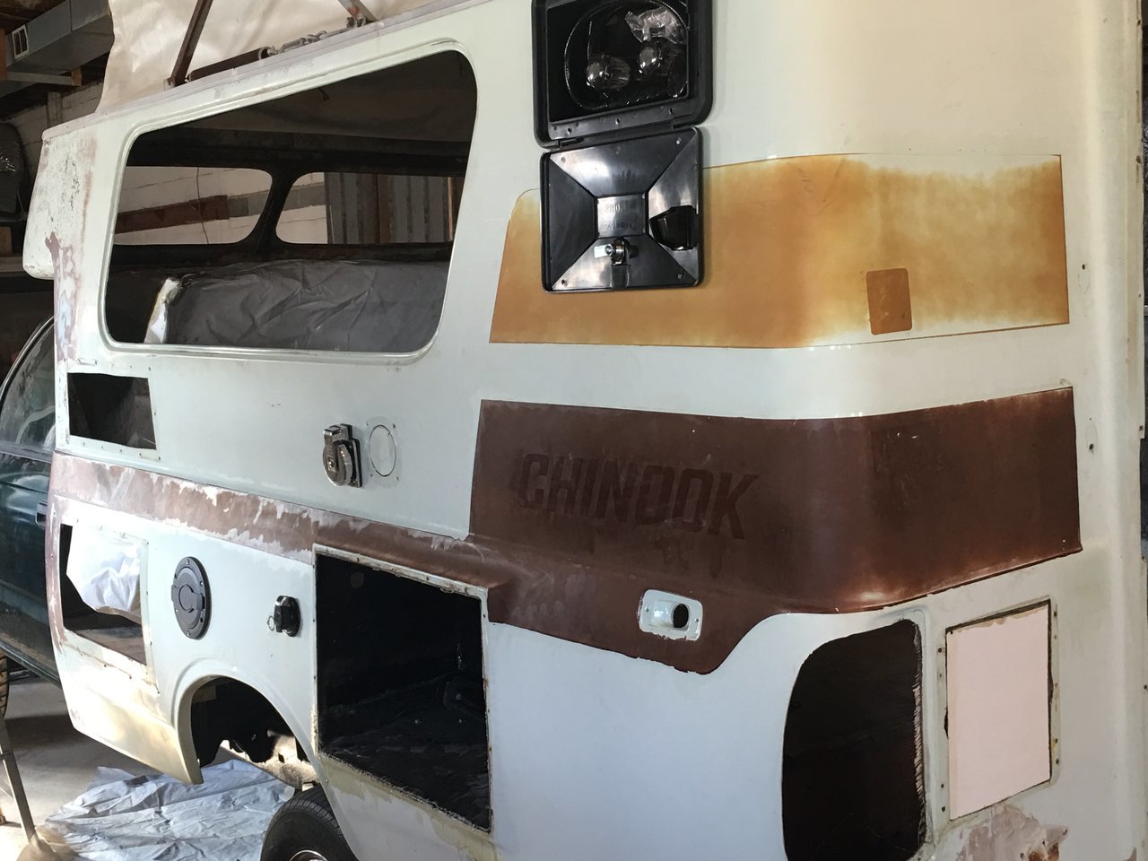

    Just want to share my adventure vehicle build with others.
    I wanted a vehicle for traveling with my wife. We just want to take weekend adventures up and down the eastern part of the country like to beaches, mountains, concerts, swap meets, and the such. We like to explore with our kayaks and bikes. We are not interested in cooking any more than microwaveing now and then. Who wants to cook and clean dishes on vacation? I also will probably just use truck stop and campground showers. I wanted to be nimble enough to jump off the road quickly like a regular car (unlike a motohome or towing a camper) in order to pull into dinners and overlooks and such at the last minute and be able to park in a regular parking spot. It needs to be equipped for two people. Needs to get decent gas milage, be 4x4, room to sleep for 2, Have a sink for brushing teeth and sponge bathes and refrigeration and a microwave. I want to be able to tow small trailer for jetskis or four wheelers or whatever. Want to be able to transport my kayaks and bicycles. This is what I came up with.
    I bought a 2003 tacoma extra cab 4x4 with 3.4 and automatic. Removed the bed, and am putting a camper body from a 1977 Toyota Chinook. The roof pops up when you reach a destination and lowers for better mpg and being able to go under trees and into parking garages. I am going to moernize the camper coach with new interior, USB ports, air conditioning, led lighting, and an eterior shower. I will have a 2000watt Inverter generator on the front (in a winch bumper or something). I will be able to plug in at a campground or run off an inverter from batteries if needed. I am gong to have a six gallon water tank and a six gallon water heater.
    So far my research has defined some of my details. A regular rv roof a/c would take up too much space on the roof (kayak space) and add too much weight up high. Besides that the smallest one is 13,000 btu and way too big for my 48sf space. The wattage that it would draw would negate the use of an inverter generator wich I really want to stick to because of the noise level and lightweight. I found that a newer 5,000 btu wall ac unit would be more than enough and would only draw 445 continuous watts (890 to 1335 upon starting). That would work but would look hideous hanging out the side. More research reveals that I can hide it in an interior cabinet and only expose a grill on the side. I will show those details when I get there. I do not want to have onboard lp gas so I will need an electric water heater. I do not have 220 so i will need one that runs on 110. After careful research ( and purchasing the wrong thing) i found that an on demand water heater will not create enough temperature rise to work. What i came up with is a 6 gallon marine water. It uses hot water from the engine to heat the water while on the road and then i can switch to 110 when I stop. All these details need to be sorted before I paint the thing because I will need to know the interior layout so I know where access panels and such will be cut in on the outside. I am still in the process of all the layout.

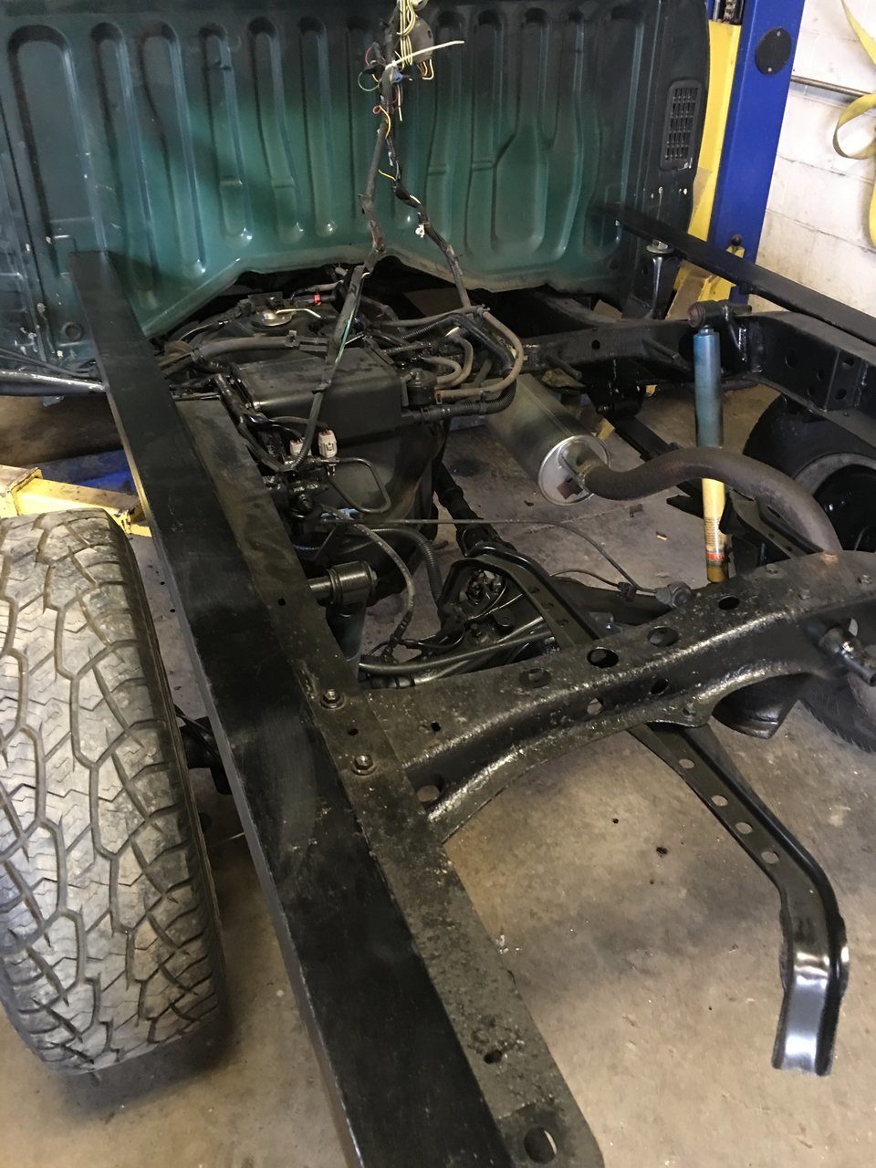

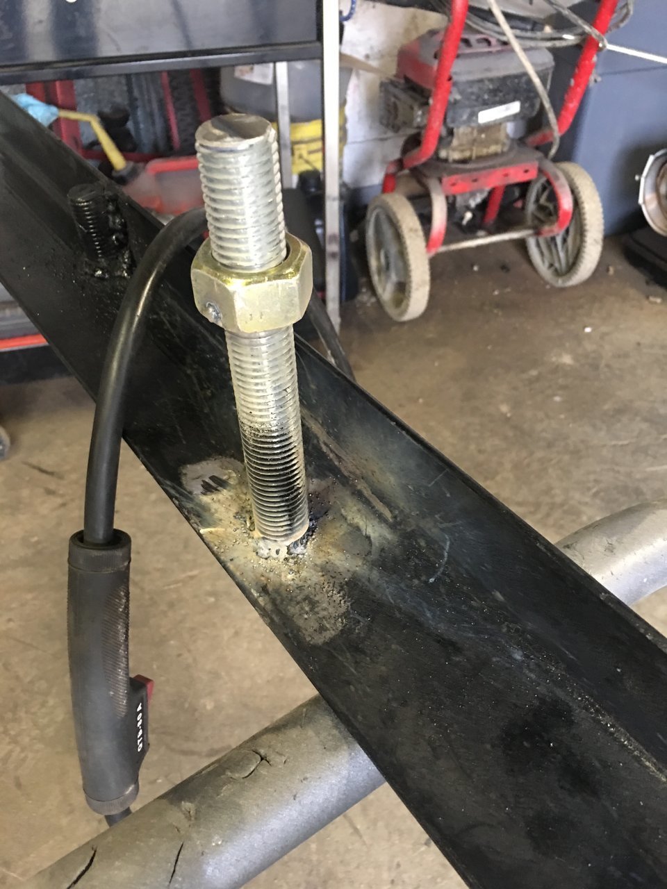

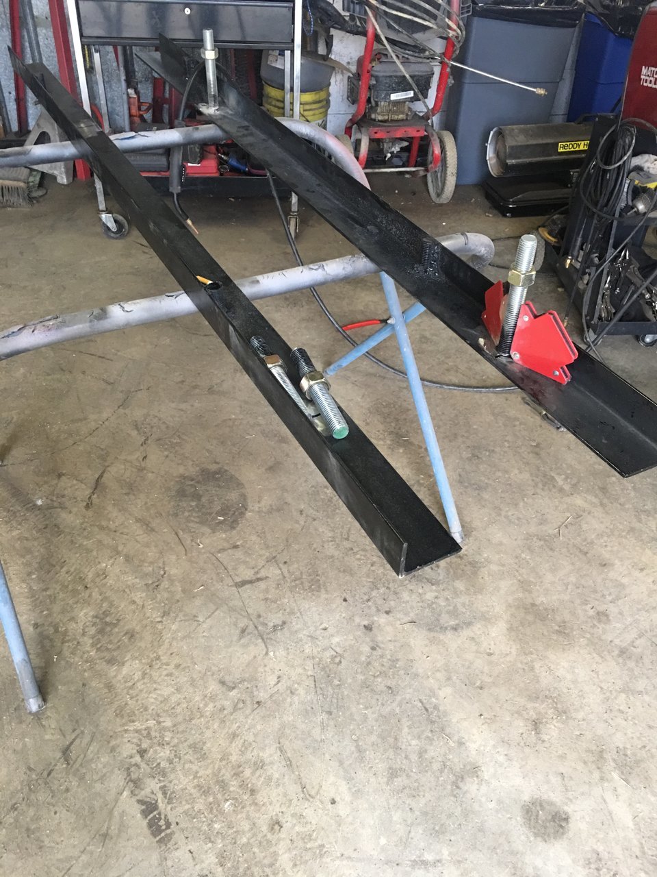

    I have to this point repainted the truck frame and built a rail system to hold the camper leval on the truck. I made it from angle and used all thread and large nuts to be able to adjust the height of the coach to the truck cab.
    I feel like I am getting too wordy for now so I will stop for now and continue my progress in other posts. Enjoy the pics for now. 6050DFFD-3A7A-4AC7-BF06-4DD7816C6CB6.jpg1DBD5F80-CC2C-4848-8AC0-86237F1E5B68.jpg9479CE05-8710-43DF-9987-9B968BF08B58.jpg 99DF6CE2-7EDD-4ED8-9AC2-7B730CE0372D.jpgA24BB2F1-EA9D-4BD4-BF8B-B776A0C61B03.jpg 82A32C41-308E-42D9-8F02-3A2FC32C1652.jpgBF147DE8-E3D4-4BE0-9352-00C86A7CAD47.jpg 12F7C1E8-8859-40DC-970A-C71582FC1360.jpg

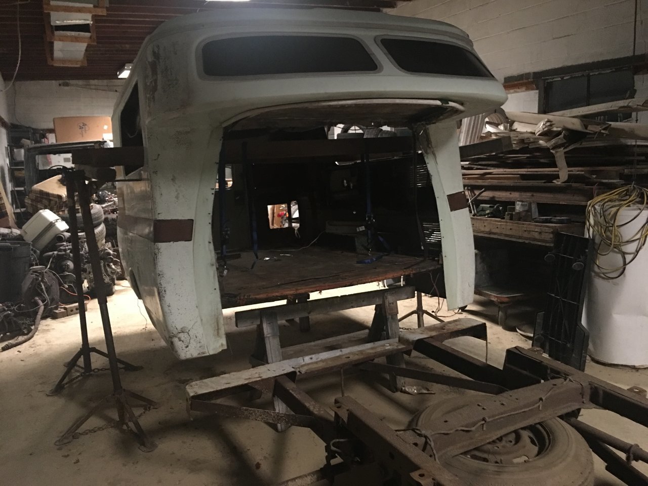

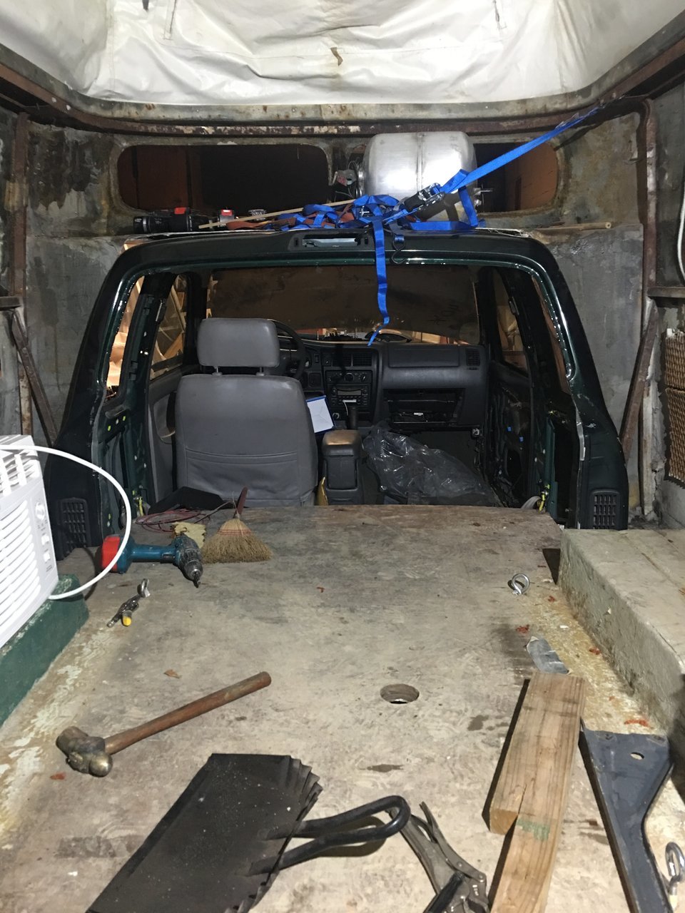

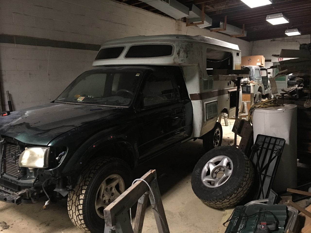

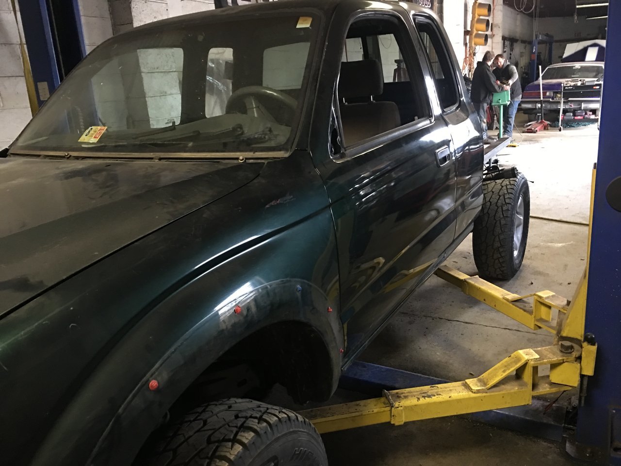

    Upon researching the truck I wanted to use I found out that the regular cab tacoma would place the wheels too far back to be centered in the existing wheel wells. Essentially I would have to shorten the frame, exhaust, driveshaft, brakelines and other mods. I found out that the four door and the extra cab trucks frame were exactly the same lenth (as each other) but would put the wheels too far forward of the wheel wells. That would entail lengthening the frame and the rest. I did not want to do that either. I would have to shorten the box of the coach then but I did not want to do that much fiberglass work either. I already have to do quite a bit of fiberglass work as it is, so i opted to cut the coach and slide it over the cab and reduce the interior by eight inches. I also had to take out the back window and cut the back of the cab out at just the right height to get the floor inside the cab. It was a process of putting the coach on the truck and taking it back off several times to get everything just right. I am going to have to take the thing off a couple more times yet in order to paint the truck and install the water tank under the coach in the truck frame. I am also looking to find a place in the frame for batteries so as to keep as much of the weight as low as possible as well as not take up valuable interior space. The rear frame also needs to be extended about two feet for the bumper and tow hitch as well as be support for the rest of the coach ( only six feet of the eight feet is on the original frame).

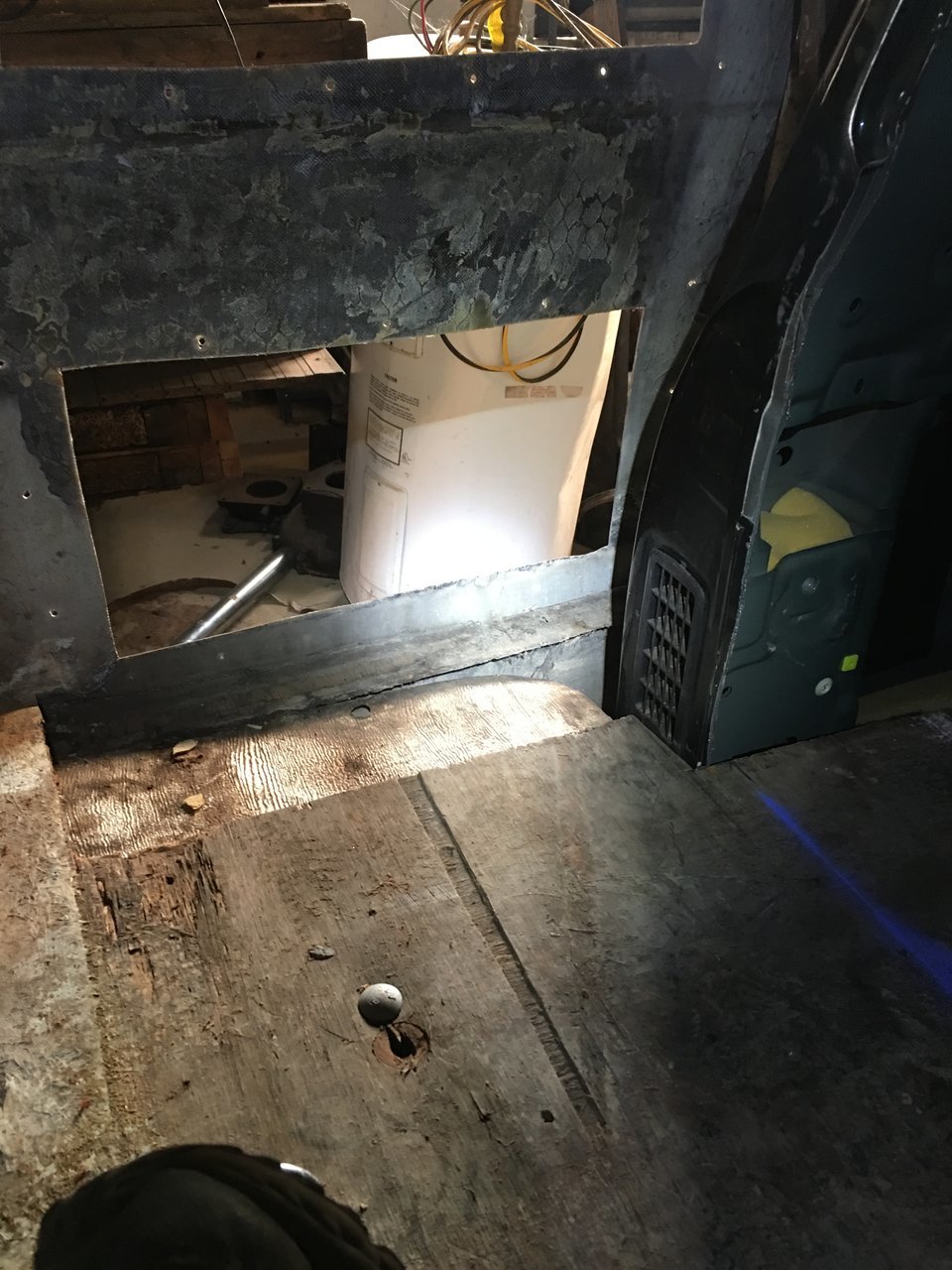

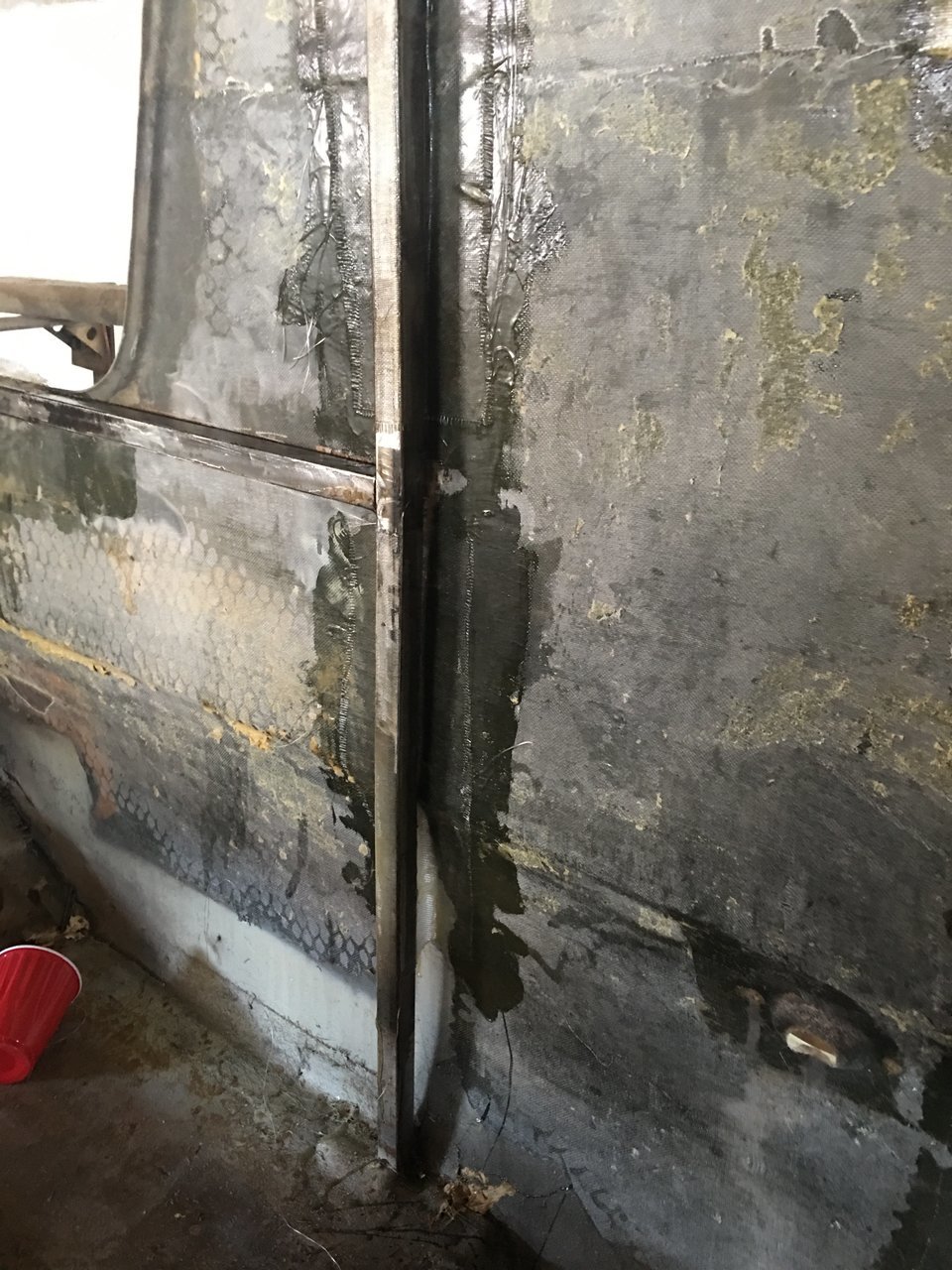

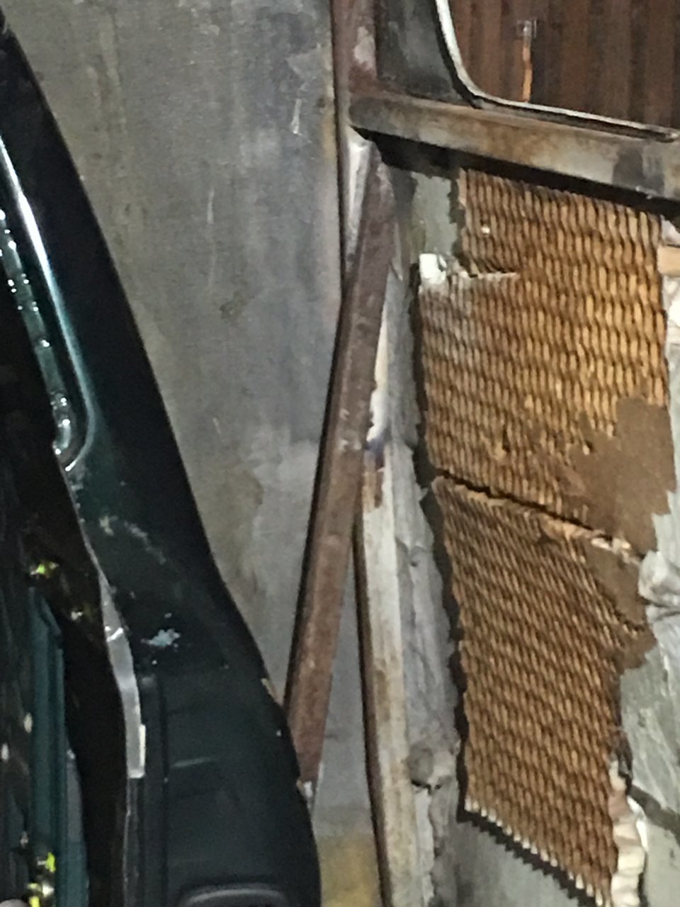

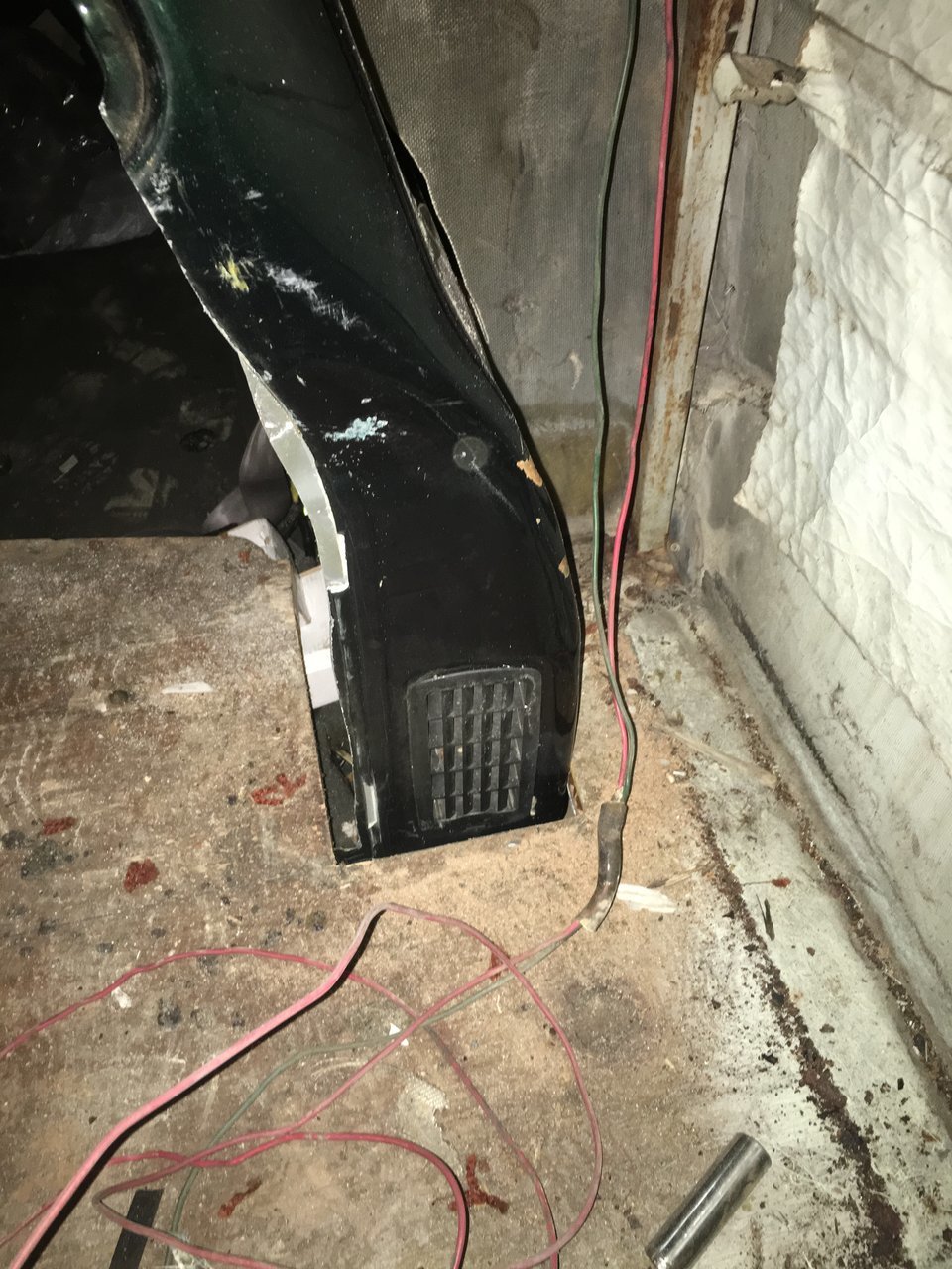

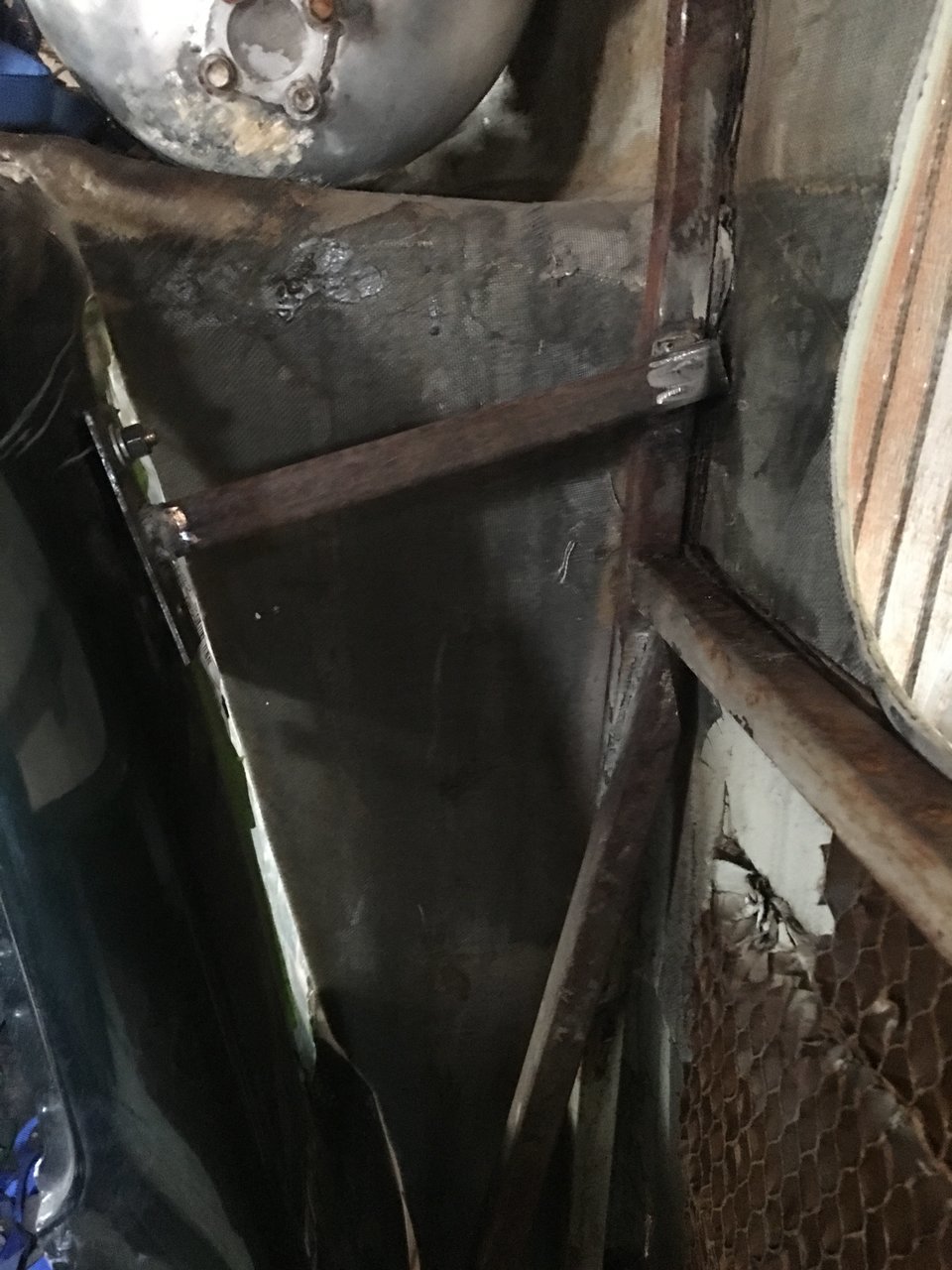

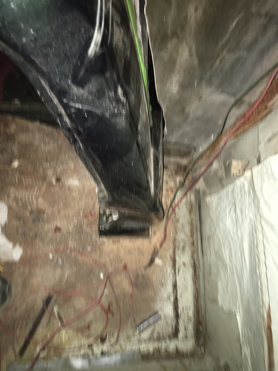

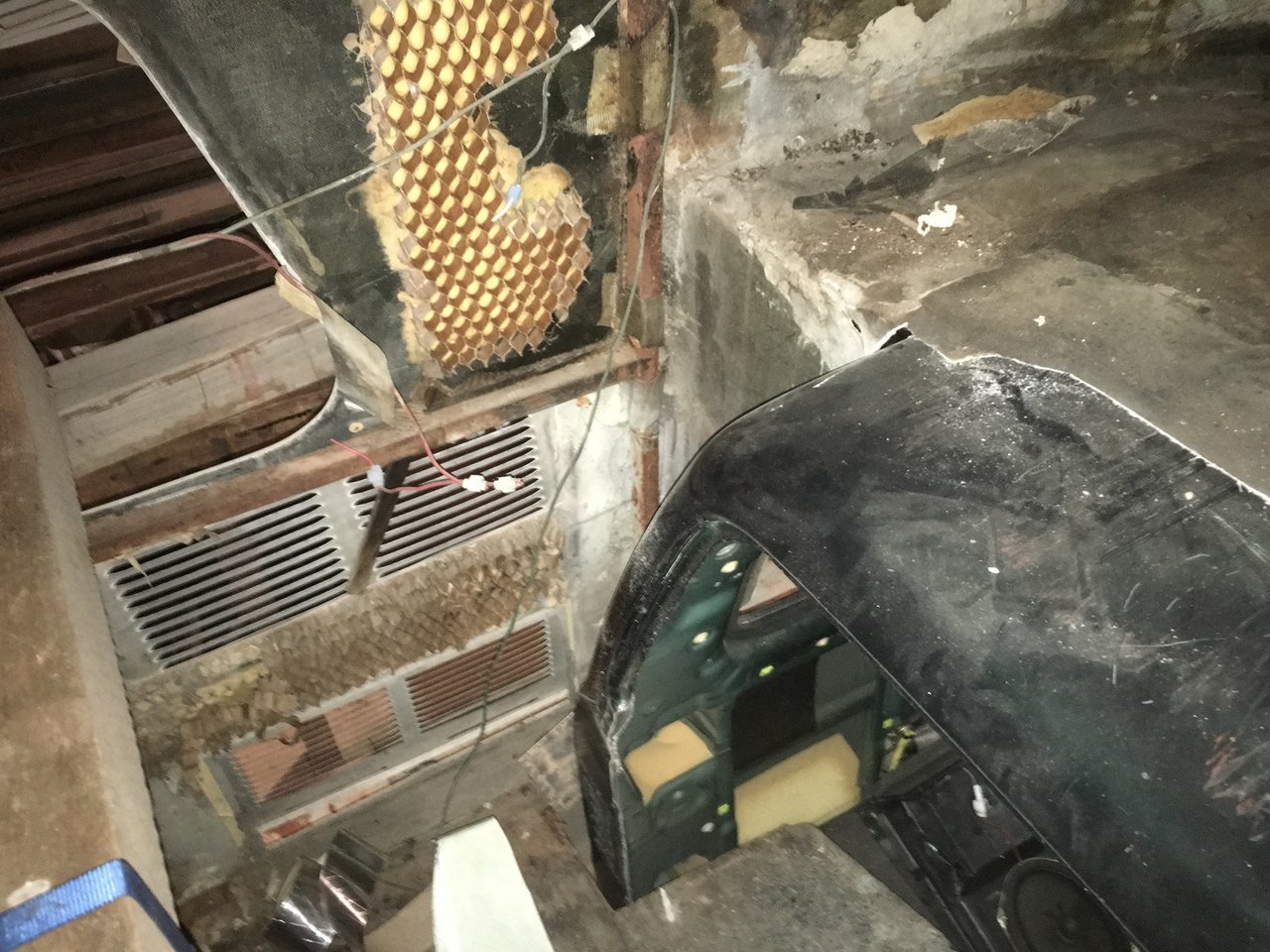

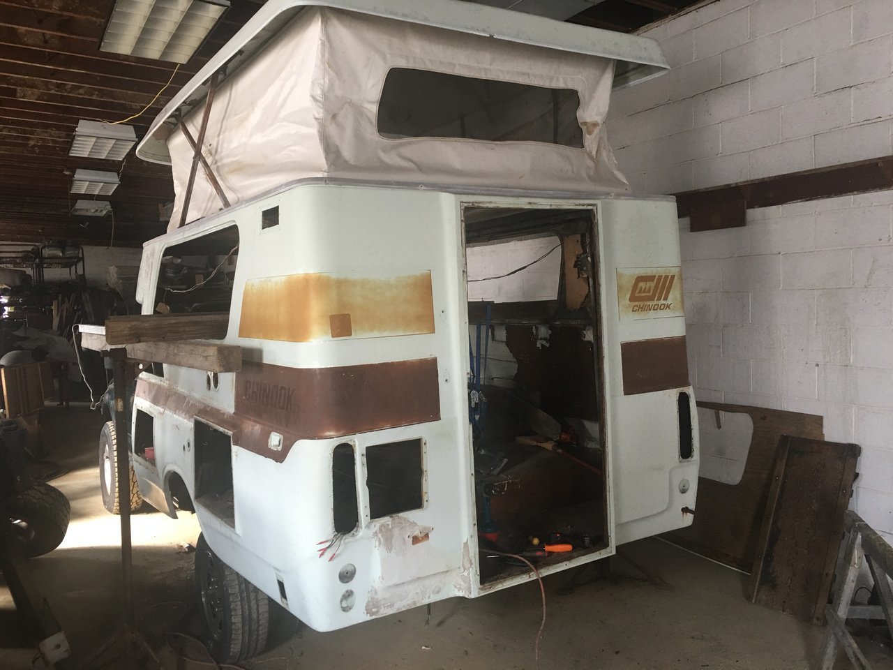

    5F6473D4-0BAD-4E8B-AC82-897B7C72D8CB.jpg E32645F4-81D1-4886-AE5D-999CDEC29BCC.jpg 821196F4-068F-449B-81D7-CFEC723CEB70.jpg Ok, I have cut out the front of the coach to be able to slide it over the Tacoma cab 8 inches. This gets the wheels centered in the wheel wells so that the tires can have ample travel. My floor was in great shape except for an area where water got in at the back of the refrigerator. I will patch the floor in that area but now one of the legs that supports the top has nothing under it. To fix that, I welded a new leg to the frame and transferred that load to the cab of the truck. Did it on both sides since notching out the floor will weaken the floor area on the other side as well.9462181C-0E5C-4996-BD63-3CAE56859A8E.jpg25AAE612-368F-44AE-ACCC-6532FFD9471C.jpg 9AE4A50E-E2FF-491F-887A-F964FA35D1B3.jpgB9ACA7ED-BAF7-48D2-A1FA-9D21A315B40A.jpg 3BA8FCA0-CEAD-453C-A223-8DD0EDBD4876.jpg5F6473D4-0BAD-4E8B-AC82-897B7C72D8CB.jpg

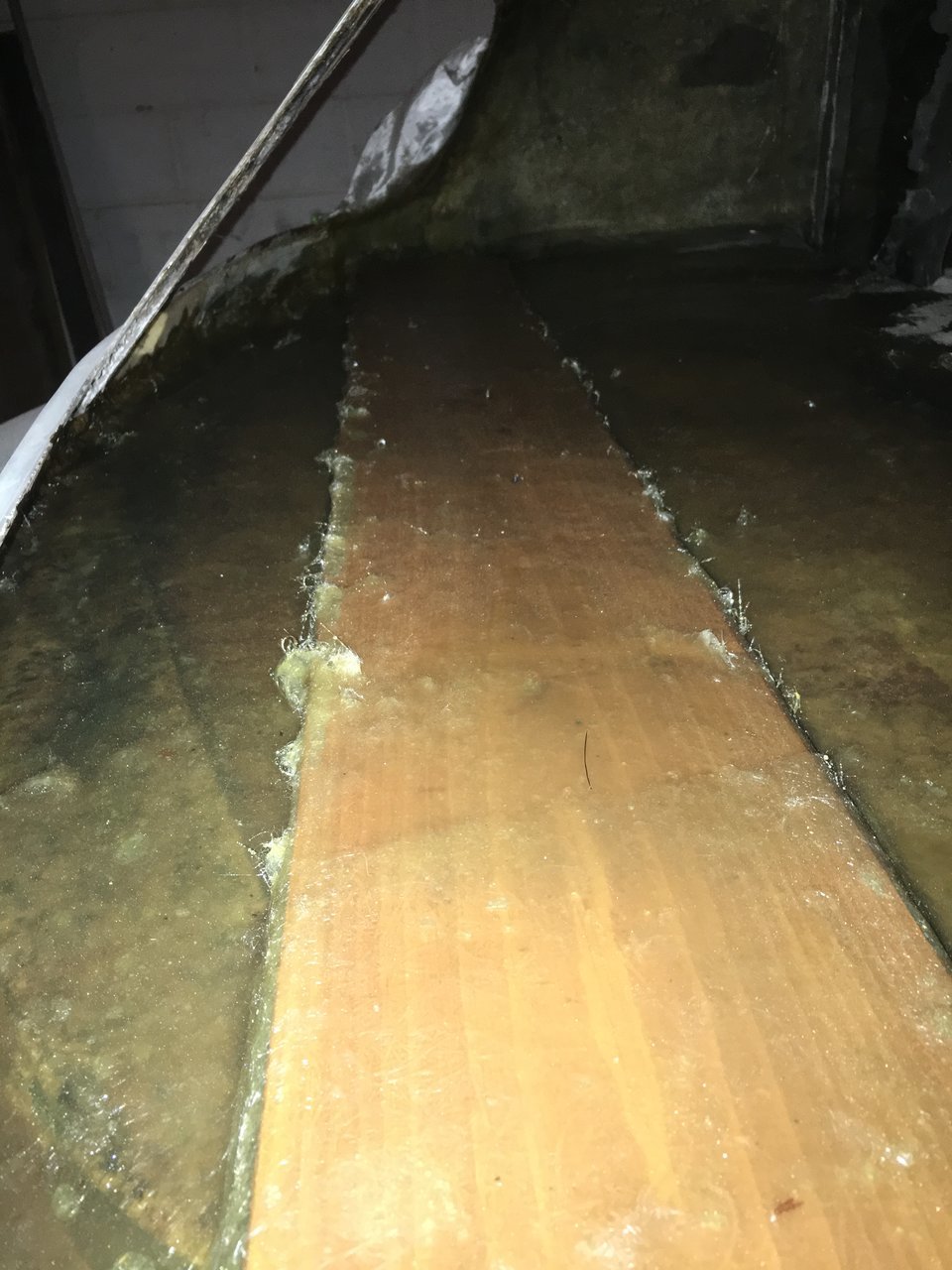

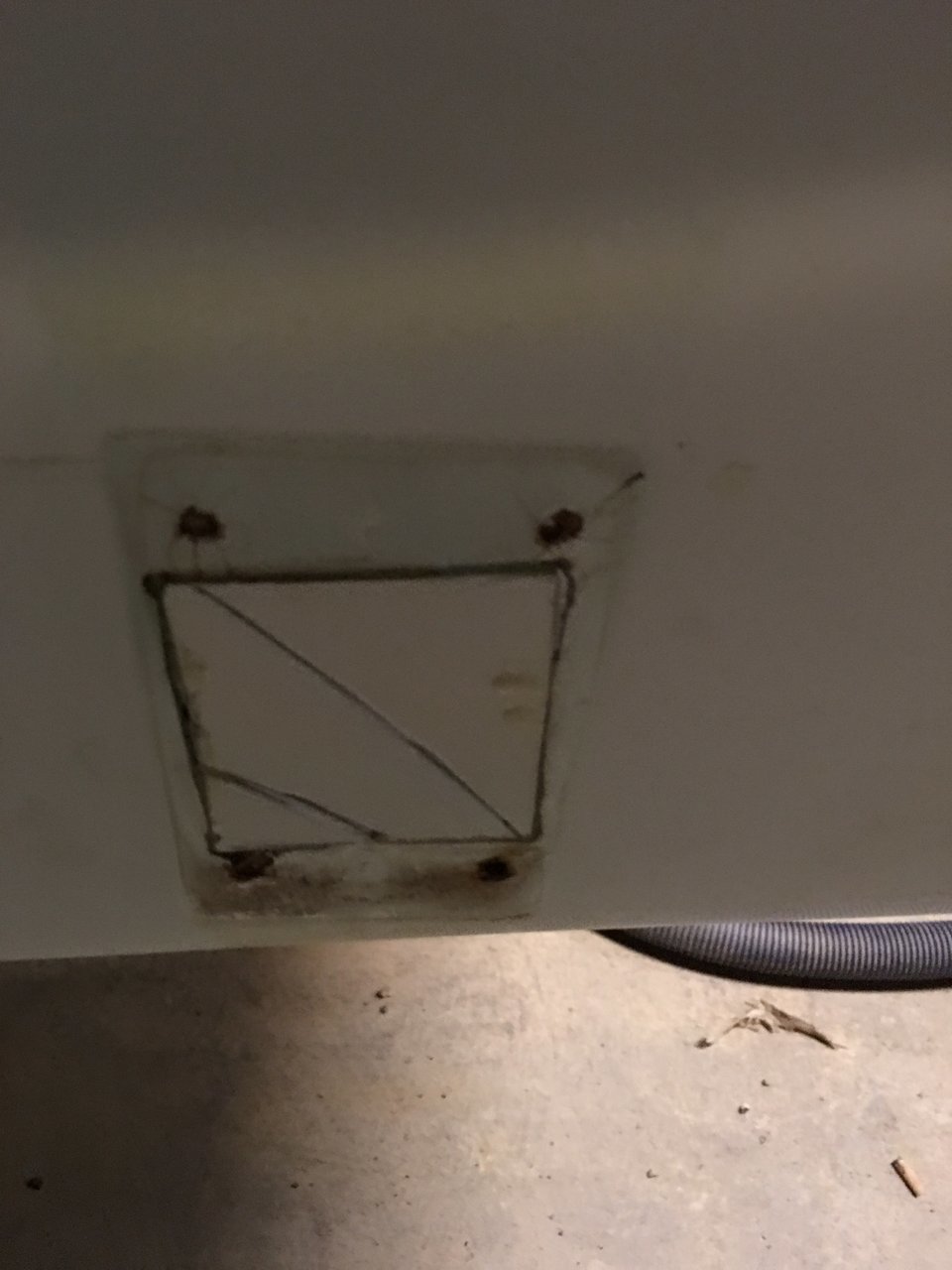

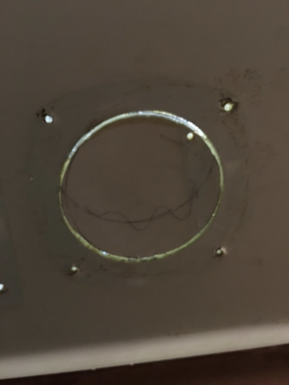

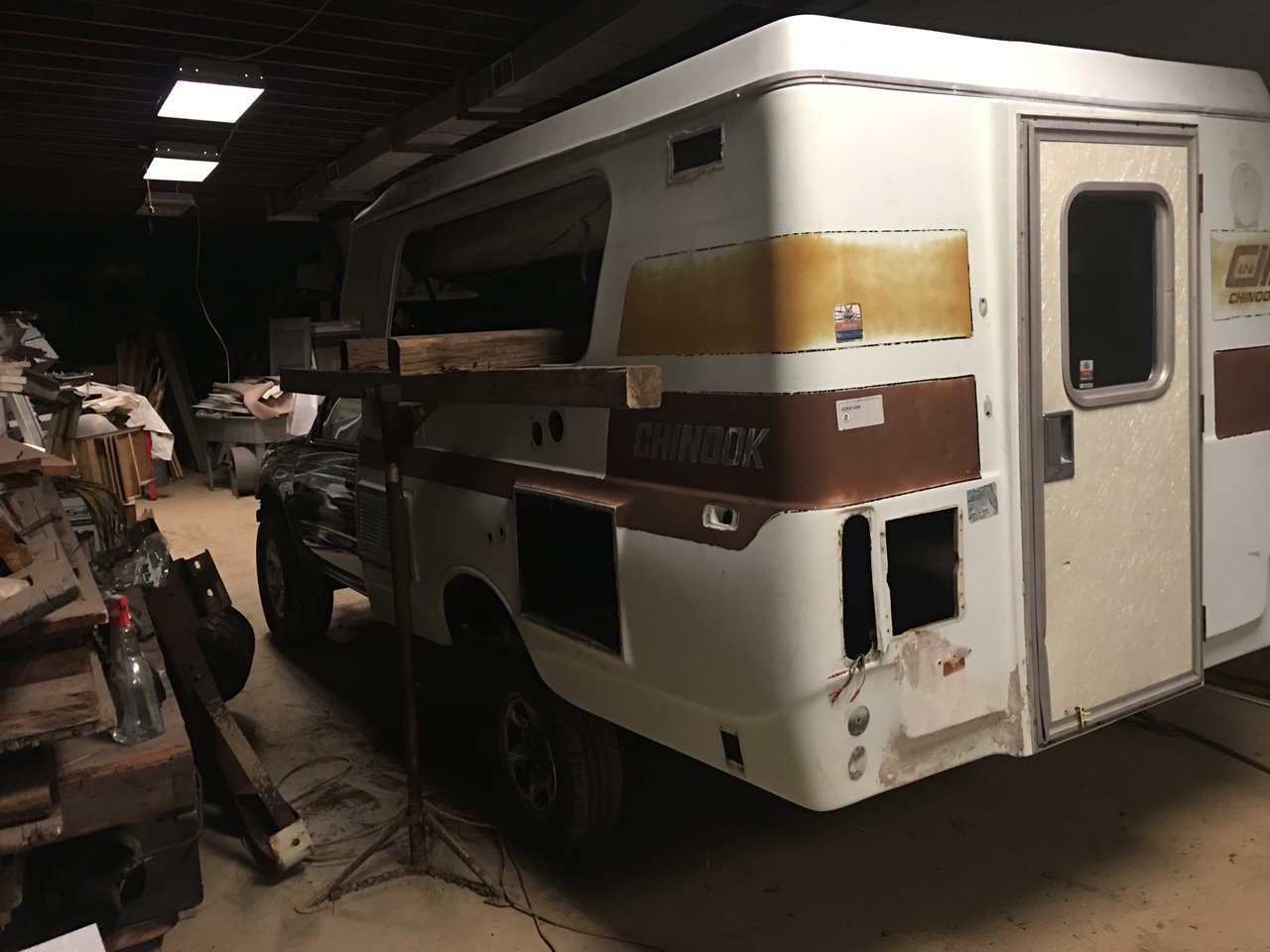

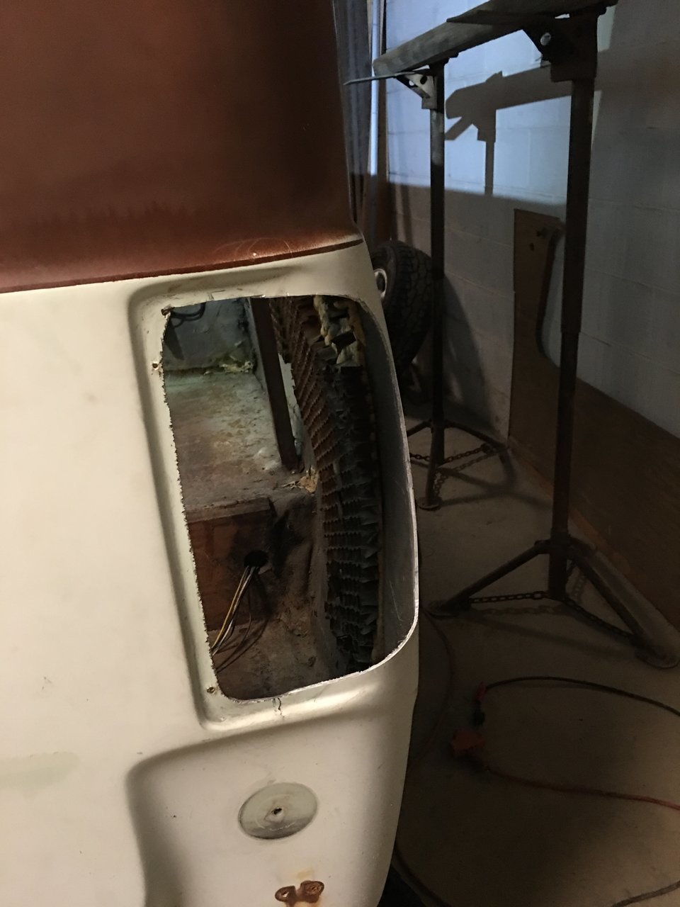

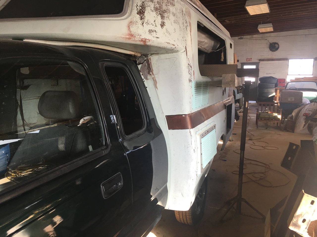

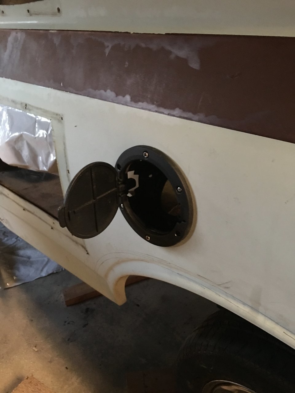

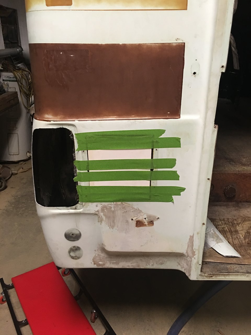

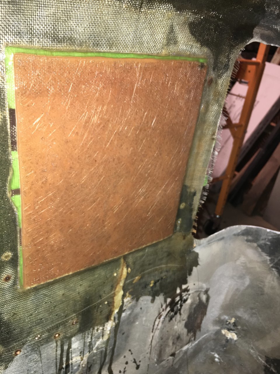

    47C6FDCD-3D68-43C0-BCA2-83D73B23FCD2.jpg E7A739A4-F471-4E5C-869B-691346083CA9.jpg 2BBAEA45-07D8-44A3-B17F-4B786ECA80A2.jpg 77037A72-111B-468E-A892-D9FF7E0EB59C.jpg A69BB78A-A532-4B69-9AED-C44E44E4757B.jpg AFE953D9-ED19-4716-BCBC-F31704392498.jpg 85248FAC-5852-46BB-BB90-1B24CE3415C3.jpg F07061B1-0079-4AFB-87F6-99E0164400D5.jpg 31096C4D-F3E4-4071-9F33-A911DF8B7E22.jpg Have done a some fiberglass work on the floor, cut out a gas door, a hole for the exterior shower fiberglassed in some of the extra holes, rough cut out for the new taillights, fiberglassed the steel frame to the exterior fiberglass walls
