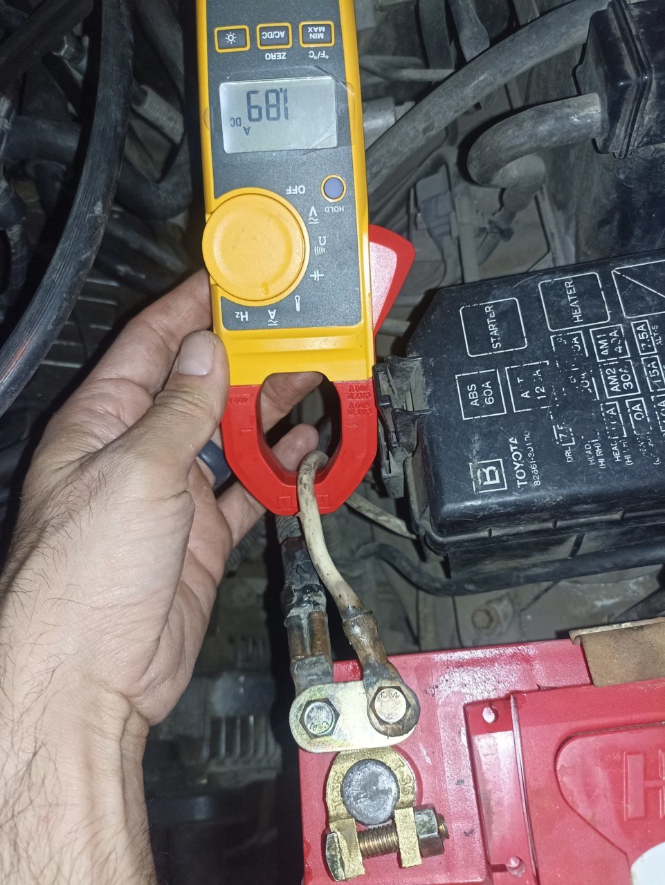

    I have a 2001 Tacoma prerunner 3.4 crew cab. He has been for 6 years. I started to repair it. I already changed the fuel pump, and everything necessary for major maintenance. The engine starts and everything seems to work fine.
    But the next day I found dead a new battery. Take a reading of the current and it is drawing almost 2A on the positive terminal. Remove the fuse from the EFI and the current drops to 0A
    Any suggestions?

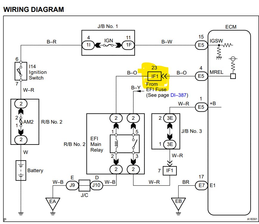

  17. Sep 22, 2023 at 10:34 PM
    #17
    mgerardopaz
    mgerardopaz [OP] Member
    Sep 12, 2023
    #433377
    17
    Mario
    California
    2001 Tacoma
    That's what I fear.
    I did the test with the P5 connector in place and if the MREL is at 0V, but it still powers up. I think the 12V comes from another side

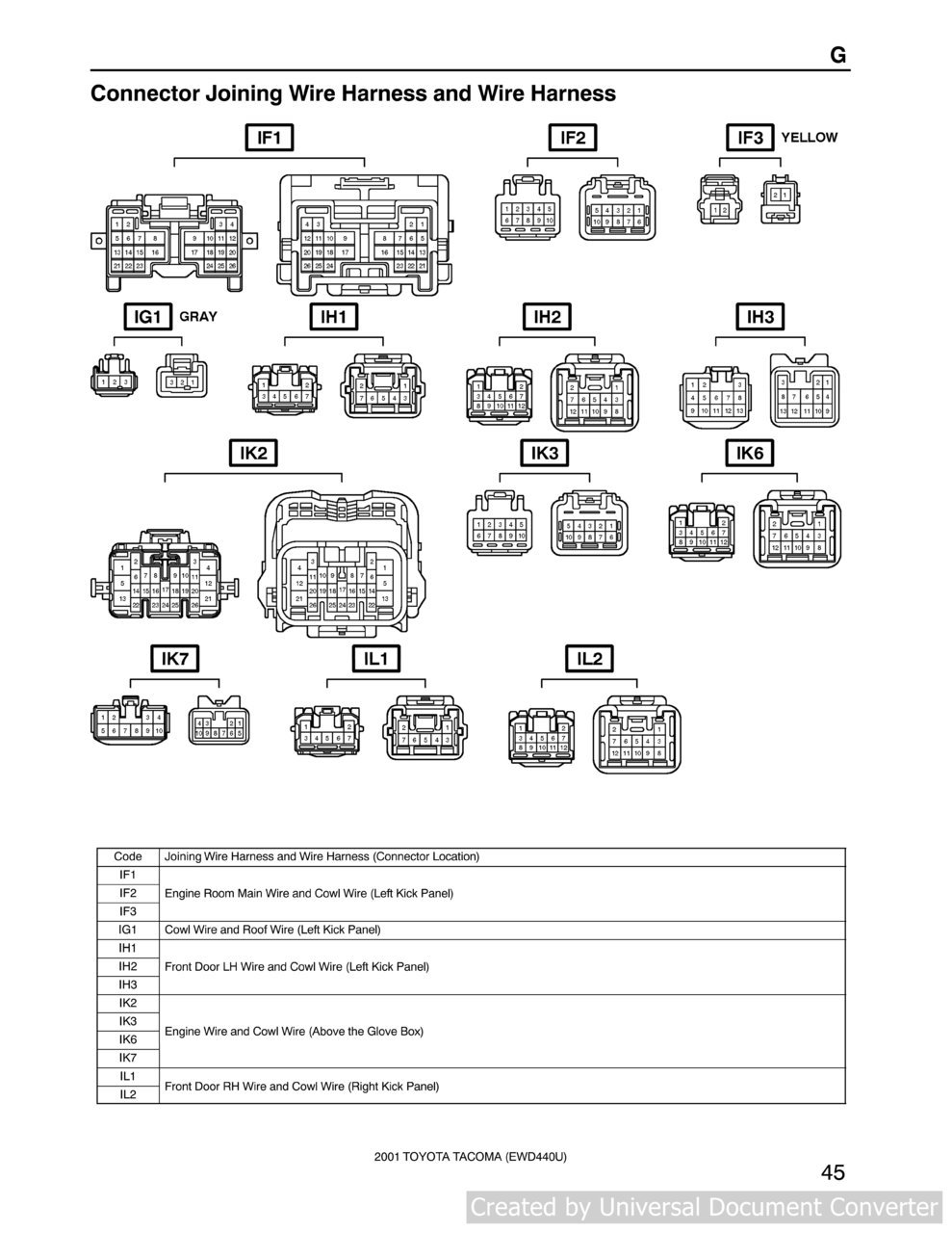

    Do you know where the IF1 that I show in the image is.

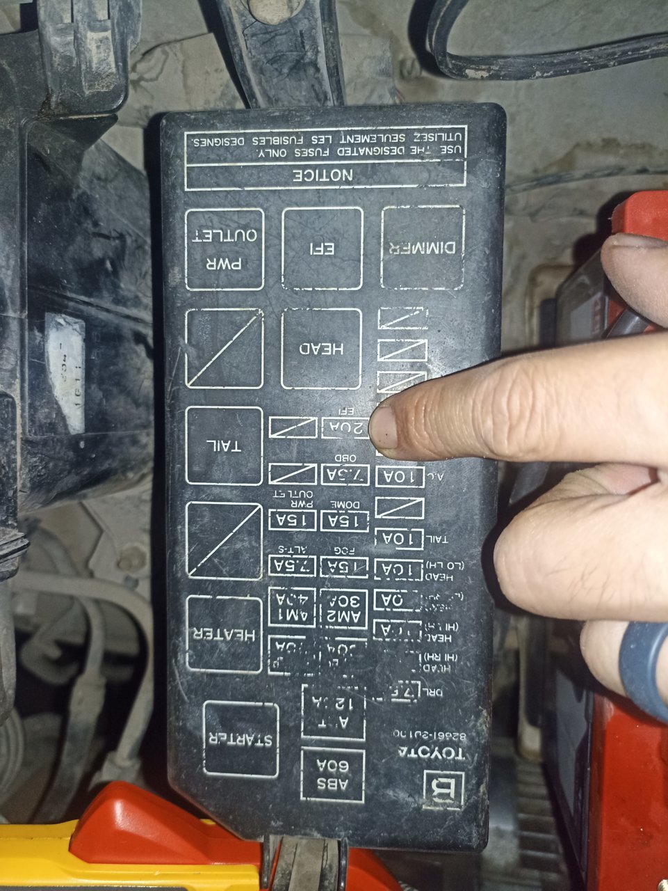

    Pop out the EFI relay with the key off, everything else plugged in and check the pins.
    Pin 1 should be 0v
    Pin 2 should be 0v
    Pin 3 should be 0v
    Pin 5 should be battery voltage
  19. Sep 22, 2023 at 10:44 PM
    #19
    mgerardopaz
    Sep 12, 2023
    #433377
    17
    Mario
    California
    2001 Tacoma
    YES.
    I connected the E5 and measured the voltage again and they are at 0V until I turn on the key, it is the strangest thing, I did it with a pin on the E5-8 and it is 0V, and I turn on the key and it goes to 12V.
    But in the fuse box there are 12 in the EFI relay

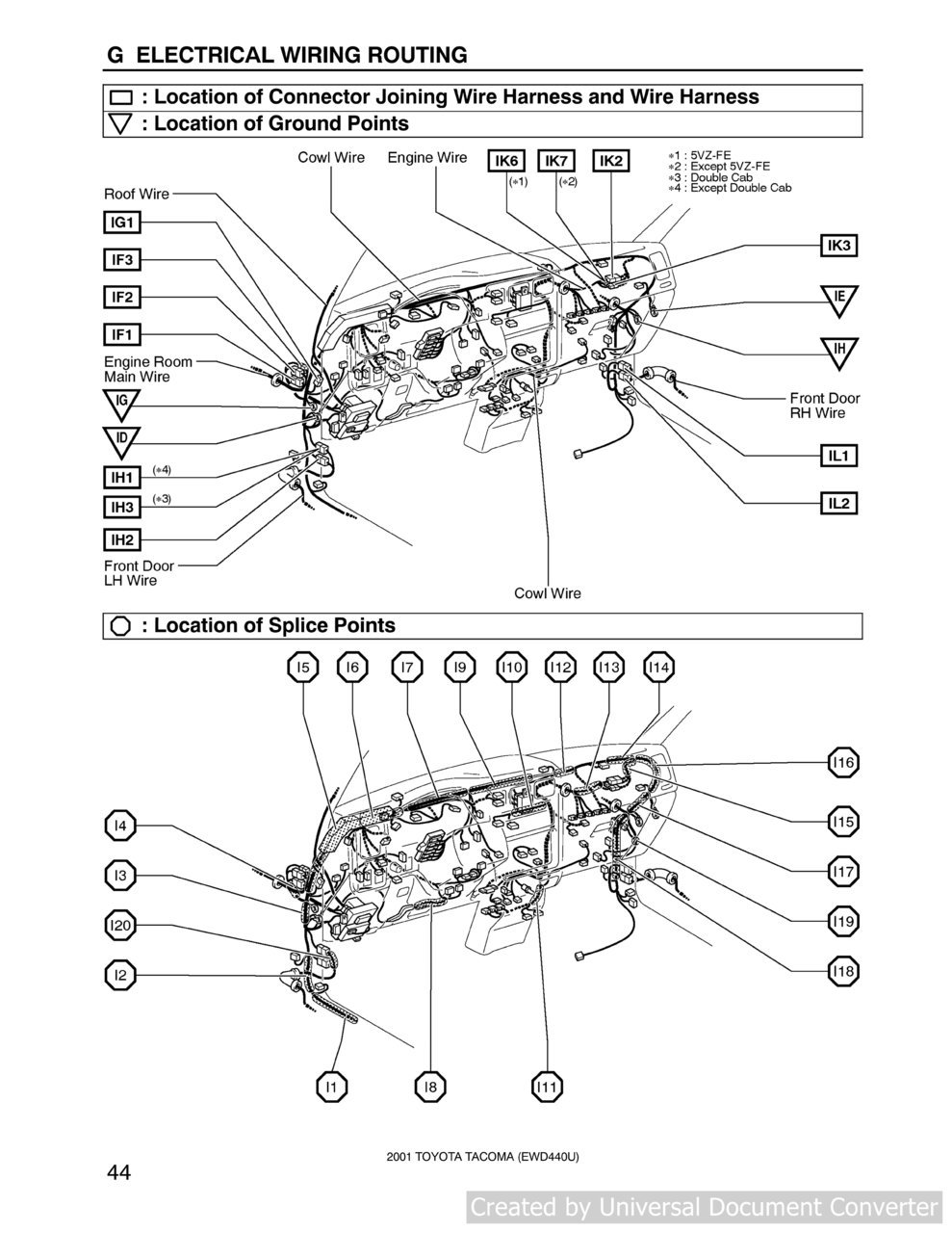

  20. Sep 22, 2023 at 10:51 PM
    #20
    Dm93
    Dm93 Test Don't Guess
    Mar 3, 2015
    #150066
    13,737
    Texas
    2014 DC OR 6spd 4x4
    Predator tube steps, Ranch Hand grill guard, Magnaflow CatBack exhaust, Toyota tool box & bed mat, 2LO Module by @Up2NoGood, Rearview Compass/Temp Mirror, Tune by @JustDSM.
    Looks like it's on the left side above the kick panel.
