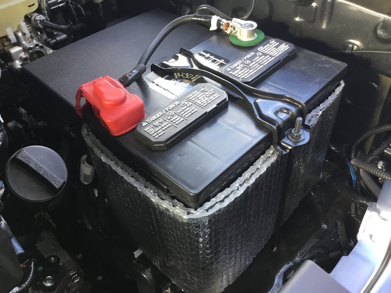

    133DABA4-E92A-4B94-ABA4-A4BDC2D08FBA.jpg AC2A18C3-88BC-4D25-B87B-7CD5AFC9915C.jpg For those in mildly cold climates this might help a little. Could be placed on underside also and might help a bit with heat gain in summer driving also. Of course it comes stock on a lot of vehicles.
    Cheap and easy using left over insulation from Lowes or Home Depot.
