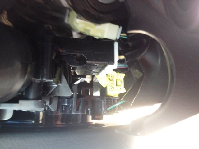

    I took a pic of the under dash cover removed / out of the way
    It does not look like my truck is pre-wired, unless I am not looking at it correctly

    Well, bummer. My heart sunk into my shoes when I originally saw mine like that. Being all OCD I got mad and decided to make it work. CC is one of the most satisfying mods I have done.
    So now you are part way there...

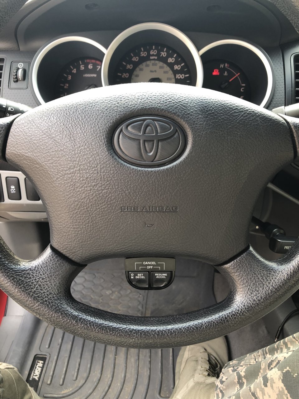

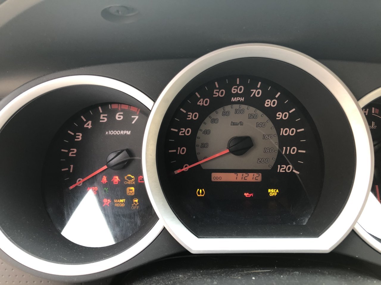

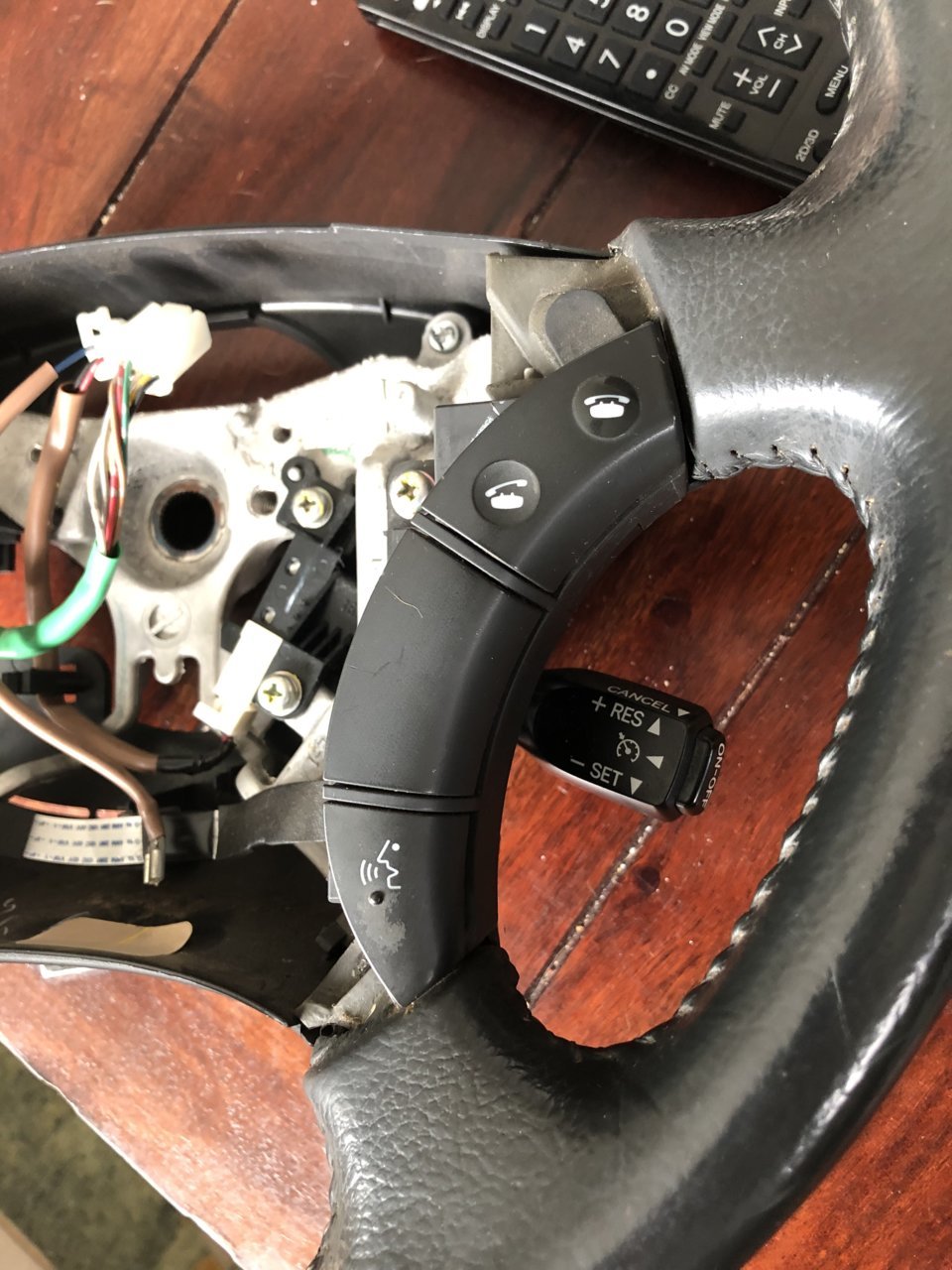

    I bought a used steering wheel that was fully outfitted with cruise and controls so I could retrofit my 09 base reg cab DE3F89E5-CDE6-4639-921F-26FEE9E79125.jpg
    This is what is currently installed. It does have clutch cancel but the light in the dash does not light up when engaged.
    Other than a clockspring and trimming the airbag cover, what else will I need to make the dash light come on?

    No not really. I'm specifically looking how to see if my truck is prewired from the column to the ECU.

    You need to take the new OEM switch out of your donor steering wheel (it has three wires coming out of the plug, 2 run the CC, and one is for the horn), and take apart the wheel on your truck. Then plug in the new CC stalk/horn wire into where you horn is plugged into (and possibly your aftermarket CC is hooked up), and try turning the CC on with the OEM switch. If the cruise lights up green in your dash, your truck is pre-wired.

    All are “prewired” regardless. If you don’t have the extra connector in your clockspring you simply need to take out the one that’s there (it’s only a ground) pull it out of the male connector and insert it into a new connector that has the wires for the cruise. It’s pretty simple
