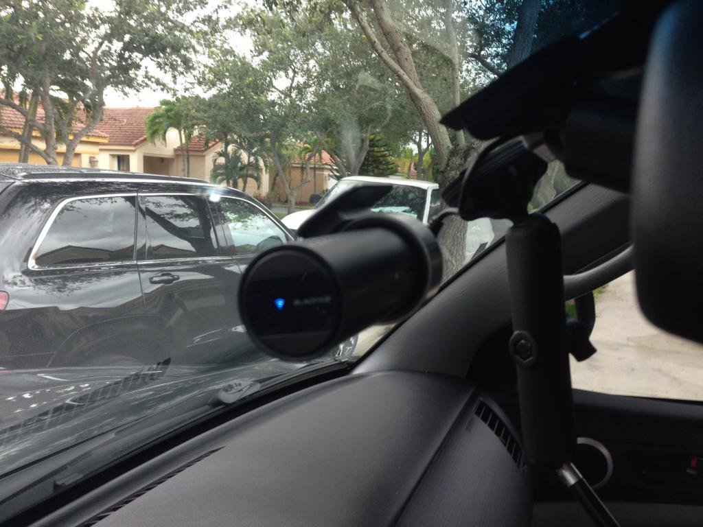

    Front dash cam:

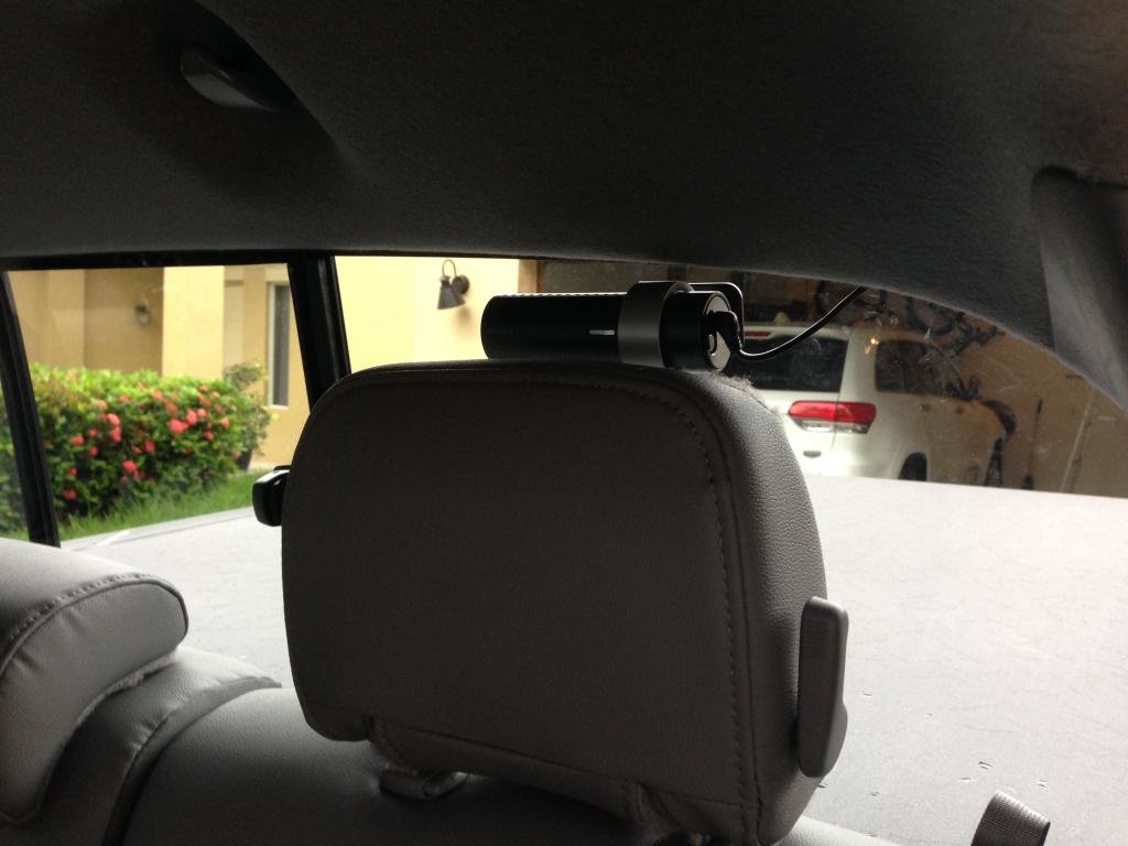

    Rear dash Cam:

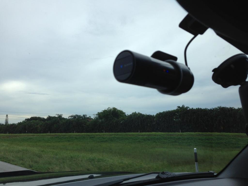

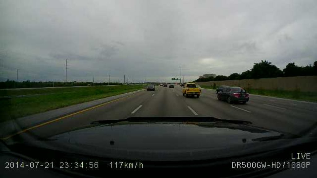

    Front Dash Cam View:

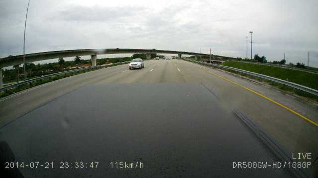

    Rear Dash Cam View:
    If anyone is interested I can upload video footage, the quality is good. The Camera has parking mode and driving mode. When in parking mode I set the camera to stay on for 12 hours. If the controller detects that the battery is below 11.8v it will turn the cameras off to prevent battery drainage. the memory card is 32GB. Once the video footage reaches 32 GB it simply beings recording on a loop and deletes older video.

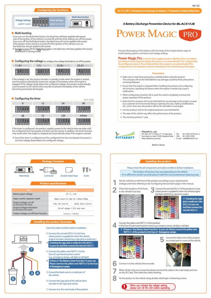

    Here is the manual for the battery discharge that will show you the configuration:
    manual_powermagicpro_en_v102_121008_zps8_0fb241d4f3f4a2cf94531c860d3e5534b833718b.jpg

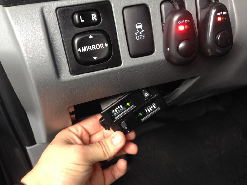

    Used a ton of these back when I was building covert law enforcement vehicles:[​IMG]
    It's not hard to find an ignition switched circuit in the fuse panel, and just add a new circuit with the fuse tap.
