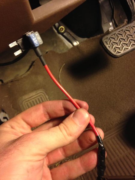

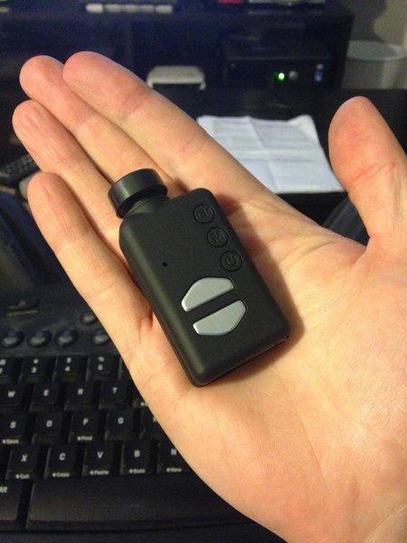

    As promised, here is my setup. (Sorry for the delay)
    This is the Mobius ActionCam type B. Type B is wide angle (116 degrees), and type A is normal.

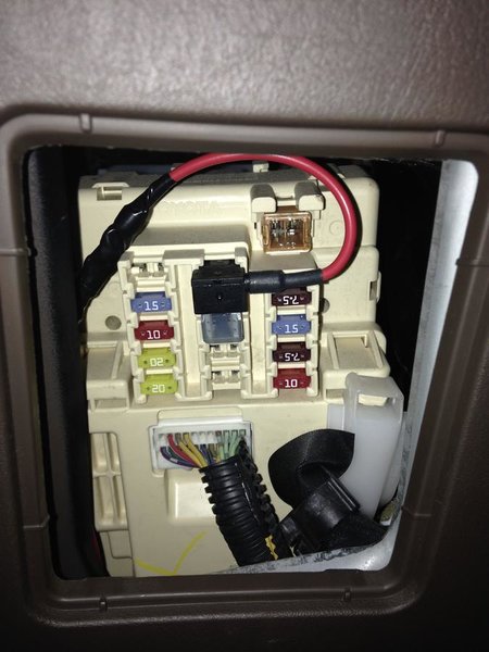

    I also ordered a power connector that allowed me to hard wire the camera into the truck.
    http://www.spytecinc.com/dash-camera-hard-wire-kit.html
    Picked up power at the interior fuse panel and ran a hot wire over to the passenger side kick panel, hiding the box inside the structural area under the plastic cover.

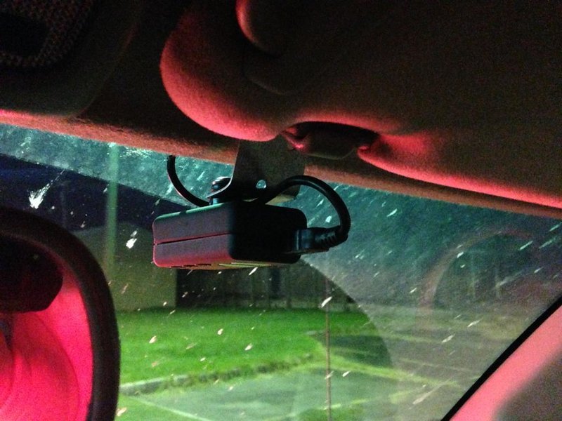

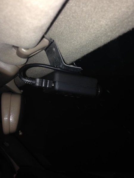

    I had to get rather creative with fabricating a mount for the camera, and went through a couple of pieces of hardware to finally produce the perfect mount.
    Hardware used: http://www.homedepot.com/p/Simpson-Strong-Tie-20-Gauge-1-1-4-in-x-9-in-Strap-LSTA9/202255804
    Final product:

    I think I saw mounting brackets for the Mobius I like your set up but why not use the brackets it comes with.
  11. Aug 23, 2014 at 3:27 PM
    #31
    MedicMutt
    MedicMutt Purveyor of Useless Information
    Oct 2, 2013
    #113680
    792
    Josh
    Baton Rouge, LA
    '03 DC PreRunner TRD OR; '06 Mercury Grand Marquis GS
    OME suspension, Whiteline bushings, Line-X'd Jason topper, GoRhino "Grille Guard", many more...
    I have a background in outfitting police, fire, and EMS vehicles with electronics; and have thusly built up a bit of experience when it comes to positioning and mounting equipment. I saved a few bucks by doing it myself, versus paying for a mount that might not do exactly what I want.
