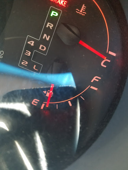

    EDIT: My fuel level sending unit (or my gauge! or both!) was off, so we just ran out of gas!

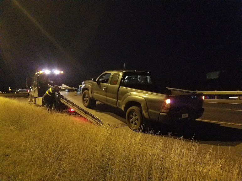

    When the tow truck brought us home, I continued to brainstorm. "Fuel, air, spark.... timing!" Of course, I do not have a timing belt, I had a timing chain, so if that were to have stretched (heaven forbid!) I would maybe see a cam sensor code, or if my crank sensor dies, that would cause the truck to stop running for sure! I grabbed my scan tool. No codes were stored, and I had an accurate RPM signal.

    Not trying to sound like a smart ass here, but do you have fuel? It's possible your gas gauge is inaccurate and you ran out without realizing.

    Thank you!! No, you are absolutely right. I do not know. This is technically my husband's truck, though I drive it occasionally on super hot days (my beloved daily driver doesn't have A/C). BEfore you even replied, I had updated the thread with a photo and a question: is this too low? He says he has run it lower before, and that he believes he has run it low enough on fuel to make the fuel light come on. I have never witnessed this, as I never let it get this low when I drive it, I know its not good for the fuel pump. As far as I know, we could have a fuel level sending unit failure! I am not 100% on this.

    Going off your pic, and experience driving my 08, I would expect about 20 miles of driving before low fuel light came on. I have routinely taken my vehicles down to E and never experienced fuel pump issues in 40 years of driving. But, maybe I've just been lucky (knock on wood).
