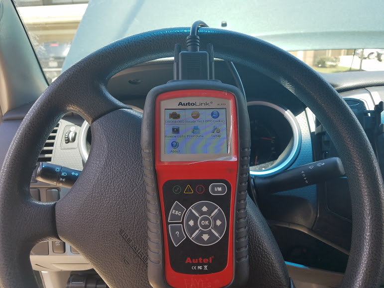

    Posting on behalf of my husband's '09 Prerunner
    RSI SmartCap, Ironman4X4 heavy duty suspension, awning and rooftop tent, solar panels, full custom kitchen set up, Black Rhino Armory wheels wrapped in Hercules Ventures. Full build coming soon to All Girls Garage, season 11, episode 9, airing 8/27/2022!!!!
    Just a basic OBD2 scan tool.

    Does it have to have the ability to read live data?
    The one I have just reads codes, nothing else.
