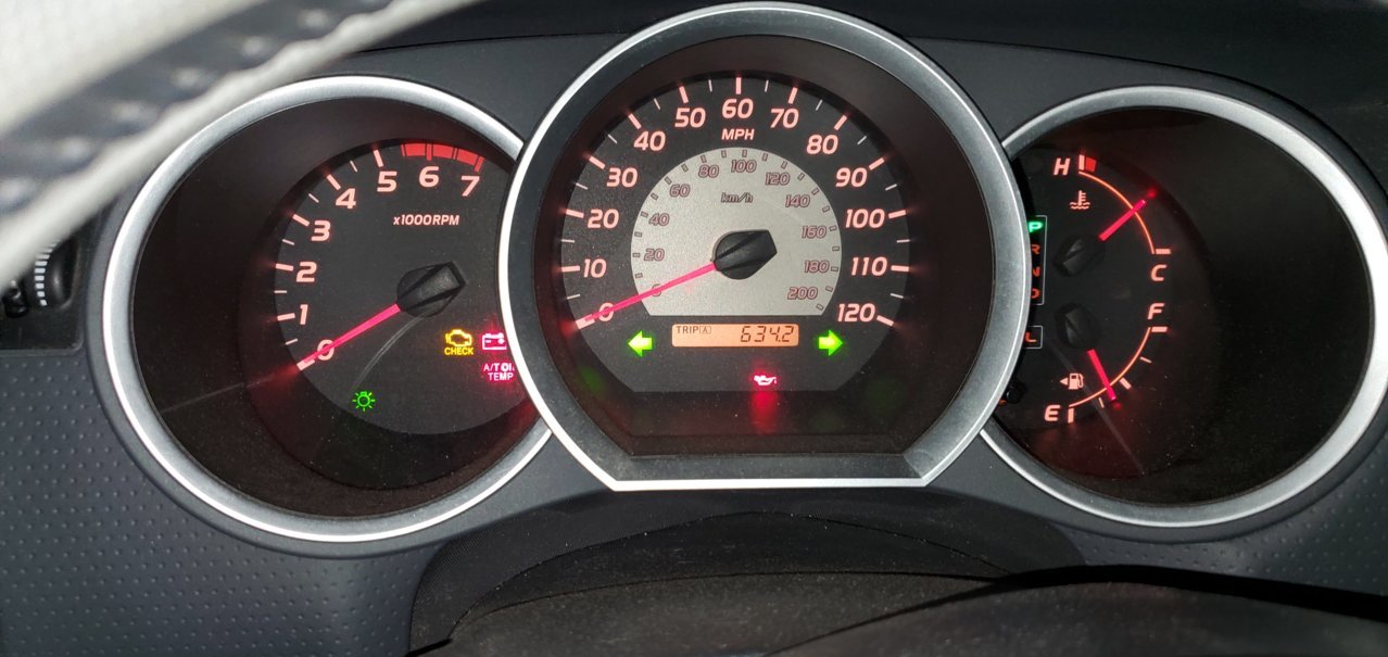

  20. Aug 19, 2022 at 5:12 AM
    #100
    DAROOT
    DAROOT New Member
    Aug 19, 2022
    #403894
    2005 Toyota Tacoma 4D 4WD TRD
    My 2005 Tacoma Dbl cab v6 died on the way to work this morning. Gauge read almost 3/8 tank. Got fuel into it and started up. Topped off at 22 gallons and she reads full again. I have had truck since 2011 and taken guage down to the bottom line with the low fuel light on before. Usually go just below a quarter tank. Assuming its a float/level sensor issue. Will run some Sea Foam thru it when I get next fill up.
    Any other advice about guage/float?20220819_061650.jpg
