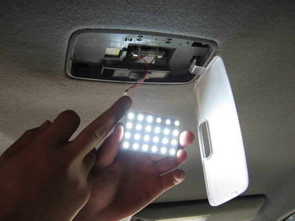

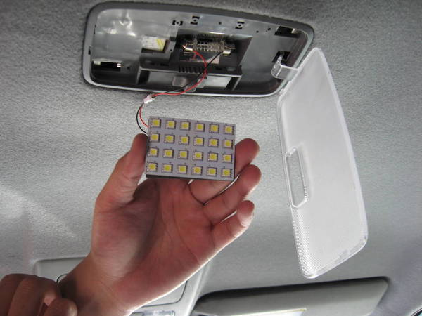

    Hey all, so today I paid a visit to LJ24 and picked up his interior LED Kit that he offers. I also have some pictures to show the installation process a bit.
    Step 1: To install the dome light use a flat head screw driver and pop off the cover from the drivers side where the notch is (It will then hang like in the picture) make sure you are delicate when you do this so you don't scratch the plastic!! Then easily pull out the bulb then insert the new one.
    Step 2: After testing to make sure everything is plugged in correctly use the provided 3M tape to stick it to the center of the dome area and re-snatch the light cover back and it should look like this when it is dark:

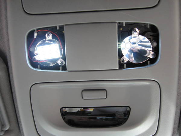

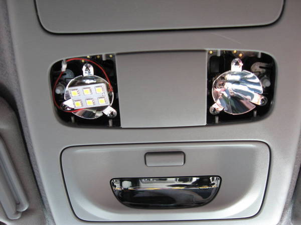

    Step 3: Moving on to the map lights (Driver and passenger lights) easily pry with a flat head screwdriver on the outsides and pop the light covers off. Make sure you are delicate when you do this so you don't scratch the plastic!!
    Step 4: Remove OEM bulbs delicately and then install the new lights. If you bought the basic kit just install the 5SMD led map lights and test, and if you bought the stage II kit install the bulb and test then 3M tape the panel however you desire.
    On the left is the Stage II option, and the right is the base model bulb that LJ24 offers.
    Step 5: Once the LED bulbs/panels are installed how you like just pop the map lenses back on just like you got them off. Then your map light should look like the following picture with the proper package selection.
    Here is a picture comparing the two options side by side showing the difference in brightness.

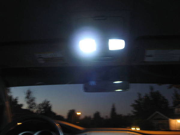

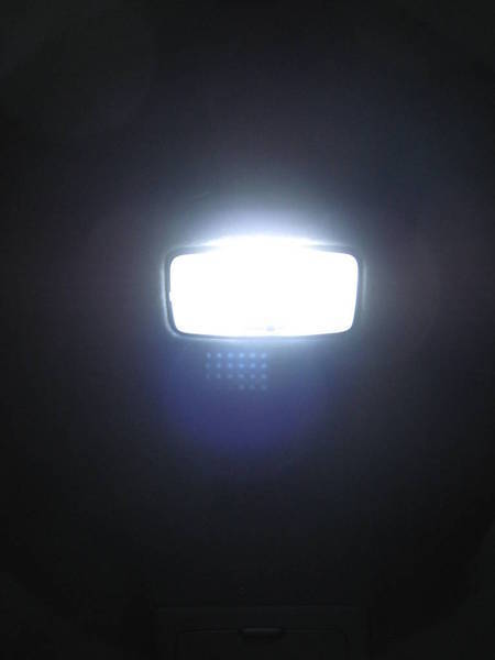

    Hello again, the following picture are using the interior LED kit that LJ24 offers.
    -In advance I do apologize if some picture aren't quite focused, I shut the flash off to take these pictures and my camera had a hard time.
