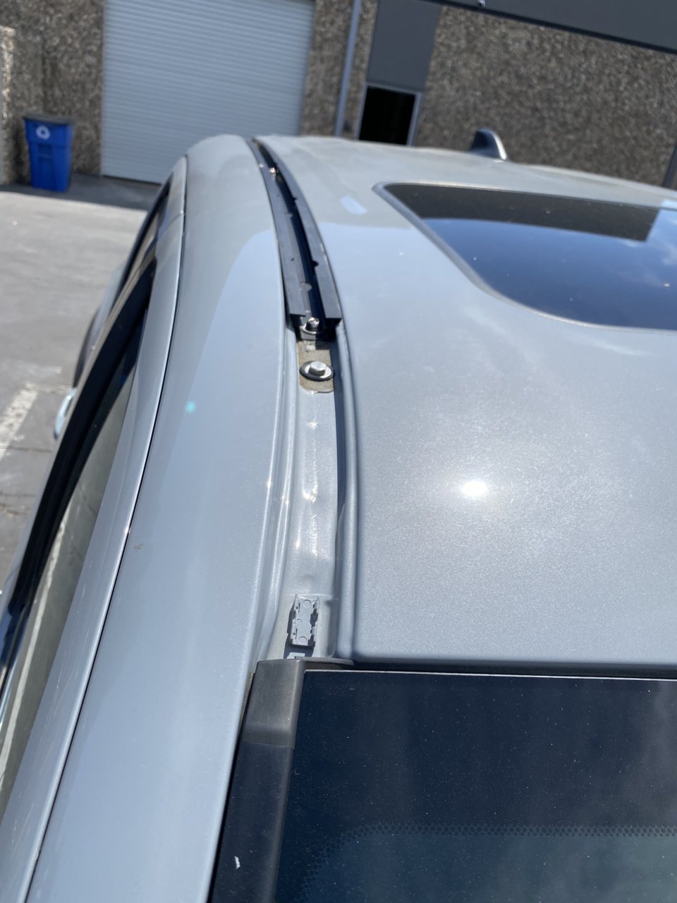

    Anyone have a moulding alternative to the OEM option? I have a rhino rack track that calls for me to cut the OEM piece and I refuse to waste almost $200+ if I decide to sell the truck ever

    Just cut it, and then if you sell the roof rack, include in the deal that buyer need to swap your moulding for theirs. Or hit a junk yard and pull one off a wrecked unit. The other option is just cut it, save it and if you decide to ditch the rack, use a butyl glue and glue the section back in, hit it with a tire cleaner and it will all look brand new again. No big deal. It's up high enough no one would ever notice a couple glue lines on the moulding as it sits down in the groove of the roof.

    If it helps, when I traded in a 4runner a couple years ago I had a roof rack on it that I built and had to hack the moulding up. The dealership liked that it had a "custom roofrack" they can mark it up and sell if for more because it has some aftermarket accessories on it. The chances of anyone ever seeing it are slim. the other option would be to just run the rhino rack without the moulding altogether. It doesnt affect the weatherproofing of the roof in anyway as water just runs under it anyway. You could always go get a roll of bulb seal and make your own molding that fits the the rhino rack. Only thing I would suggest is if you do run without the moulding, throw a good thick coat of wax down in that groove as the paint and clear coat under it typically are thin and shitty anyway. I cut the moulding on my wife's 2021 T4R TRD PRO and when I pulled it from the channel you could see the primer in some spots. they stick that moulding in when the paint is still soft.

    I haven’t checked Rockauto yet. Maybe I should also state that I’m looking for something to hide wires under too. The OEM moulding would work, but I’m curious if there’s anything else that allow multiple wires to sit flush underneath. I completely forgot to mention that bit
