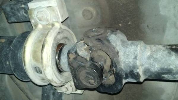

    [​IMG]here's a photo of them they are on the side of the U-joints 5 total the front drive line you have to take off a guard to get to it other wise you will miss it.

    there's only 5 total grease fittings for 2005+ and up good grease to use is some moly grease.
