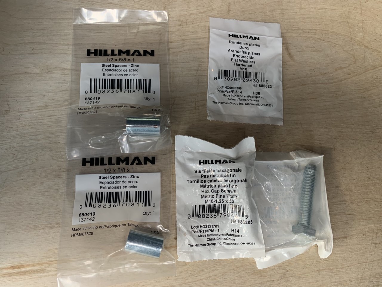

    Hey = New Member here in Central Texas - just purchased 3rd. Tacoma D-Cab since 2001 - need ideas on making driver's seat a little higher; saw something on Internet about shims / longer bolts for rear seat anchors - looking for other remedies w/o going to aftermarket seat?

    Welcome to TW! One of the spacer mods is about all you can do to raise the seats.

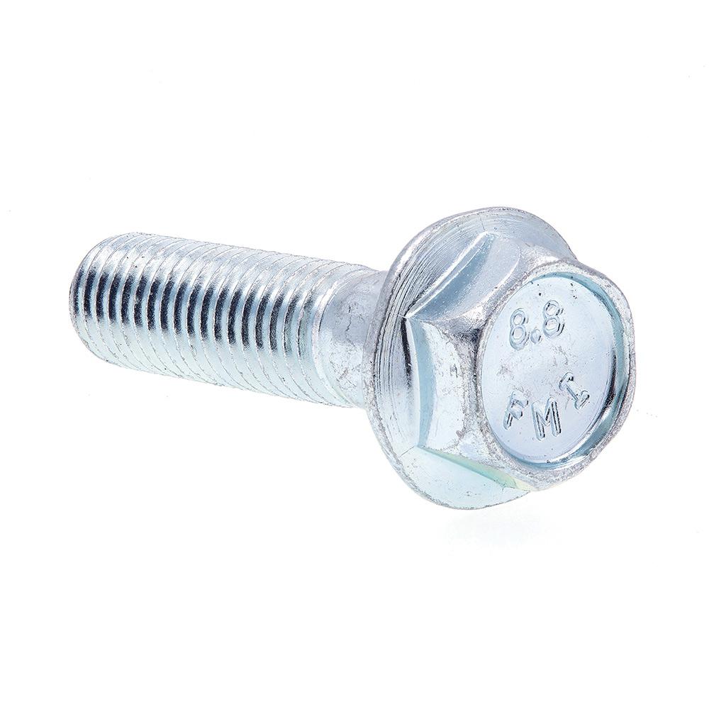

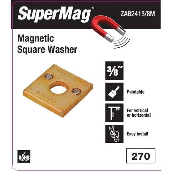

    A cheap way that allows you to adjust height quickly by adding or removing washers. For rear mounts only.
    Home Depot $16.06!
    2ea. (5 pack) @$5.75 3/8 in. Square Strut Washer
    2ea. @$2.28 Metric Flange Bolt M10 1.25x40mm
