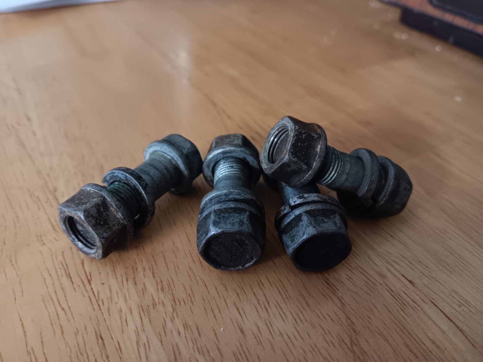

    Some asshole crawled under my truck and stole the driveshaft yoke on the rear diff side. Bad news for him is there's like 4 different styles depending on spline count so it probably doesn't even fit his truck... Good news for me is I happened to have a whole spare driveshaft.
    What I don't have is the bolts. I pulled the parts numbers and could order them but I'd rather not pay out the ass and have to wait on shipping.
    If I remember right these are just four bolts with a lockwasher and nut. Is there any reason not to just go to autozone or the fastener store and buy some 10.9 grade bolts? Toyota wants $12.86 EACH for the bolt/washer/nut...
    Anyone know the sizes?
    Part numbers below:
    Bolt 90080-10294
    Lockwasher 90560-10H00
    Nut 90080-17239

    I have a whole bunch of them at home, they're an oddball thing cause they're ultra fine thread, M11x1... you read that right. I can see if I can rustle up a full set for you and send em out of what i have. Have a few 4wd trucks worth I think

    Lol damn that is weird thread. Man that would be amazing if you had a set, more than happy to pay you for em too! I did find some online from a couple of the 'yota shops but I'm stuck either waiting on their slow ground shipping or paying an extra $20 to expedite a couple of bolts.
    It does look like there's a 10mm version sort of randomly on some trucks, I'm gonna grab a caliper when I go by my shop in a couple hours and check the hole size.

    Looks like these are the 10mm x 1.0 if you have any. If not no worries!

    I found a set of 4, message me a name and address and I'll pop em in a bubble mailer to ya this afternoon

    Do you have a couple more of these? And if you do, would you mind parting with them and how much? A couple of mine are rounding the flats on removal. Thanks

    Just pop one out, measure them, and hit McMaster-Carr.. They'll have 'em at your door the next day...

    Huh, how about that. That's the first I've heard that these could be sourced elsewhere. All discussion I've seen is that they're pretty unique and stock ones are the way to go.

    They’re m11x1.0 and not m10x1.0
