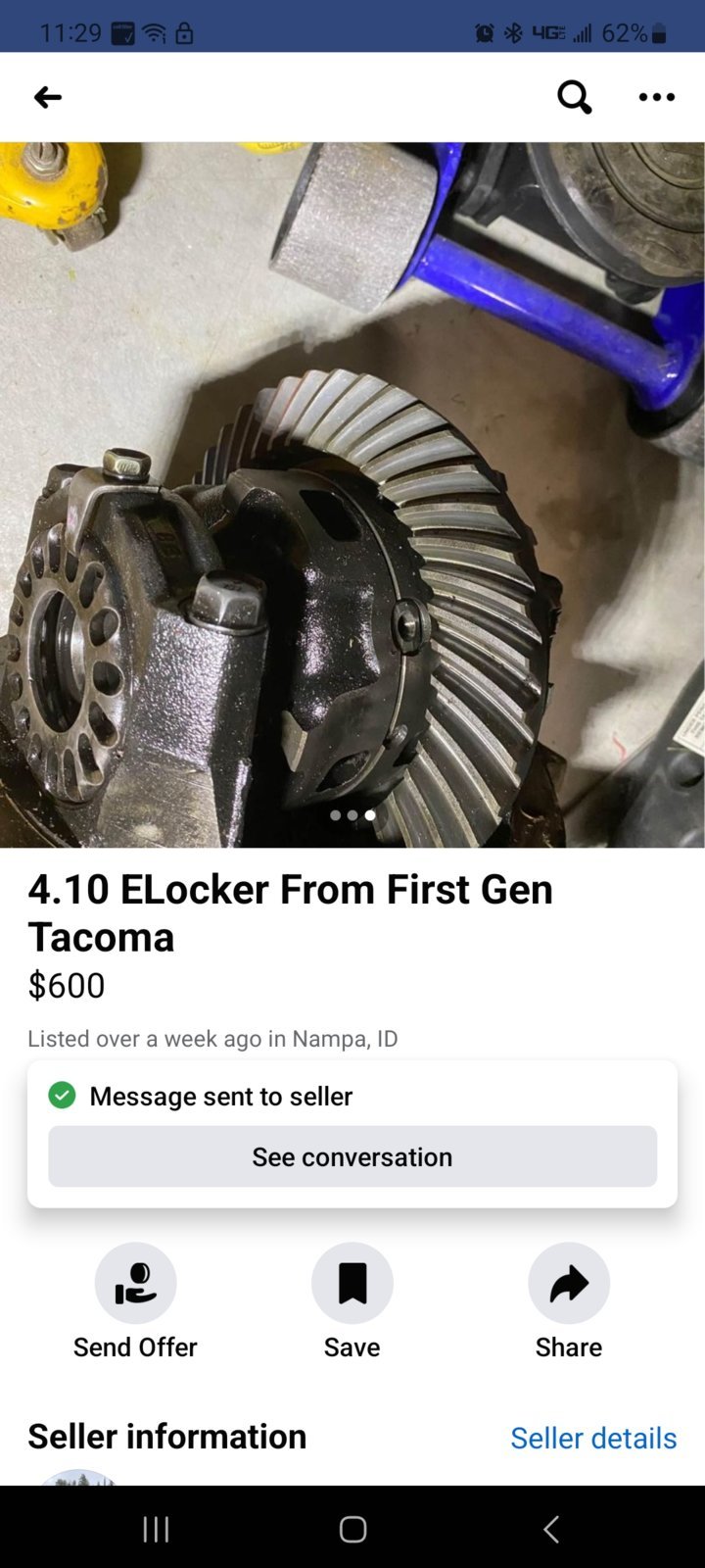

    Okay so I have a 97 tacoma and I picked up an e locker out of a 1st gen tacoma. I saw that with a little fab work I should be able to make it work in my stock housing. I'm open to some input. have you done this before? does it not work? is there some kits available that make this easier? open Screenshot_20231019_112925_Facebook.jpg 20231011_173425.jpg Screenshot_20231019_112925_Facebook.jpg discussion tell me what you know!!

    If you only got the 3rd member you're gonna need the rear axle/diff carrier assembly to have somewhere to mount the locker actuator up too. Really doubt the non-locker carrier could be fabbed up to fit the e-locker diff, at least not easily or more cost effectively than just buying the rear axle assembly and swapping it.

    I tried going that route, and ultimately it was too much money and work to justify using stock parts. I went with an Eaton E locker and have been extremely happy since.

    I haven't seen anyone retro an 8" elock third member to a 8.4" housing. Keep in mind, tacoma do not have an 8" open third like the earlier 4r/pickup.
    Best bet is to buy the entire rear axle assembly. Locally, can be had for $6-800 complete.

    It is possible. Make sure your gears match the front. You have to weld up the sealing surface on 1 corner and then drill and tap a couple of holes to add a couple of studs. Not impossible if you have some time and a welder.

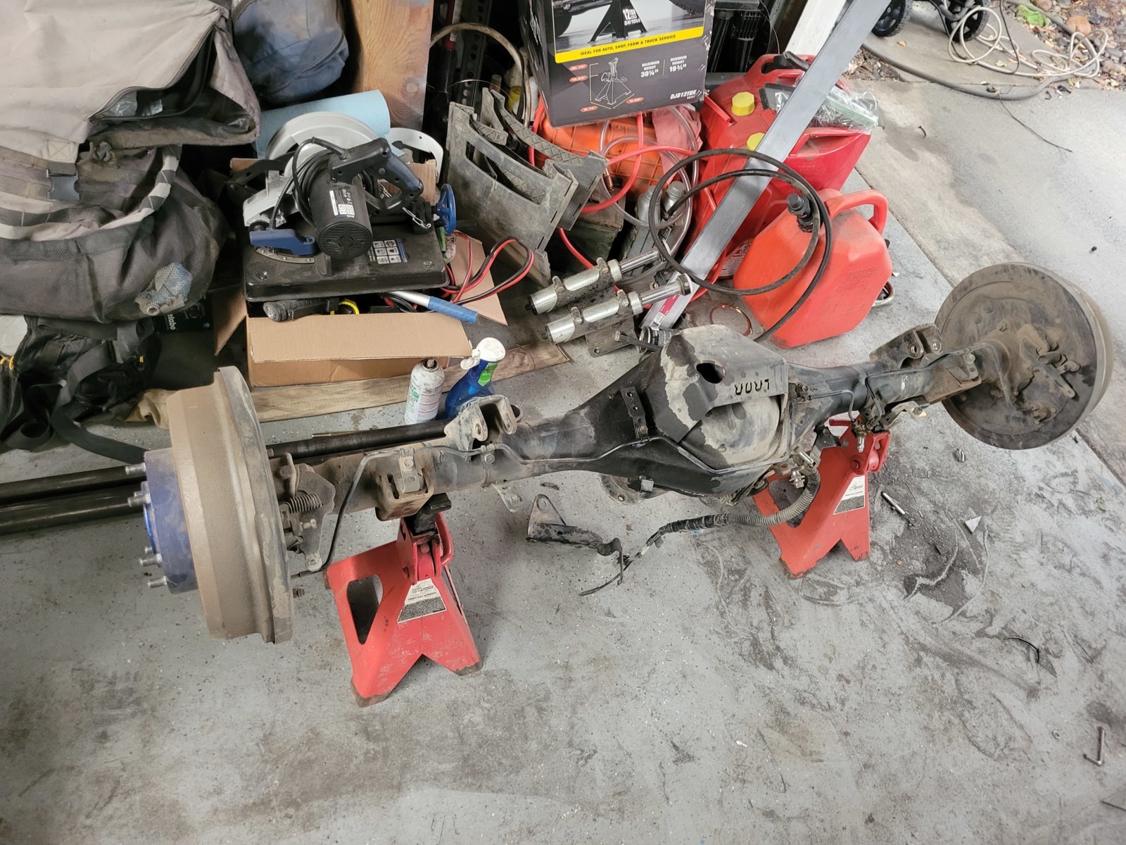

  9. Oct 23, 2023 at 9:08 AM
    El Taco Diablo
    El Taco Diablo Professional Pinstriper
    Nov 6, 2017
    #235223
    13,979
    Matt - KN6DZP
    Hughson, CA
    Impulse Red DC, 5vz-fe, 4wd swap, LT, dual case, F/R locked
    Just 3 tons of fun!!!
    I just pulled my rear axle a couple days ago. It's available.
    5.29 Nitro gears (3 years old)
    New drums and shoes (6 months)
    Bearings and seals replaced (about 3 years ago)
    Low Range Off Road diff cover
    Low range Off Road locker guard
    Locker rebuilt last year
    Lower shock mounts for shock relocate already on
    Ubolt flip kit
    Here's pics from right after it was just pulled from the truck. That is not any oil leakage. The brakes pissed all over the place when I disconnected them.
    DM if interested - Central Cali
