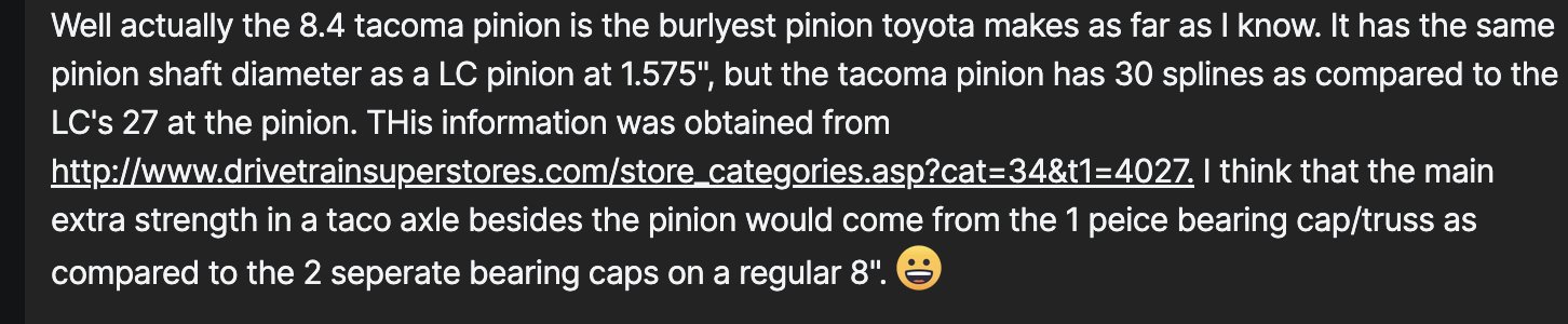

    Well, obviously I'm not an expert. But I'm surprised to see the 8.4" be labelled weak. Sure, it might be "weak" compared to a 9.5" or 14 bolt, but pound for pound it seems like a pretty solid little unit. Plenty of people are running 37s on them with no issues. Found this online:
    https://www.pirate4x4.com/threads/comparison-tacoma-tundra-8-4-axle-to.205369/
    There are a decent amount of reports of the "V6 8" axle deflecting pretty easily, especially in the heavier Prado 120 platforms.

    Regardless, they both went kaboom. Aftermarket Yukon 4.88 and factory gear. Like @02hilux mentioned, the ring will both be the weak point. And I would agree, if you don't do any crazy offroad trail, the TRD axle is more than capable.
    The 8.4 and 8 ring gear are identical minus the 12 vs 10 retaining bolt.
    You can say because of the 8.4" stud girdle designed make it stronger vs the 8", sure. But how much stronger? It's probably marginal.
