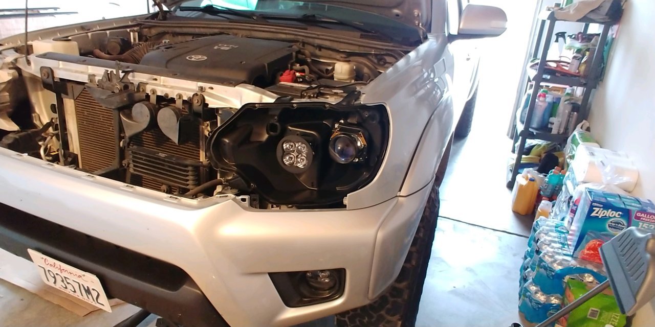

    I'm modifying my set currently. Going to install a set of diode dynamics ss3 driving lights in high beams with the mled 2.0 as low/high beams. The white strips were just drl, but now I'm putting I'm sequential switchback boards in. Different style but same concept as that.

    It was a close fit, but I had to waller out the projecotr mounting holes just a bit. Its easier to modify the projecor than to make a custom bracket. Everything is still solid. The high beam bowl itself is about 3 inches. The ss3 lights is about 4 inches wide, but there is enough room. Here's a loose fit but its fits up just nice. 0410201820_HDR~3.jpg

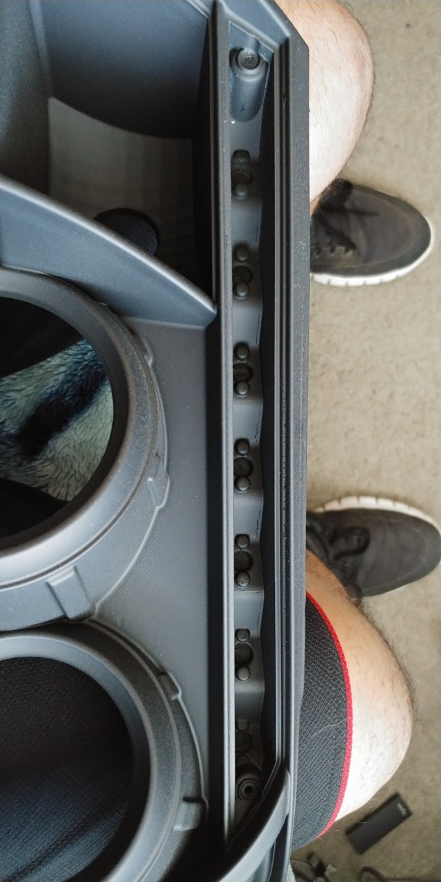

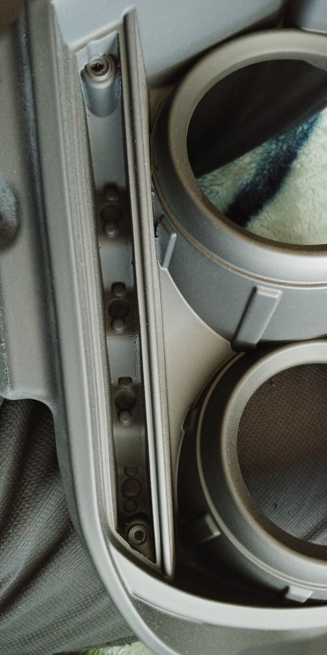

    One more question... If you haven't already put your headlight back together could you pop off those white drl covers to see what's underneath? I'm curious if I could just put down a strip of exposed LED and still get an even distribution of light with no hot spots or if I need something like diode dynamic strip with that coating on them to get a solid pattern with no hot spots.

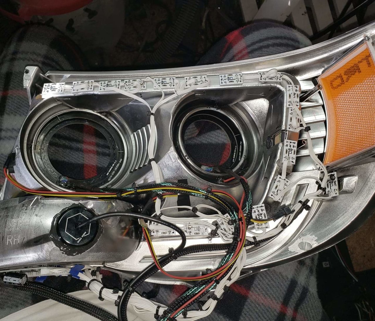

    Im going to add some chrome tape so the black doesnt eat up the light.
    And here is something similar to yours. I'm using the profile pivot sequential boards. Just the same as this guy. Although there is enough room for a strip.
