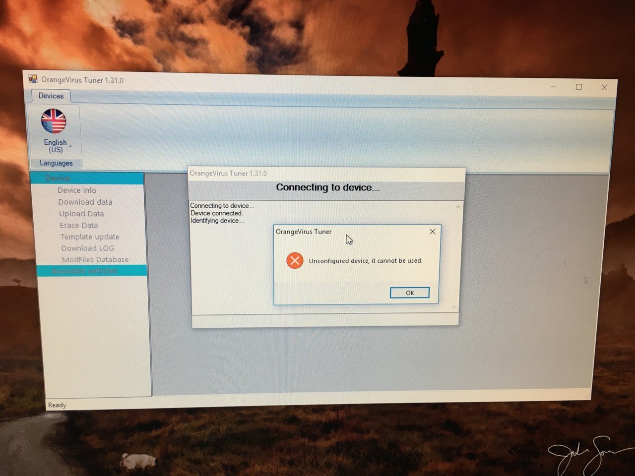

    Connect to truck and all the handheld says is that “test app 2.0 is running. touch screen to test”
    Touching the screen produces a beep and then nothing happens.
    So, I figure I need to try updating it first. On to the ovtune website. Download the instructions (nothing but device care instructions in the box).
    DD4C52EE-604D-4123-8D90-18D2580A7F32.jpg EA6B5333-43C0-44D3-BB9D-ED68470F2198.jpg
    The online instructions have a link to click to update the handheld. Download the software and load it onto my pc. Fire it up and it instantly sees the already connected handheld (via usb). It then says that it’s an “unconfigured device, it cannot be used” clicking the ok button closes the entire ovtuner 1.31.0 program down. Screen on the handheld still says the same as when connected to the vehicle.
    From what I understand, this handheld is a newer model. Maybe the ovtune software needs to be updated to work with the new handheld?

    Assuming your PC has active connectivity to the internet...open OVTune program on PC then connect handheld and it should automatically download all the updates for both the PC and Handheld and install in both.

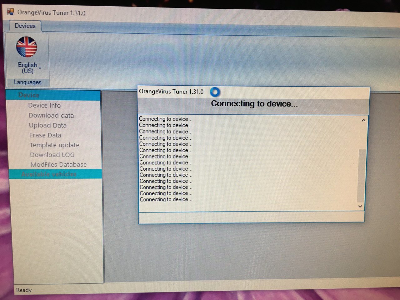

    Software won’t get past the unidentifiable device error. Starting the software without the handheld connected has it searching for a device constantly with no option to cancel. Yes, the pc is hardwired to my router. Internet is fine.

    I would email Mat and see what he has to say about this. My guess would is the pc program needs an update to recognize the new handhelds.
    I will say I had to go into the options and do the screen calibration on my handheld as I could not select anything in the bottom right corner, after calibrating the screen it worked fine.
