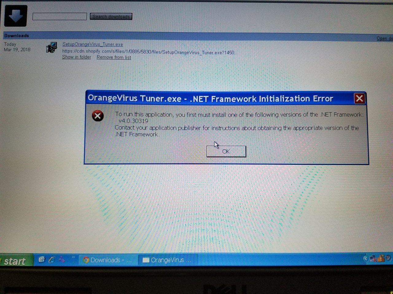

    Anyone know if this message means my computer is at fault or if the hand help ovtune device is confused???20180319_202631.jpg

    Looks like you need to run your Microsoft updates to communicate with OV. How current are you?

    Hmmmm. I haven't turned on my computer in almost 10 years. Seriously. I'm in the stone ages. Comes with being a stone mason. I'll try for that. Thank you. Any help is awesome!!

    If installing windows updates does not work, try downloading this and installing it first.
    https://www.microsoft.com/en-US/Download/confirmation.aspx?id=17718
    Your version of .net framework is out dated, and the handheld software requires a newer version to work properly.

    I don't know what operating system you're running (XP, Vista,?), but hopefully it will be supported enough to update to the required minimum. Good luck!

    Isn’t that a Windows XP machine? Does the software state the minimum system requirements? XP is kinda old.
