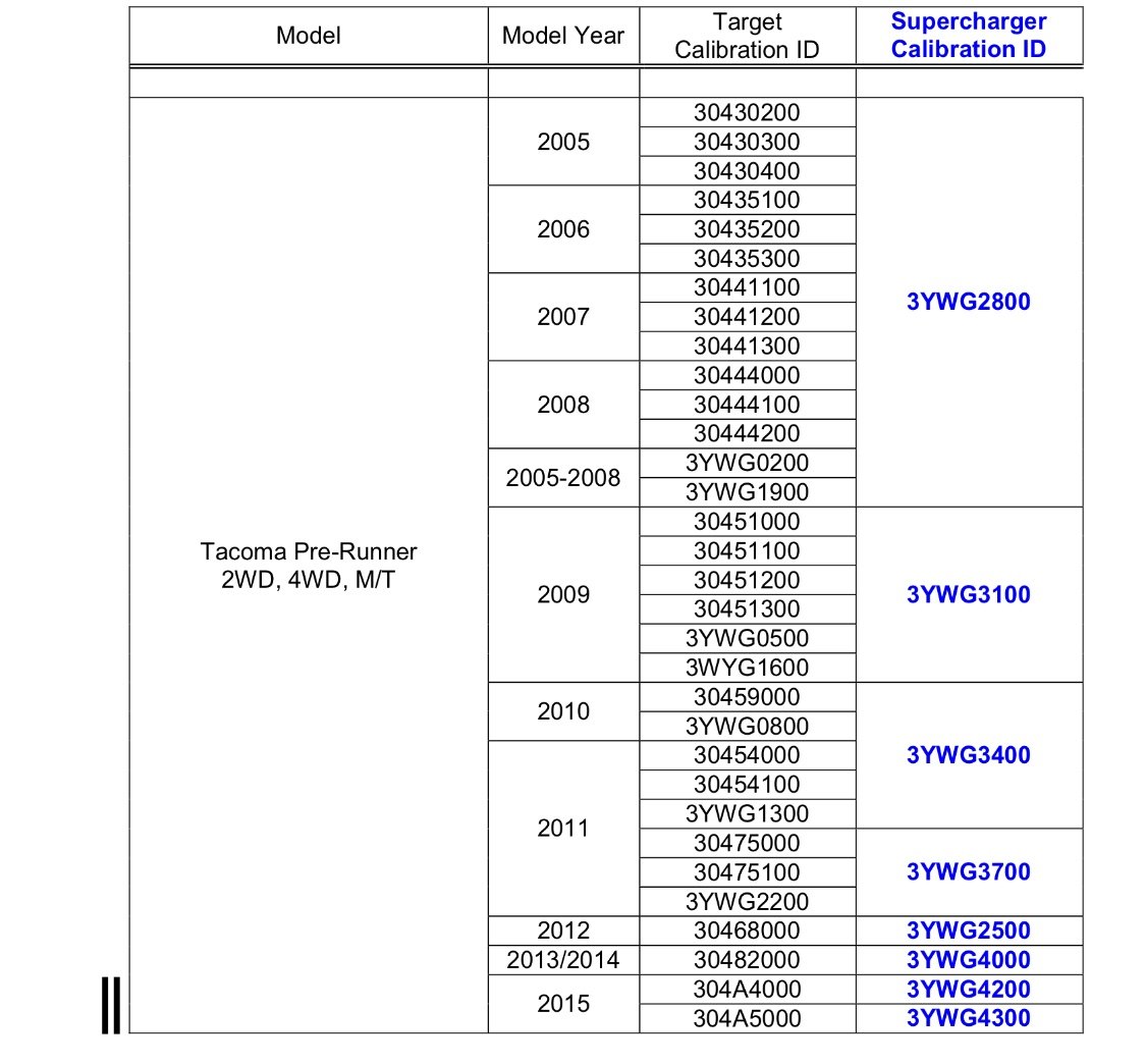

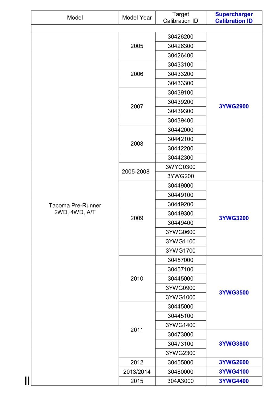

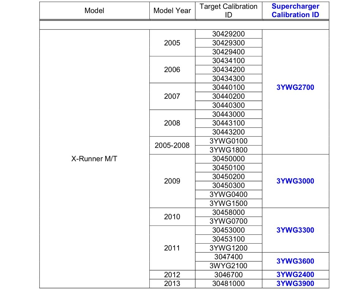

    If anyone wants I figured I would post the list of stock to supercharged calibrations so people can check this list in the OP if their calibration is supported. This is not including TSB calibration ID updates, I don’t know where those are.
    9026B2D1-6A14-40B5-829A-286BCE88A0CF.jpg 7A328F1E-4345-43B8-9A68-ACC4288F76B4.jpg 58786D38-B052-4975-95F5-362D548CC602.jpg

    How do I go about finding my ecu calibration ID? Thank you.

    I see that! It’s good info to have here, it looks like @OVTune is only has about 1/3rd of the supercharger calibration files. And knowing there is more NA calibrations than listed because of ecu updates for sparkknock and other things, there is a crap load of NA calibrations.

    Check my post above, find your exact model truck in there, be sure to get the right transmission type (on the left) and go from there. Just know if you ever had an ecu update done by toyota then your caibration will be different.

    I'm N/A so that chart won't work? Sorry a total newb on this stuff.

    NA calibrations are listed as target calibration ID, to the left of the supercharged calibration ID
