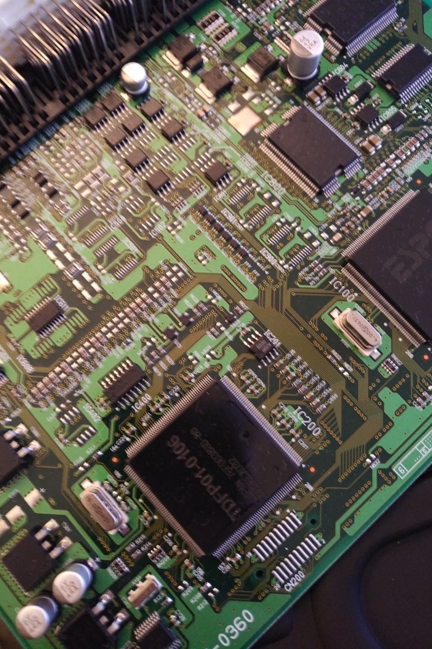

    @OVTune any updates on the two Calibration IDs that are quoted above?
    3YWG2900
    304A3000
  3. Mar 28, 2018 at 11:54 AM

    Working on this ecu to get several calibration versions updated for these metal case ecus

    Any update on YWG40000, @OVTune?

    Got my replacement tuner today. Thanks Mat. @OVTune
    I plugged it in to the PC and let it do it’s update thing. I then took it out to the truck to tinker with it.
    As expected, it doesn’t like my calibration number. (I’m guessing it has something to do with the dreaded “metal case” ecu issue. See post #168 in this thread.)
    Anyway, I can’t seem to get past this screen. No way to back out to a previous screen. I just unplugged the obd2 connector and then plugged it back in.

    DIY software is ready, modules ready.
    for the people who ordered the DIY kits send me an email with your order number / info so I can get you your copy.
    If you are interested in self - tuning, it will be available soon

    Will the self-tuning solutions be restricted to a single ECU or will we be able flash multiple vehicles? Along those lines, will users be able to share ROM files/tunes?
    Essentially what I am asking, is how similar will this process be to reflashing a EVO VIII/IX with ECUFlash? As I have extensive experience in that arena..

    Does the DIY software have the ability to edit DTCs and change injector sizing?

    will be restricted to a single ECU version, not single truck. So lets say you order tuner kit with ECU version 344001, any truck with this you can tune, you can also share your tune if you want. You can purchase access to other ECUs or you can buy a master license which gives you all of a certain vehicle (for example Tacoma 4.0 Master kit)
    yes

    Will we have access to your tunes for the said ECU? So we could buy the self tune kit load your tune and adjust from there?

    @OVTune, what's the turnaround time from your receipt of stock files to our receipt of custom tune?
