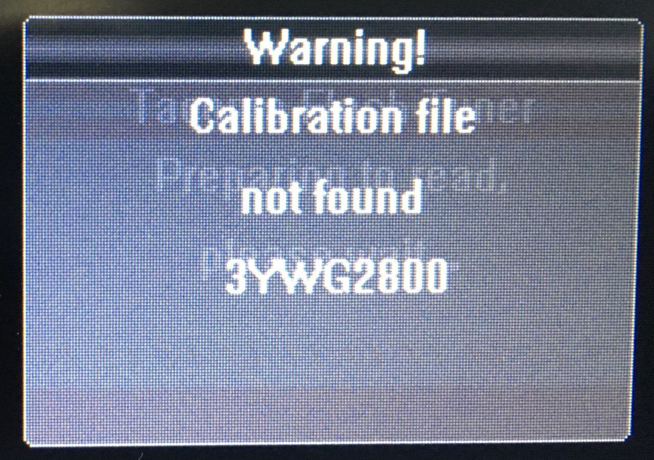

    SUMOTNK
    SUMOTNK Pavement Pounder / Mall Crawler
    Sep 8, 2014
    #137895
    3,028
    Eddie
    NorCal/South Bay Area
    Looks like a Gen2.5 TRD Sport, but really an '08 TRD OffRoad
    TRD Supercharged / OTT Tuned
    I just updated my handheld. Looked like a major update but FW1.50 still.
    Cal file 3YWG2900 still not found.
    I'm hoping I'm just early to the party....and the servers in Italy just need to be updated first.
  4. Apr 18, 2018 at 5:44 PM
    #2444
    OVTune
    OVTune [OP] Well-Known Member
    Mar 27, 2017
    #214557
    8,112
    OVTune
    They were submitted to be added, I'm waiting on them to confirm, they message me when it's in.

  7. Apr 18, 2018 at 7:22 PM
    #2447
    BillDaCat8
    BillDaCat8 Well-Known Member
    Jun 25, 2017
    #222348
    1,915
    Jake
    PHX
    07 4x4 Access Cab M/T
    My shit is all stock.
    I see the 2700 and the 2900. But not the 2800. Is that because mine is a manual trans ?

  13. Apr 19, 2018 at 9:18 AM
    #2453
    OVTune
    Mar 27, 2017
    #214557
    8,112
    OVTune
    okay all files that are listed are now added, will be in the next update for the handheld (probably a couple hours)
