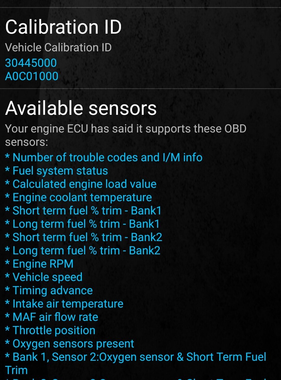

    So how do you find what number your ECU is? I took it out and couldn't find any numbers that resembled the ones on the front page

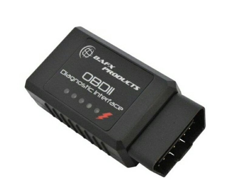

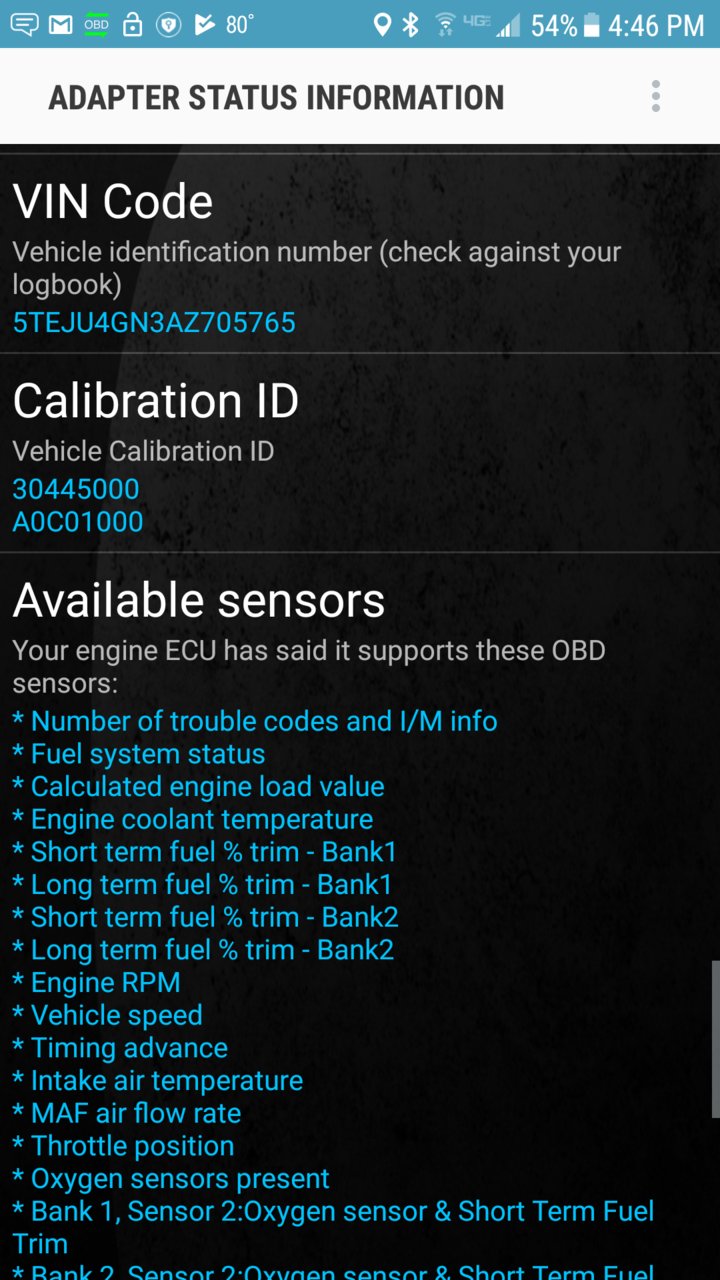

    I used the bluetooth scsnner pictured below and it gave me the number. Posted is the screen that provides the information. On my truck the calibration (ecu) number is 30445000

    Hmm... guess I’ll have to invest in one of these things.

    Is this using the torque app?
    taco2010trd[QUOTED] likes this.

    Yes i have the Torque Pro App on my android phone.
