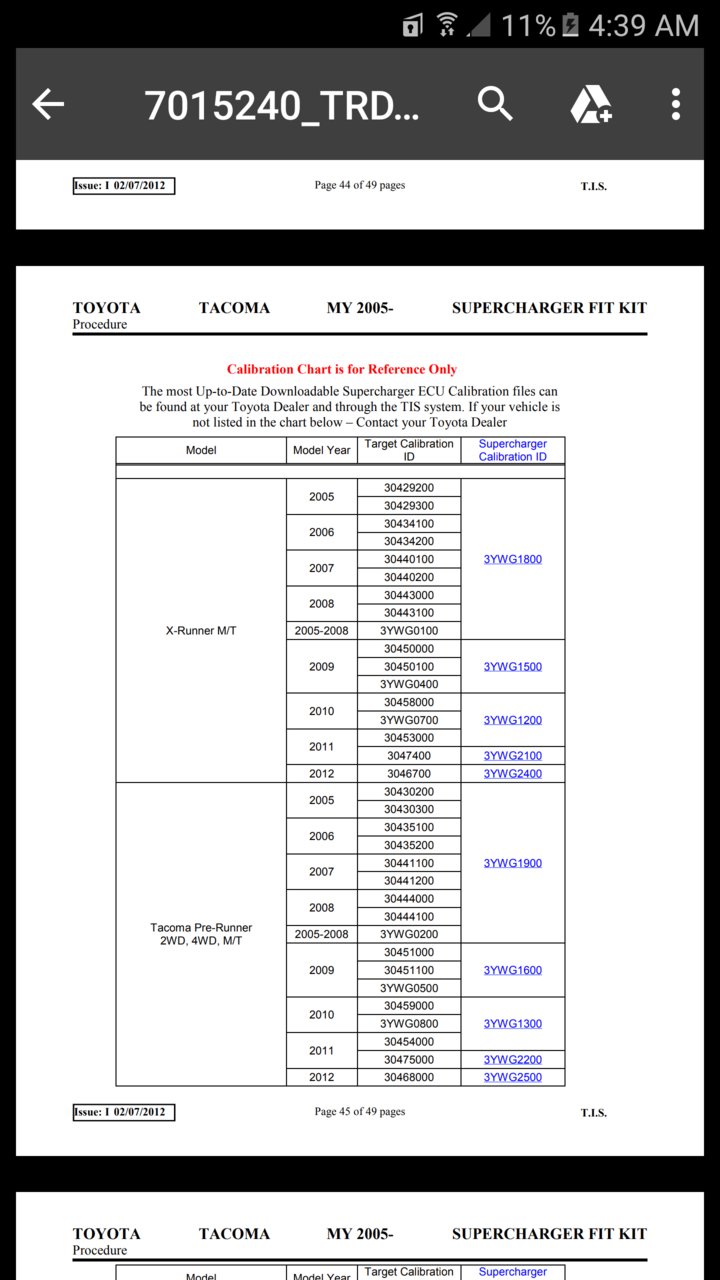

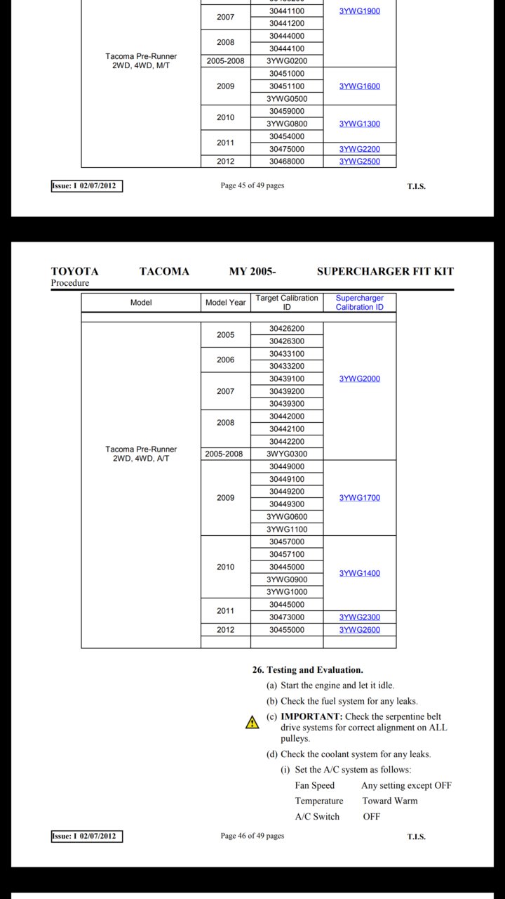

    So it looks like mine would be 3YWG2000, which is not on @OVTune ‘s list. ☹️

    That's your TRD SC flash ID. Check your stock ECU ID, it may be in the NA list and you won't need the TRD SC calibration ID

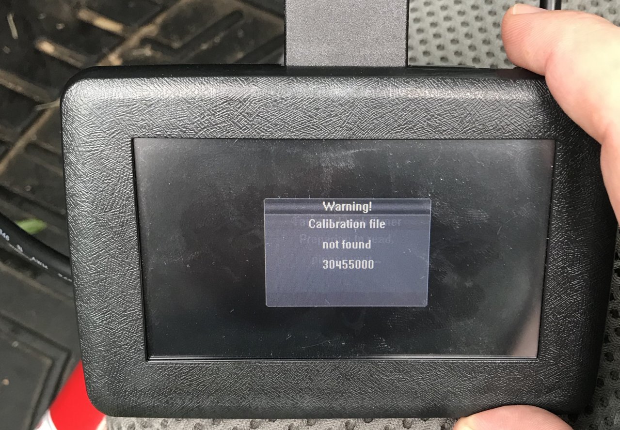

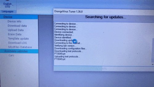

    @OVTune Did the latest updates as of today, and still says 30455000 not found. Is there anything on my end to troubleshoot to make sure it has the latest calibrations, or is it missing from the update?

    If any of you guys happen to care... Just did some research, and if any of you guys with 2008s took your trucks in to the dealer many years ago for the accelerator pedal recall, they should have reflashed your ECU to 30442200. If anyone else did this recall and is wondering what their new ECU ID became, check out this PDF:
    https://static.nhtsa.gov/odi/rcl/2009/RCRIT-09V388-7150.pdf
