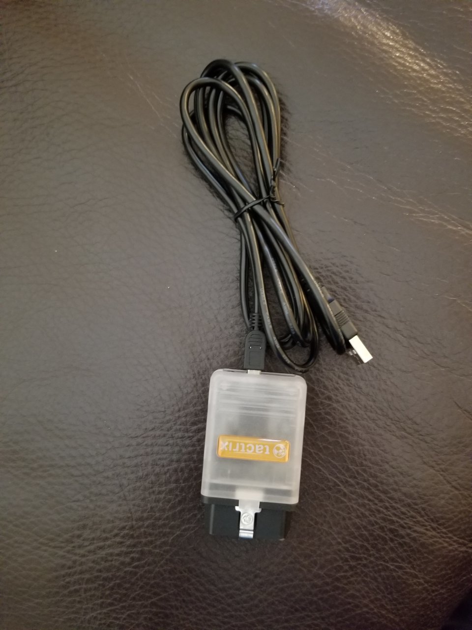

    I just picked up a thundermax but the power vision is nice too. Be careful with AutoTune like anything else it takes time to work and may not be perfect in the "auto" part.
    TacoSupremeo likes this.
  16. Aug 2, 2018 at 2:18 PM
    #3096
    Hacktacular
    Hacktacular Well-Known Member
    Mar 13, 2016
    #181157
    272
    Robert
    2010 Tacoma X-Runner Turbo
    800cc Siemens/Deka Injectors URD Fuel Pump Upgrade Haltech Elite 2500 Custom Power Fab Precision Turbo 6676 @8 PSI 3" Custom Exhaust from turbo out
    Hey look, twins :D
  17. Aug 2, 2018 at 2:21 PM
    #3097
    Hacktacular
    Mar 13, 2016
    #181157
    272
    Robert
    If you need help I am sure Mat can log in to assist. If not he can provide instructions, and I could always login to assist. Just let me know. I tested this bad boy with techstream and it works great and has fast communication!

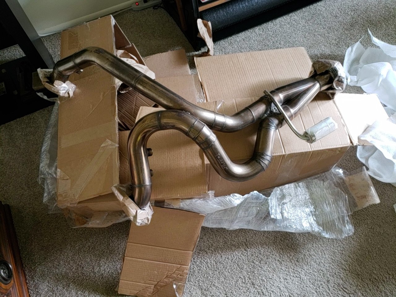

    And I cant wait for the last piece of exhaust to show up to fit this to my longtubes!20180802_140035.jpg
