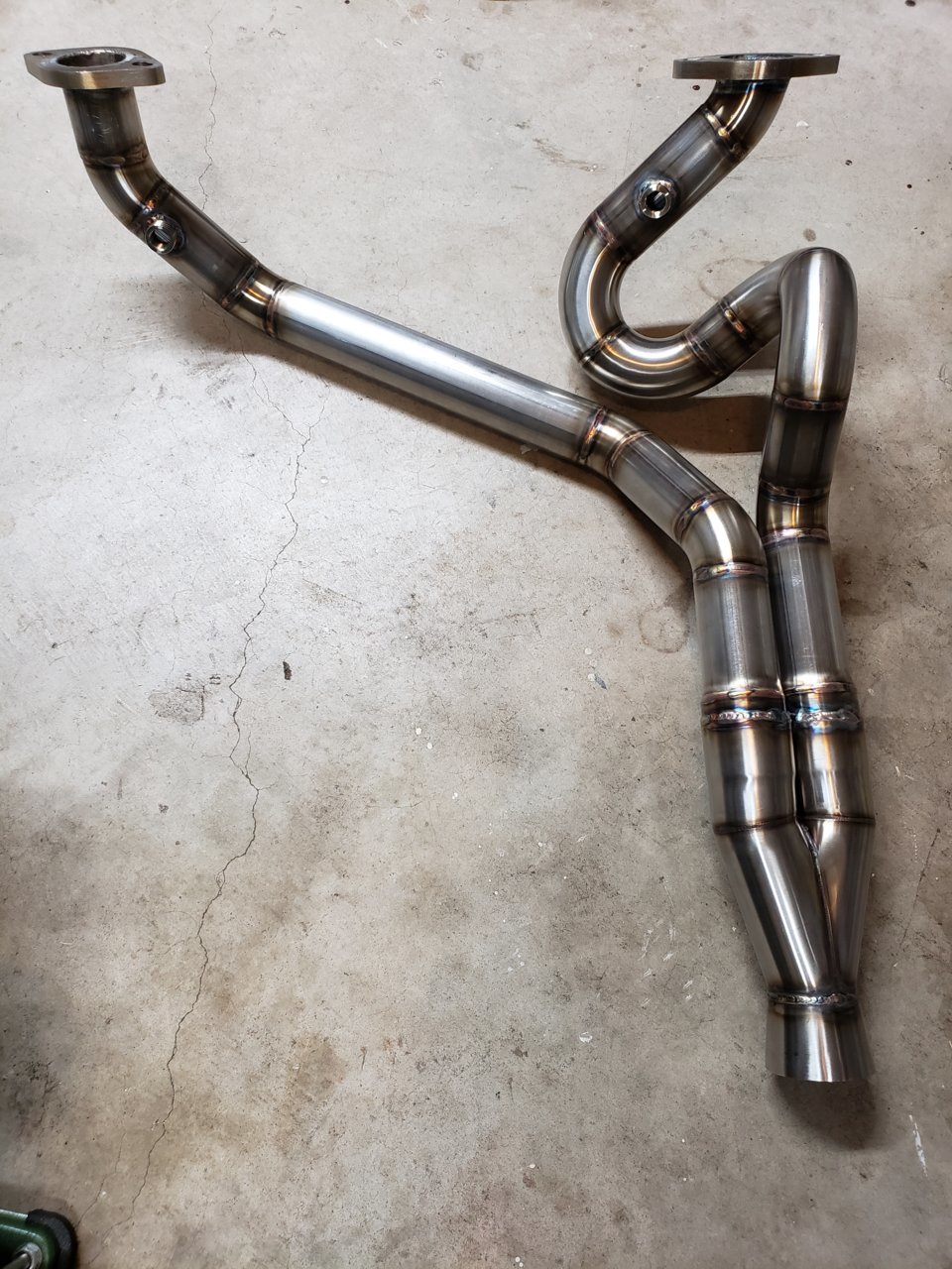

    That looks pretty sexy. Who makes it?

    @Roostfactor. If you're willing to pay for a quality product hes the guy to ask.

    The design has changed slightly and is more refined.

    Looks good!

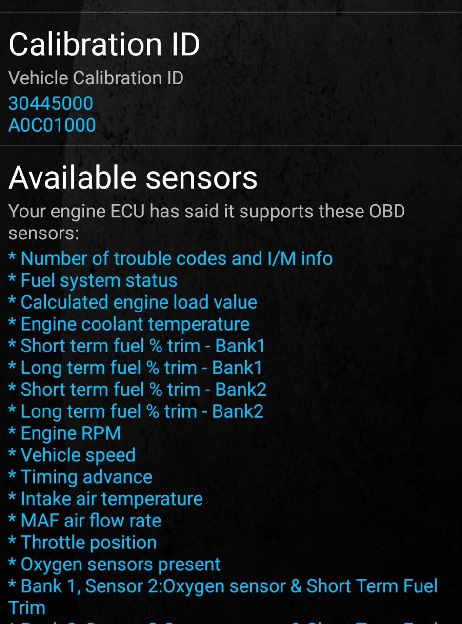

    Found two numbers on my ECU.
    52402808
    and
    030132361A
    Believe top one should be right one for OVTune.
    Can someone confirm please.

    The numbers on the ecu will not tell you the calibration ID

    The #s on the ECU is just the Toyota part # of the actual ECU (hardware/computer brain). The ecu calibration file (target calibration ID) is the software on the ecu/computer. An OBD-II reader should be able to tell you what calibration ID file is currently being used by your ECU.
    Your two numbers are incorrect for Calibration IDs.

    Use OBD scanner to find this # as pictured below - 30445000
