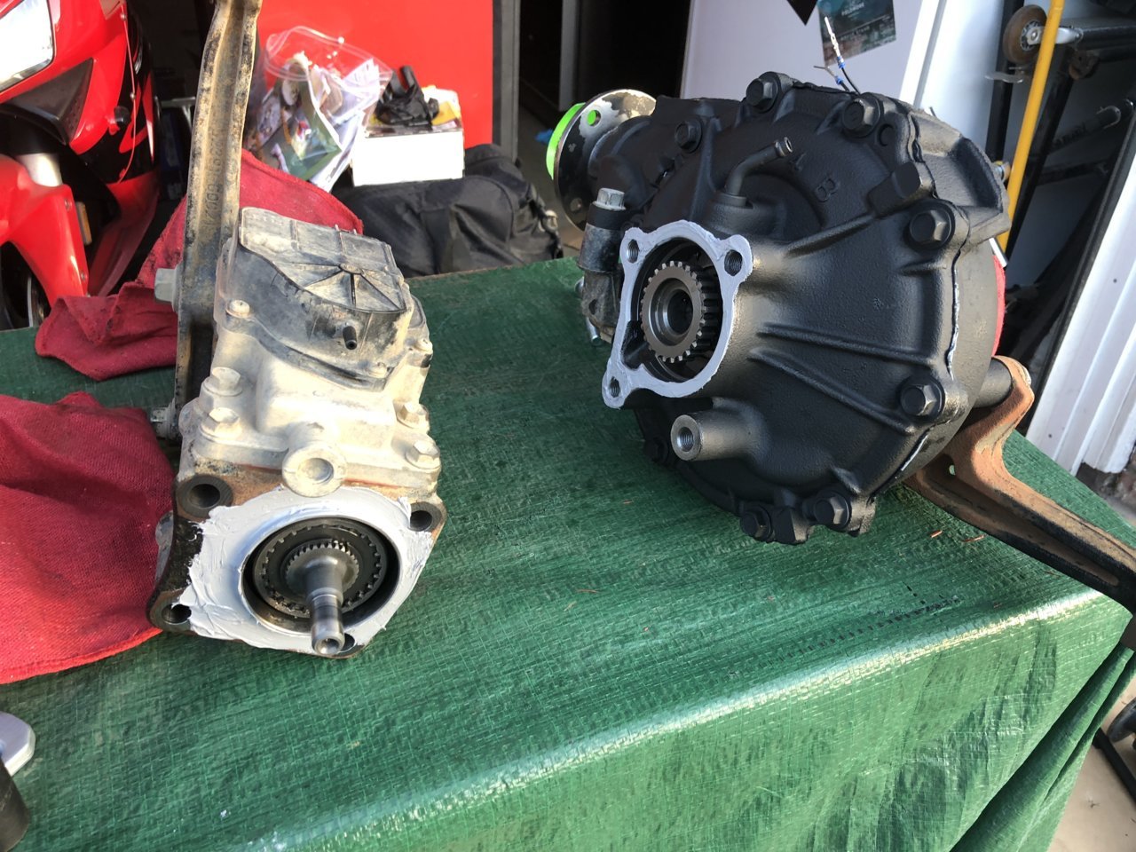

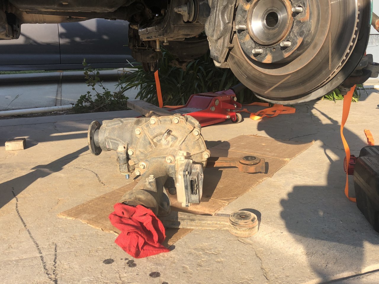

    I second Regearing, finishing up the front now. Feels great with the rear done (4.56). almost had it completed today.
    Out with the old and in with the new!
    5D36CB1E-A606-4090-8386-BBE241DA6130.jpg A2BC2B75-F6CF-49CF-8297-E46BF77E092C.jpg

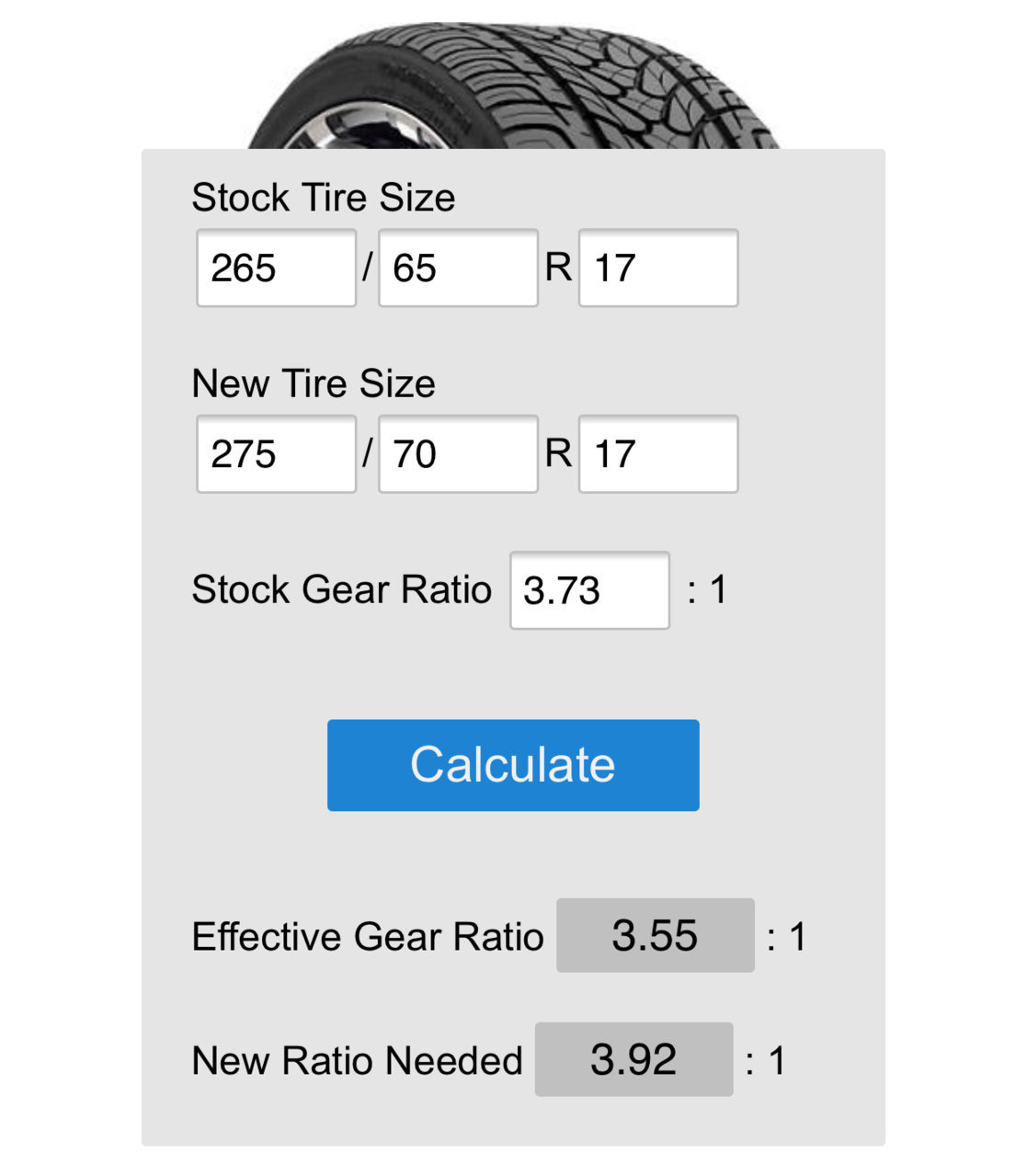

    I’ve only got 275/70/17, but it definitely slows things down vs the stock 265/65/17. What are your freeway RPMs like with 4.56s?

    At 60 I'm around 2200-2300. 75-80 I'm around 2800.
    285/70/17 MT's and I weigh around 6000lbs on the daily.
