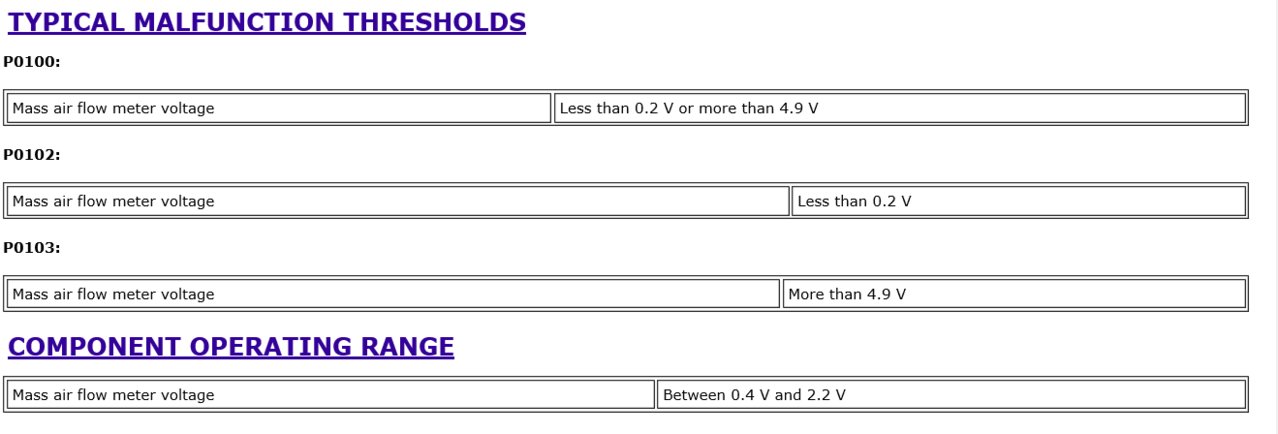

    Tacoma AFM voltage range

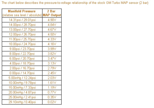

    Standard GM 2bar MAP voltage range.
    Looks VERY promising.

    Looks like the Toyota sensor runs off of B+ tho. The GM sensor wants 5v. So, there'll be some finagling there.
