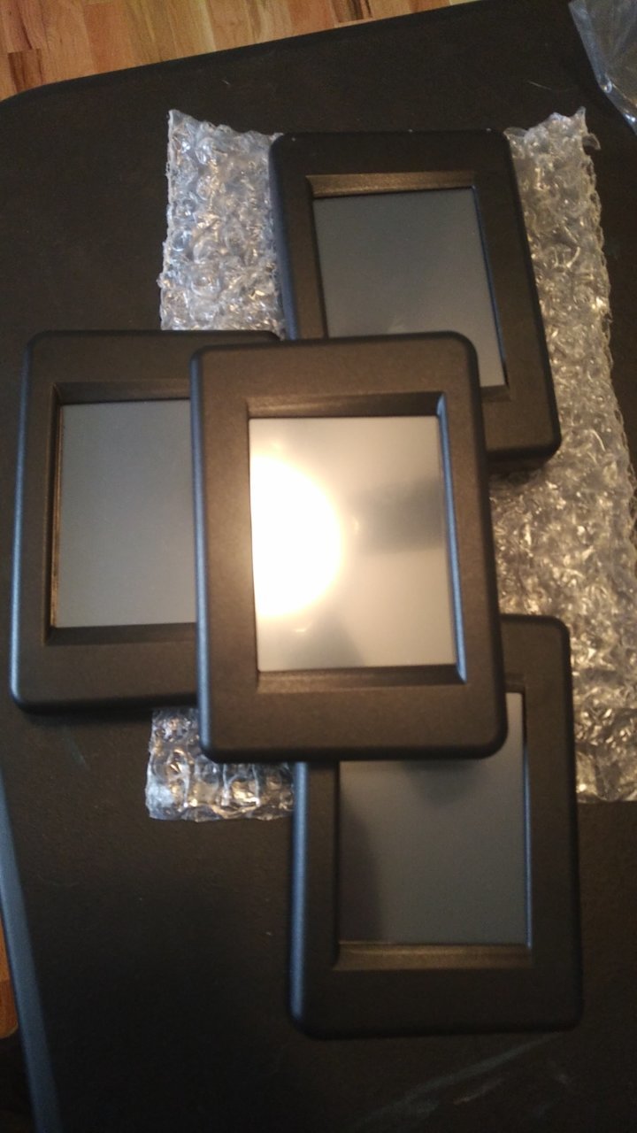

    Regarding SC trucks interested in tuning.
    We have 4x older version handhelds. They are open box returns from NA ecus that they didn't work on. Perfectly functional, will work on any SC ecu,
    They are open box, and not the HD screens.
    If anyone is interest we have them at $380 each.
    They are open / outside of original packaging.

    Im interested in one, Do they still give the v2 tune??

    yes

    Do I order it from the OV site or.....

    @OVTune So how do we order the marked down handhelds??
