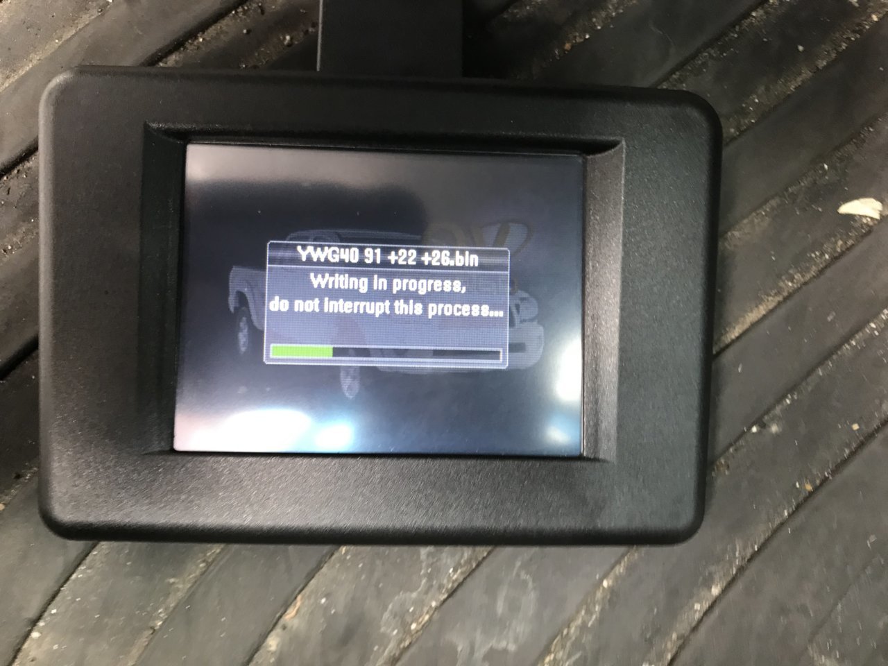

    Got the tune in there today and ended up doing the 93 tune, its a lot of fun :)
