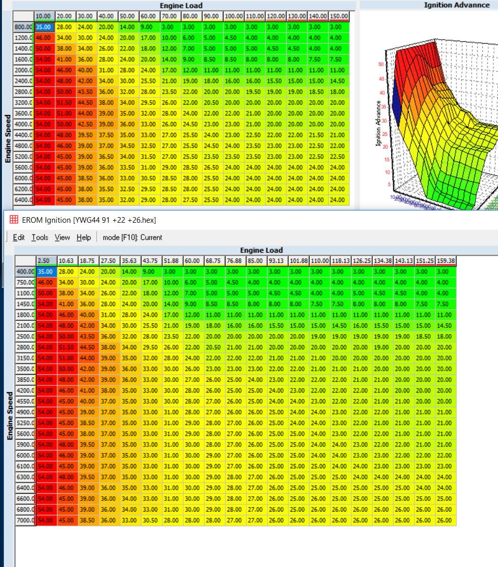

    The expanded resolution is nice, but changing the code for how load is calculated will make it better, all the incremental load changes will have better use than before.
    So for example stock load Calc, full throttle and in boost you might already be at 150-160 percent. With our change you'll be closer to 115-125 percent.
    Then more boost..130...140...150..

    Reading power from maf grams is a guessing business. There seems to be people happy about the response changes but you can't make power guesstimates accurately from just taking MAF readings.
    Perfect example the skyactiv 2.0L reads about 120 g/sec peak of airflow on the MAF, take the "basic" equation of maf x 1.2 = "bhp" (it's a far fetched guess) and that leaves us with 144BHP.
    Lets be more generous. 1.3. That leaves us at 156BHP. That's less than stock advertised and far less than actual tuned gains. Making guesstimates on power from MAF readings is what people did 10, 15 years ago..
    Those engines will make 200+BHP with that much air. A dyno is what tells you how much power is actually being made. Making power figures from MAF gram readings is loaded in my opinion. It's as accurate as a butt dyno. Similar to throttle scale changes. You can make a vehicle feel stronger, torque-ier by modifying throttle tables but actually gaining 0 power.
    This is just my opinion of what I know from tuning for many years, I think most good tuners would agree with me.
