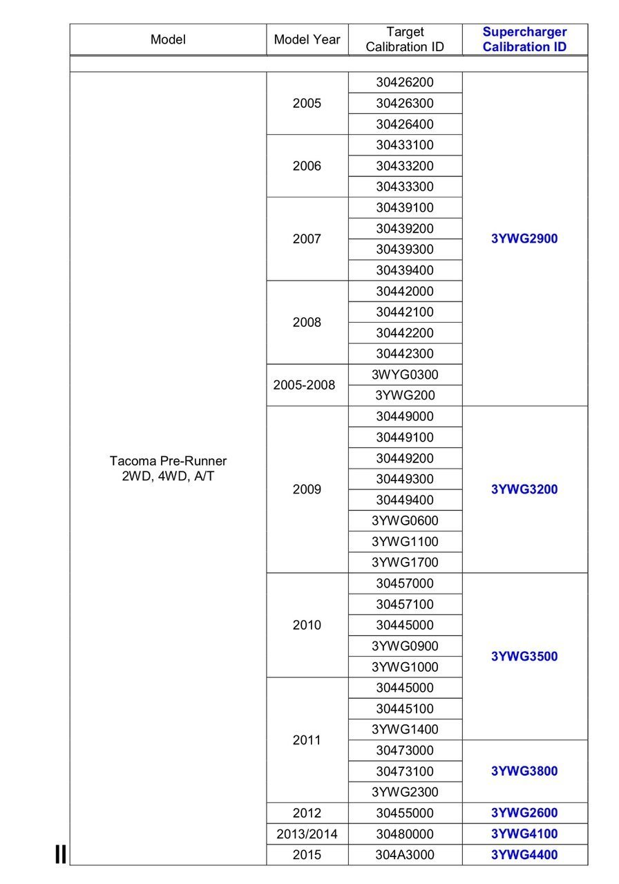

    Would this handheld work on a 2008 N/A 4.0? Does it have the 91 tune already on it? I'll need to look up my ECU p/n to see if its compatible correct?

    I believe you would have to send your ECU file to ovtune. I have to get the handheld back to stock then you would have to get the handheld and plug it into your truck and get the calibration file then you send it to him. @OVTune

    The handheld will work, you would need extract your stock calibration via the handheld and email it to Matt to get the correct 91 tune for your calibration ID. If you have a Bluetooth obd2 reader and the torque app, it will tell you your ECU calibration ID. I'd assume most other hand held obd2 code readers should be able to provide you with the ID also. Not 100% sure but I know I can see mine with the torque app using the elm327 bt obd2. There's also a list floating around of Cal ID's that were flashed by year and options like auto or manual or 2wd and 4wd and supercharger or no supercharger. There's over 30 different IDs from 2005-2015.
    But I wouldn't take my word as gospel, you'll probably want a reply from Matt himself to be 100% sure.
