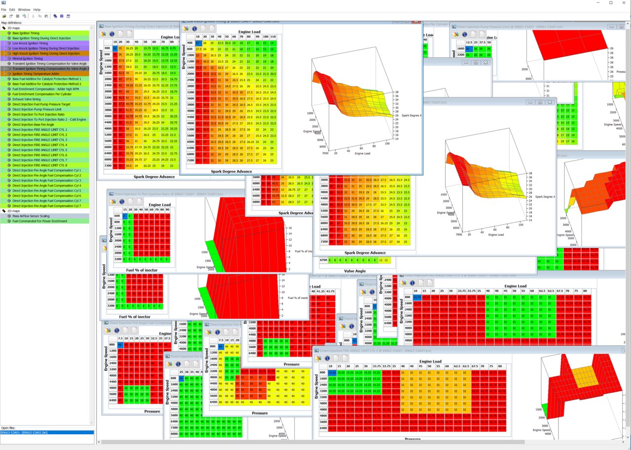

    OVTune
    We can do it via S mode. Shift selector to S, and it will lock in a gear.
    We do this already on the 3rd gen and the Tundra. We'd love to develop more for the 4.0L, if we can get people interested again. Most have moved to hptuners...
    Also. Our tuning software for the 4.0L is done. (via toyotacal handhelds).
    use the handheld for flashing and datalogging.
    use our software for creating your tunes, and viewing your datalogs.
    base tunes are provided for supported ECUs.
    I know there was like 2 or 3 people that got our very very early version software, we really want to get you guys updated on our new stuff
    EdinCincinnati and bassbrick like this.

    @OVTune Would I benefit from an update or stick with what you provided me (custom 2.7 tune.)
  6. Jan 4, 2020 at 6:32 PM
    #4386
    OVTune
    OVTune [OP] Well-Known Member
    Mar 27, 2017
    #214557
    8,112
    OVTune
    The toyotacal handheld is a different kind of handheld, not a software update to the current handhelds that are out there
    JuanitoBonito[QUOTED] likes this.

    @OVTune is 4801 91 Oct R1-Shift the latest 91 Octane file?
    CAL 30480100
    Software 89663-04801-
    Hardware 89661-04G61
    If so, any updates planned?
    I have the first original offered handheld

    I also just received my tunes for my gen 4.0, Matt you say to upgrade P5flash to version 1.2.2. How do I do that,,,I did not find it with my tunes you included.....
    Mar 27, 2017
    #214557
    8,112
    OVTune
    There is actually a TSB for this.
    If you can't get the TSB our software will automatically update the ECU to the latest version when tuning.
