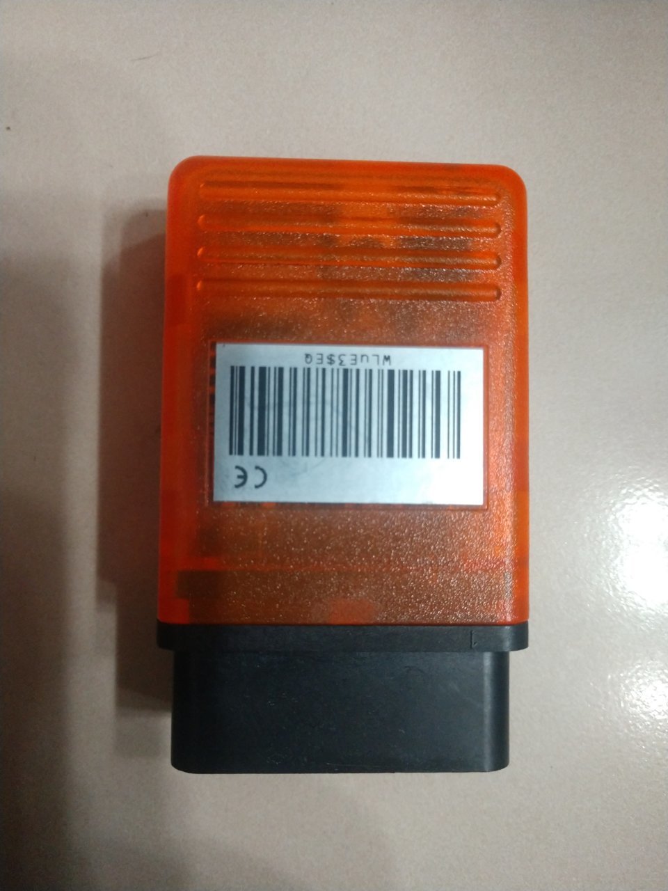

    I'm not sure,
    I went to the website and there was nothing available for a 2013 model
    I have the orange dongle I just took a picture I'll see if I can post it up real quick

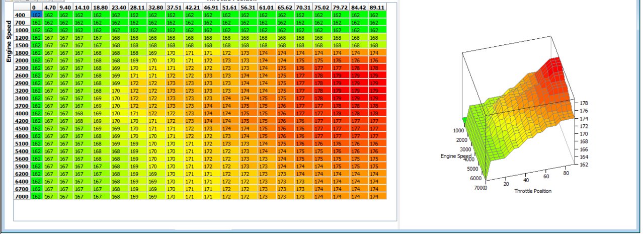

    Is there anything you, or anyone else is specifically looking for, or want?
    what kind of features, what kind of things, etc.
    One thing I think you boosted guys are really going to like is our Alpha-N Density patch.
    This 3D table (currently works, tested, etc on the 3rd gen and tundra) works like this:
    you can directly modify the amount of fuel you want and resulting absolute load through this table. RPM vs TPS
    it's very, very helpful for tuning boost.
    and then of course the other stuff, closed loop fuel tables, etc.

    I completely understand that. That could be a benefit over the HPTuner though. Since they are limited to finding the TRD tune to have the expanded load tables. Which still aren't good enough in a lot of turbo style applications.
    That then comes back to what you said. Market appeal.
