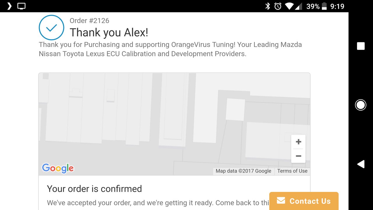

    From what I've gotten, that money will be there's for a while my friend. That's why I'm asking so many questions and been waiting quite some time.
