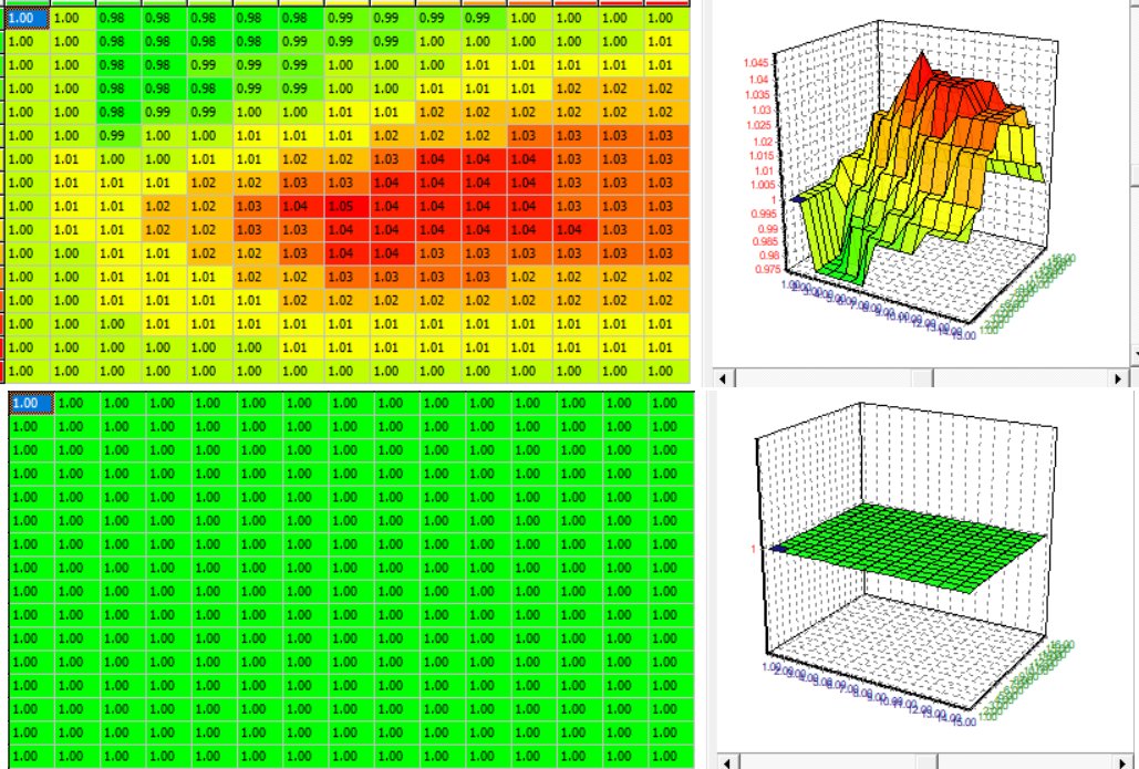

    This ECU gives the user a lot of power over fueling.
    for example lets say you have your fueling "close" but have a rich or lean spot you want to make a fuel adjustment directly.
    There are maps based on RPM and Load where you can modify the injection amount directly by a multiplier to add or substract any amount of fuel large or small.
    TOP image is a "tuned" version of the stock map BELOW
