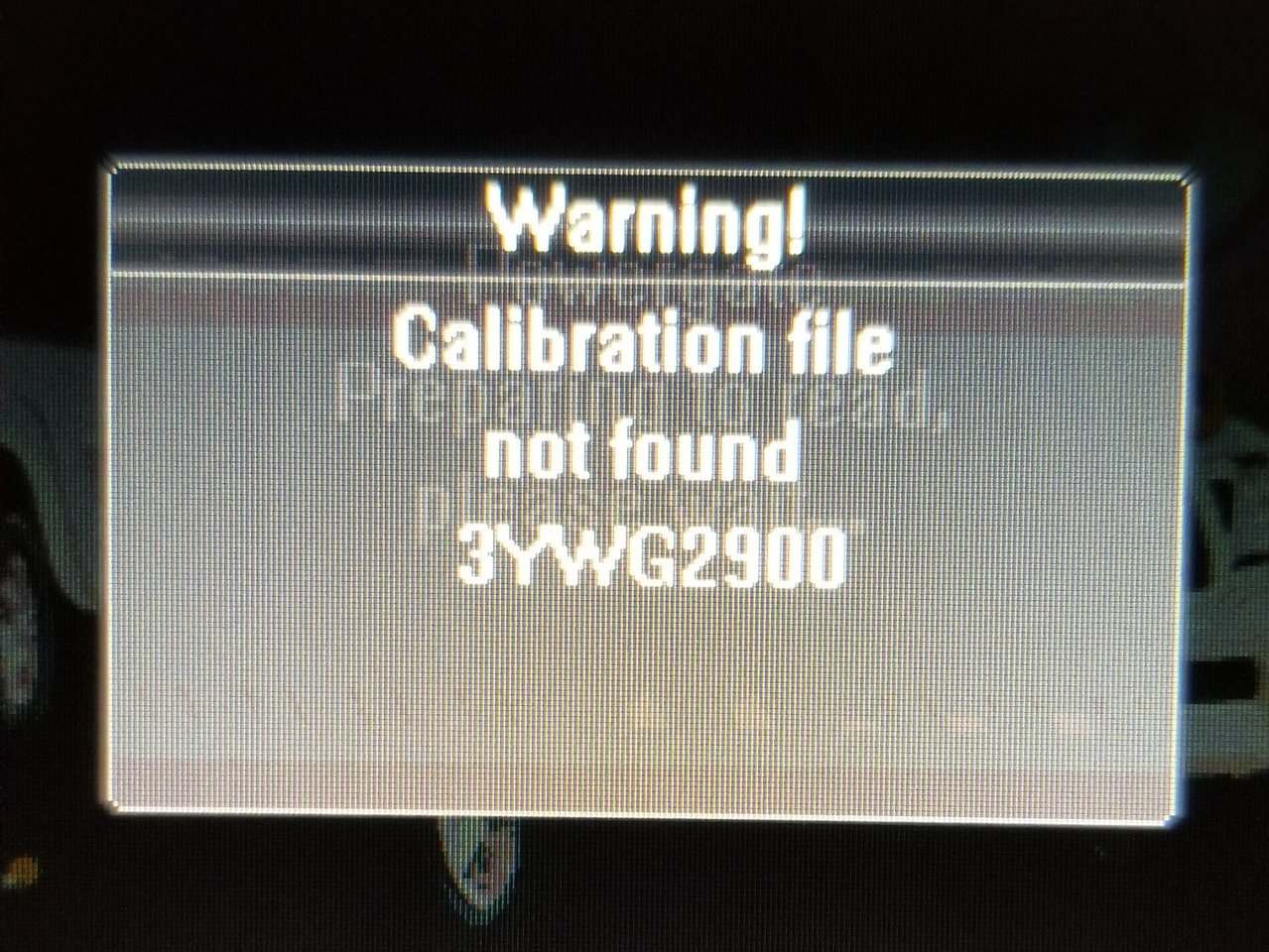

    No joy. Still ECU not found. Le sigh.

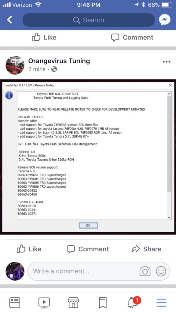

    All TRD version calibrations we will be sending to Italy tomorrow for checksum fix.
    YG25/26/38/41/ etc

    Not sure what of these last few posts mean , but just tried to update the brick and store my ecu, still cannot save my ecu date to the unit.

    I haven't been so lucky. Just tried to update about 10 minutes ago and still getting the same error. Back to the holding pattern.....

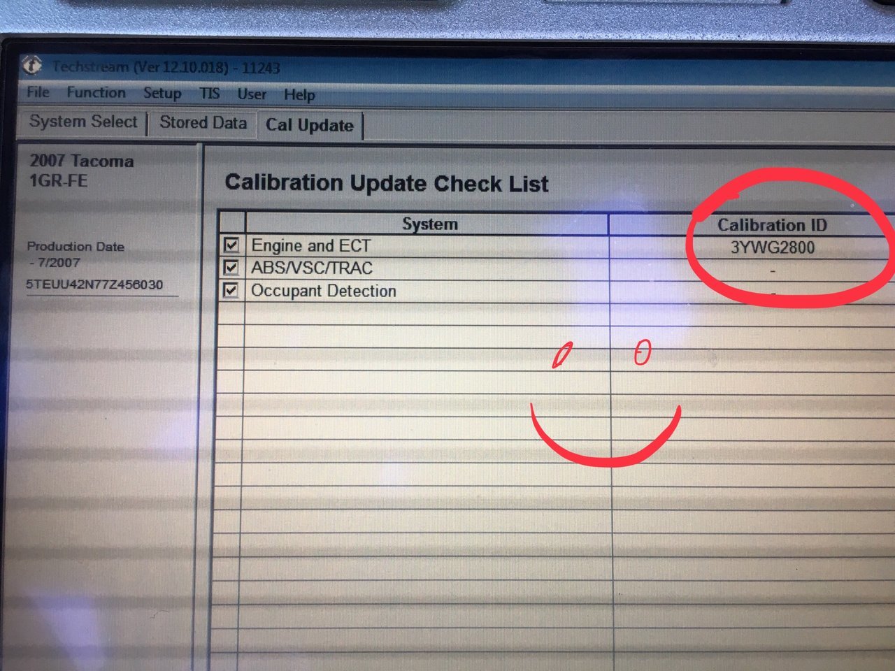

    Looks like your ID is not one OP listed in last message
