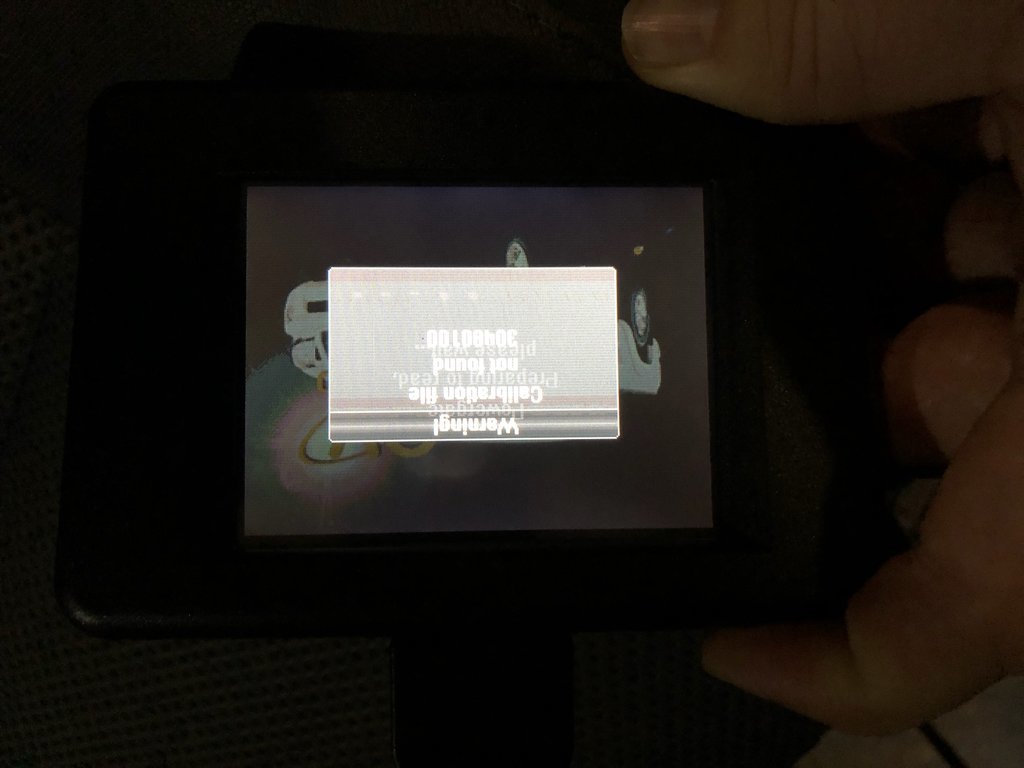

    @OVTune was 3YWG4100 submitted? I plugged in handheld to application went through rather long update and saw its version 149 now. But when plugged into truck still says no stock file found when I continue it says 3YWG4100 not found.

    i updated the handheld again this morning at 7:30AM EST.... Code 30473000 ( @D-Rose ) still does not work

    @OVTune same results as NLMOOmar for 3YWG3500. Updated handheld via PC last night & again this morning

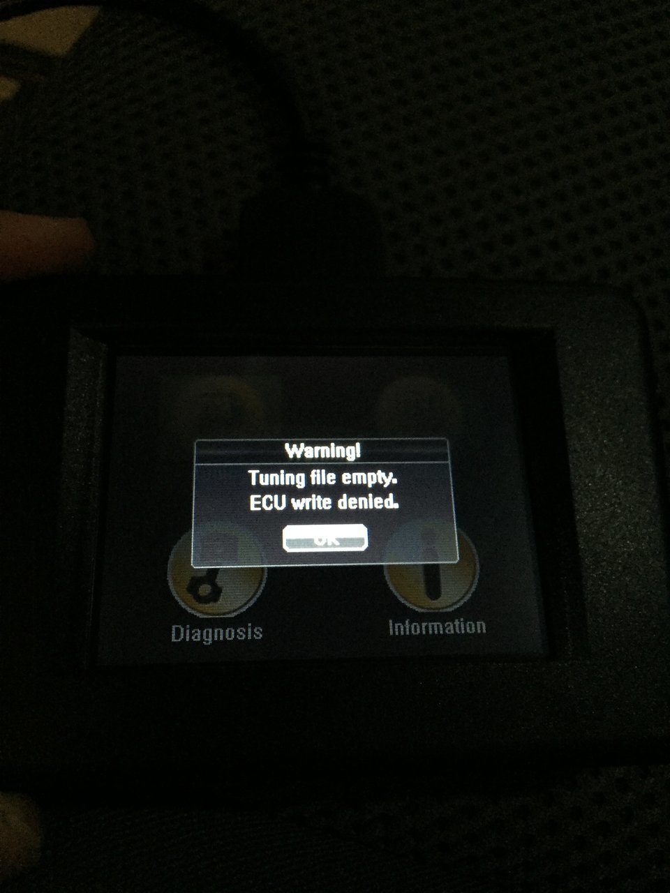

    Got a "tuning file empty" warning this time, Does that mean the handheld recognizes the ECU but just needs a tuning file uploaded to it?

    Yep that means it successfully saved your stock ECU Data,
    check my handheld instructions, plug into the software, download your stock data and email it to me, then I can send you a tune package

    Still will not recognise code 30473000. I updated the handheld saturday morning at 7:30am. @D-Rose, is yours working?

    It’s not working yet; I tried updating this morning as well. I’ve been emailing back and forth with Mat @OVTune and he’s got the log files from several users and has sent to the programmers in Italy for analysis as to why the handheld is not reading the ECUs.
    I do think we are close though.

    Late to the party, but I just updated and still got file not found for 3YWG3900. Emailed the log file to you.
