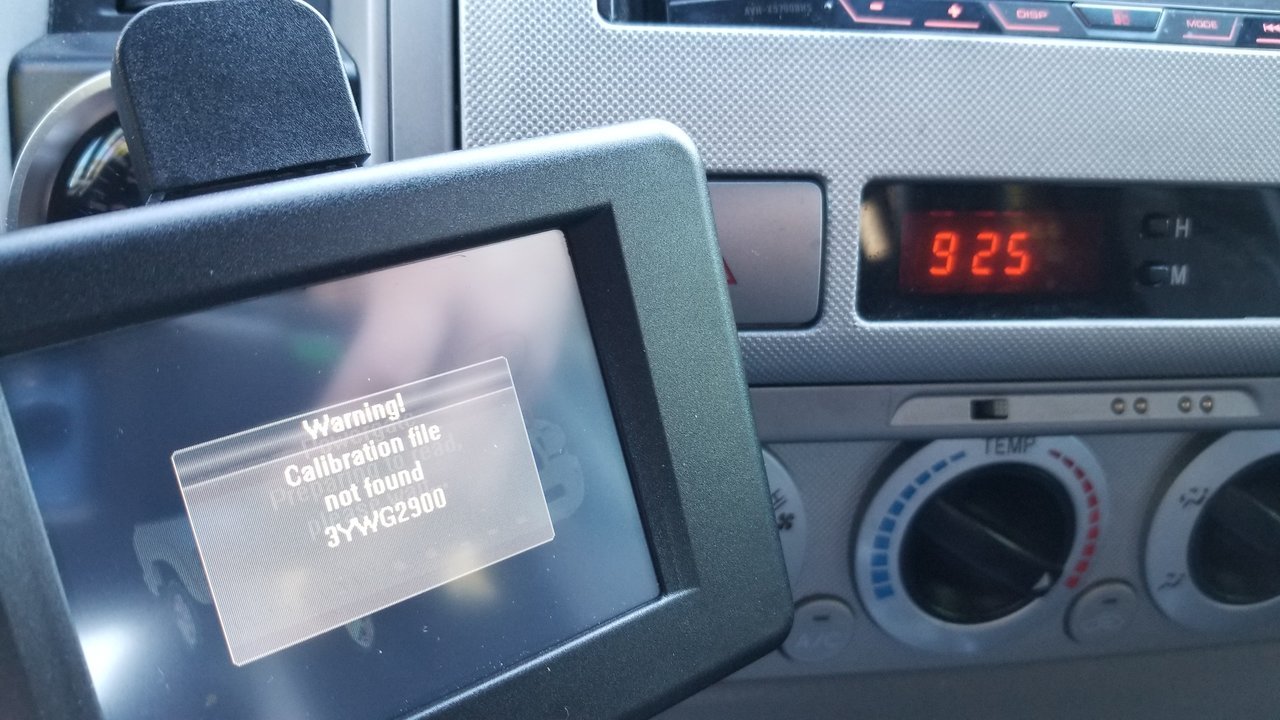

  6. Mar 5, 2018 at 9:36 AM
    #1926
    SUMOTNK
    SUMOTNK Pavement Pounder / Mall Crawler
    Sep 8, 2014
    #137895
    3,071
    Eddie
    NorCal/South Bay Area
    Looks like a Gen2.5 TRD Sport, but really an '08 TRD OffRoad
    TRD Supercharged / OTT Tuned
    Thanks Tor, but nope... my Internet connectivity looks good. The handheld is able to communicate to the repository and grab "new" protocol and data files. The latest FW on my handheld is V1.50.
    @OVTune
    The error still exists. ECU 3YWG2900 is still not found. Here are my steps:
    1. Plug in handheld to my laptop.
    2. Launch OVTuning software. Software identifies my handheld.
    (It does it's automated thing. Downloads files, etc...)
    3a. OVT software finishes updating
    3b. Take my handheld to my truck.
    4. Plug the obd2 plug into the odb2 port. Plug the other end into the handheld tuner.
    5. Handheld powers up. Then I turn my key so my truck is powered on (engine is NOT running)
    6. I follow the instuctions (Setup, vehicle, engine, etc)
    7. Says stock ECU file is not found. I hit OK/continue so it Attempts to pull the stock ECU file.
    8. Errors out with ECU calibration file not found. 3YWG2900
    This was performed at 0925am (Pacific) Mar 5th.

  12. Mar 5, 2018 at 11:15 AM
    #1932
    OVTune
    OVTune [OP] Well-Known Member
    Mar 27, 2017
    #214557
    8,112
    OVTune
    will have this in soon
    will resubmit YWG2900

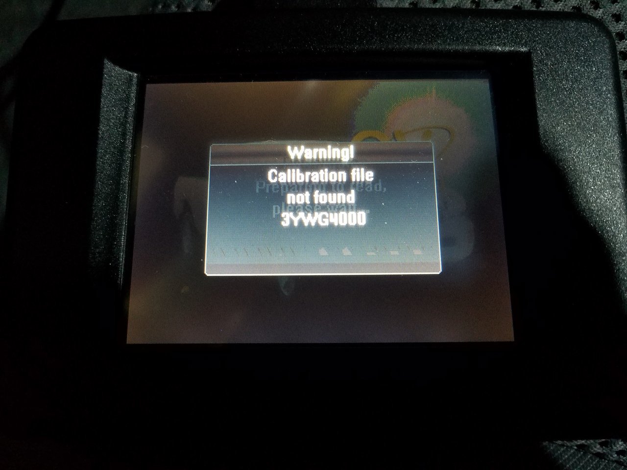

  17. Mar 5, 2018 at 8:37 PM
    #1937
    Norton
    Norton Senior Member
    Mar 10, 2011
    #52729
    4,667
    Steve
    Colorado Springs, CO
    2013 Access Cab 4x4 V6 6MT, TRD OR & Tow Packages
    Magnuson S/C w/12TRDTacoma's Qwikchange Hub & 2.5" RIP-Modded Pulley, Roostfactor's Pulley Wrap Mod; FPR Mod; JustDSM Tune via HPT MPVI2; mightytacoman Intercooler Tank; aFe POWER Magnum FLOW Pro DRY S Air Filter; OME Suspension Lift (885 Coils, Dakar Leafs, NitroCharger Sports); TRD Quickshifter w/TRD 6-Spd Knob; TRD Exhaust; NSB-AGM27F Battery w/HKB Adjustable Voltage Booster & Coupe's TRD Battery Hold Down; Goodridge SS Brake Lines; Trident904's MT ADM; BFG All-Terrain T/A KO2s on FJ SE Anthracite Rims; N-Fab 6-Step Nerf Bars; BPF TRD Skid, Tow Hook, & Cooling Panel; jsi's Locker Anytime, Up2NoGood's 2Lo Module; ramonortiz55's Always on Power Outlet Relay, ND4's Fog Light Anytime, & Crom's Speed Bleeder Mods; crashnburn80's Ultimate Headlight & Fog Light Upgrades; ThreatLevelMidnight's Wireless Charger; 4Runner 4X4 & FJ Fog Light Switches; redtaco2007-inspired LED License Plate Lights; AudioControl LC2i LOC, JL Audio XD200/2v2 Amp, Focal PS165V1 Spkrs, Sound Ordnance B-8PTD Sub, Hushmat & Noico Sound Insulation; loginfailed-inspired Speedhut Boost & AFR Gauges in a Lotek Pillar Pod; Ltd Auto-Dim/Compass/Temp/Backup Camera/Homelink mirror on ImMrYo's Mirror Lift Bracket; TacomaBeast Glove Box & Console Organizers; Husky Floor Liners; UltraGauge EM; mesojdm's Ultimate LED Dome & Map Lights & GASSHOLE; Redline Tuning QuickLIFT Elite; Mobtown Offroad Locking Bed Storage Doors; Toyota Bed Mat; Cali Raised Led Bed Stiffeners; Pop & Lock Power Tailgate Lock w/TacomaTruckParts Support Bracket; ARE Z-Series Cap, SolarGard Tint; BlendMounted & MirrorTapped Uniden R3; CravenSpeed Stubby Antenna; Amsoil Lubricants; Adam's Detailing Supplies
    +1 to all of this. Followed same procedure as SUMOTNK (via cellular hot spot) at about 2130 MST. Still awaiting initial upload for 3YWG4000.
