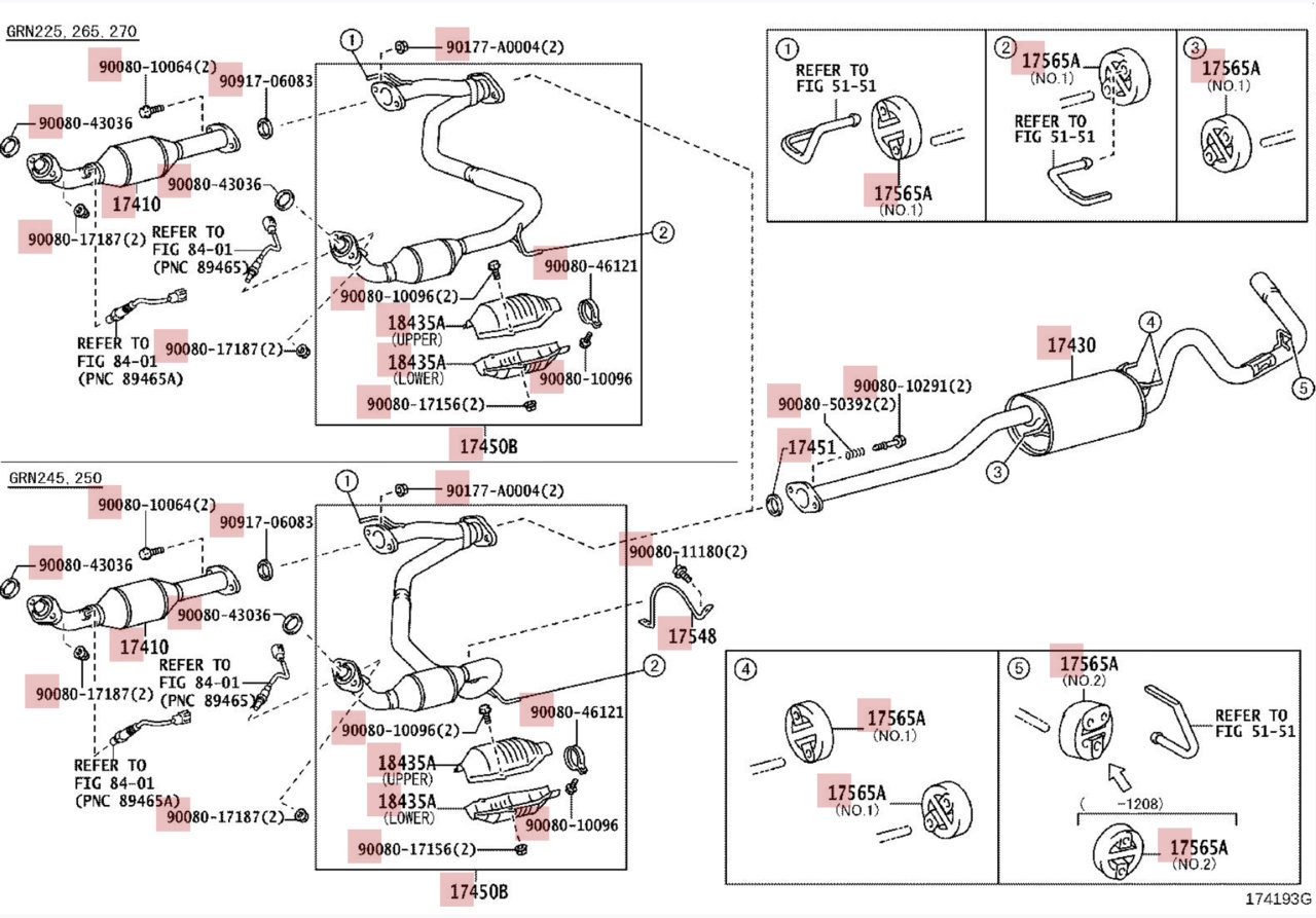

    Went to replace exhaust, but have rounded the head on one bolt. Does anyone know the correct part number?
    Toyota parts diagram says “90080 10291 exhaust manifold bolt and spring” but mine definitely did not have a spring. It was just threads.
    Hoping a stainless version may be available.

    I’ve found part number 90080 10064 for older Tacoma’s which at least looks more correct from online pictures but I can’t find any reference to it being correct for the 2017.

    90105-A0369 or 90105A0369
    M10 x1.25 x 35mm
